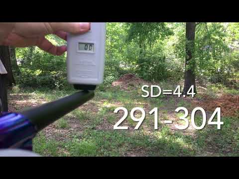

    I did a thing today.
    I had just recently finished working on a project for a client, but I was disappointed about the FPS consistency over my chrono. I was getting numbers everywhere from 238-306. After complaining about it on the Facebook Automag group, both Jake and James suggested that it could be the paint, which I didn't really believe.....but I had the time today, so why not test it?

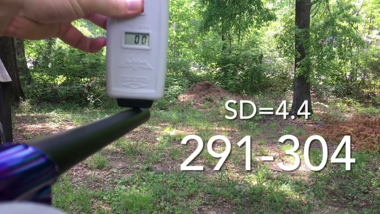

    First test was the gun (a ULE Automag) with a Freak barrel (0.682 insert) and Valken Graffiti paint. I was intentionally sloppy with the trigger (sometimes pulling fast and sometimes slow), and I didn't match the paint to the barrel. I just grabbed a handful out of the bag and shot it.
    For test #2, I kept everything the same except for the paint and the trigger discipline. I pulled out about a dozen good paintball matches for the barrel, and I always pulled the trigger with a quick, crisp action.
    The difference was really night and day. I couldn't believe it. I mean, it's not like I thought you all were lying when you said that paint/barrel matching was important. I believed it made a difference. I just didn't think it made that MUCH of a difference. But now I might have to start doing this more often.

          That's a really good point. All this paint came from the same bag, and I was using calipers to test them, and I was getting anywhere from 670-686. In the same bag. Some of the balls were also egg-shaped, so the same ball could measure 684 one way and then measure 678 another way. And this was Valken Graffiti. Not the best paint in the world, but certainly not the worst either.
          So does this test prove something? Sure. But how practical is this knowledge? Well, to really use it to my advantage, I'd have to test EVERY ball in the bag and put them into a few different piles. Then I'd have to shoot all the 680-684 paint for one game, then change the barrel sleeve and switch to the 676-680 paint for the next game, and so on.
          So yes, if ALL the paintballs in a bag were actually the same size, then this is useful. But if not....well...I'll probably just stick to overboring with my 688 Dye Ultralite. It works fine, and everyone else at the field is shooting the same crappy paint that I am, so we'll all at the same disadvantage.

              consistency ≠ accuracy
              Appiled specifically to automags, I still believe tom Kaye’s tests were the best so far - one conclusion was overnoring is more accurate.
              First clip was in sun, second in shade.
              Gun not in vice in between tests.
              no trigger control test on one
              I do not see a clear determination on the results.
              Pls re-test.
              edit: with freaks pls check the insert is centered on the orings. If it is not, one insert vs another can send the ball bouncing off the tip.
                -Consistency is very much a component of accuracy.
                Obviously, a ball travelling at 200 FPS is going to hit in a very different spot than one travelling at 300 FPS. In exactly the same way, one going 275 is going to land- all else being precisely equal- in a slightly different spot than 295.
                Appiled specifically to automags, I still believe tom Kaye’s tests were the best so far - one conclusion was over{b}oring is more accurate.
                -Kaye did excellent work back in the day, but that test was with his one specific kind of marker (and pre-level-10) and a limited range of bore sizes. (Only three or four, as I recall, and all one-piece barrels.)
                The point I was trying to make in my earlier post is, essentially, there's no perfect combination. Some markers with certain paints, might work better slightly underbored. Others prefer overbored. I've been to the field, swapped guns between games, and noticed a slight but definite difference, despite still using the same barrel, with the same paint, under the same conditions.
                -Freak inserts can't NOT be centered in the O-rings. There is nothing to push an insert off to the side, and in all the years I've been using Freaks, I've never seen an insert bored off-center. Really, with the walls so thin, how far off center could they be?
                In any case, in both the classic and XLs, the insert fits into a machined feature in the tip- I've never seen one made so badly the insert could be mounted eccentrically.
                That doesn't preclude actual damage to the insert or elsewhere, but even that is generally pretty visible and obvious.
                Doc.
                Paintball in the Movies!
                • latches109
                  Always Sciencing
                  • 2092
                  We can accelerate a ball to 295fps with NO barrel.. what would happen?
                  My reference to Tom's test was a comparison to the testing methods. Hand held with many variable vs normalized variables and high speed cameras.
                  Doc.
                  I am not referencing milling. Strictly the orings in the tip, and the two in the back.
                  Put an insert in ~1/3 of the way in so it clears the 1st oring, wiggle it - that is the quantity of play available.
                  Freak inserts can be centered in the orings. Todd Martinez was the one who showed me this- way back. Put an insert in and look down the front of the barrel, you will see how it is centered in the back. He would spin the insert, take it in and out a few times until the insert was centered. Lot of the pros did this, because the tournament paint was sooo brittle that any bounce in the tip it would beak. This technique would reduce those breaks. I have 7 freak kits here two old style milling, two xl and the rest newer milling style. I can replicate on all of them.
                  what is funny is I didn't even stage this shot, I literally picked up the first freak barrel I saw and looked. not centered
                  Same barrel same insert, you can see the same paint smudge - took it in and out a few times and spun it until "centered" better
