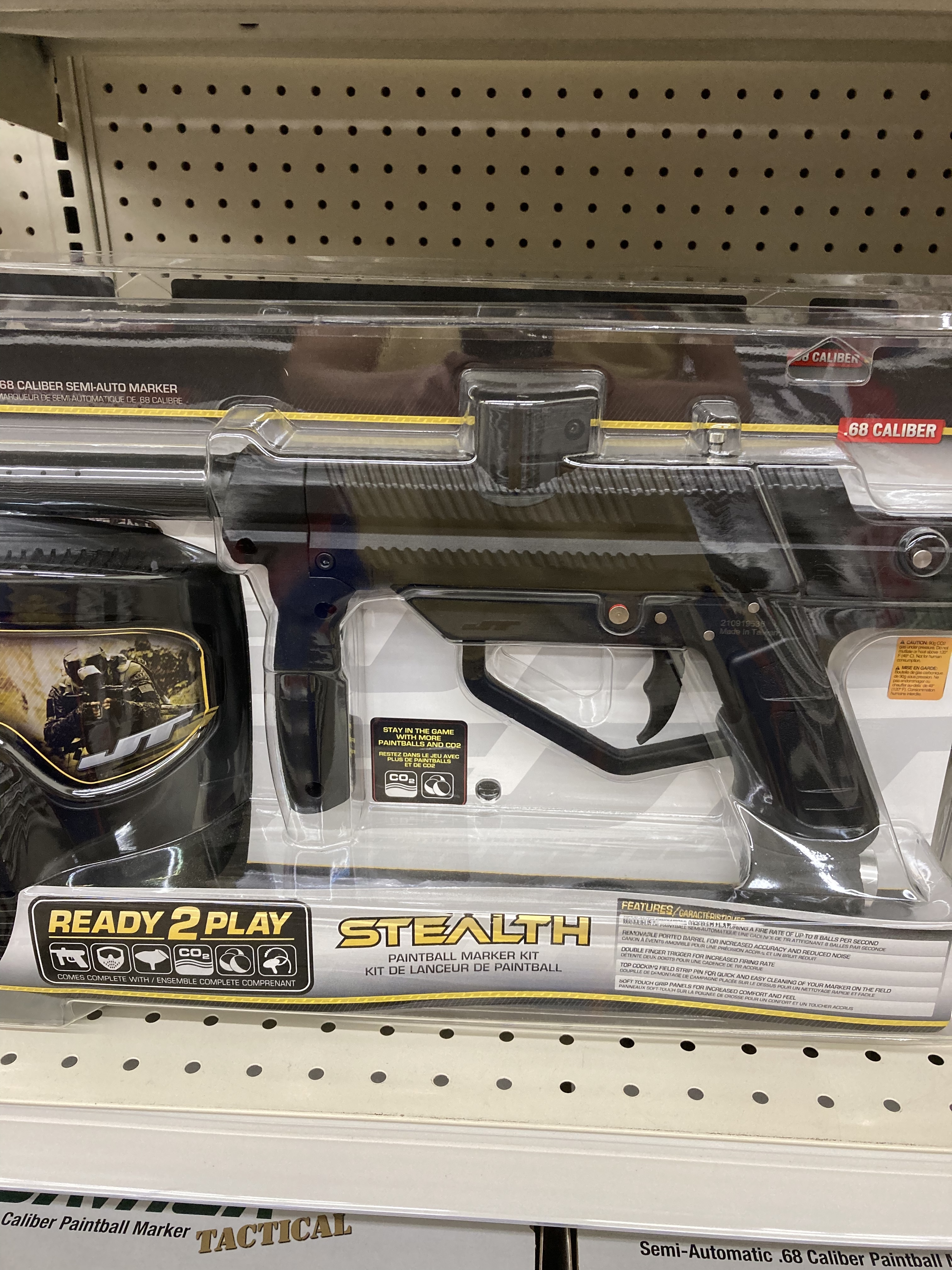

A few at the local Fleet Farm.
Sorry. Saw them and I had to take a picture & necropost.
