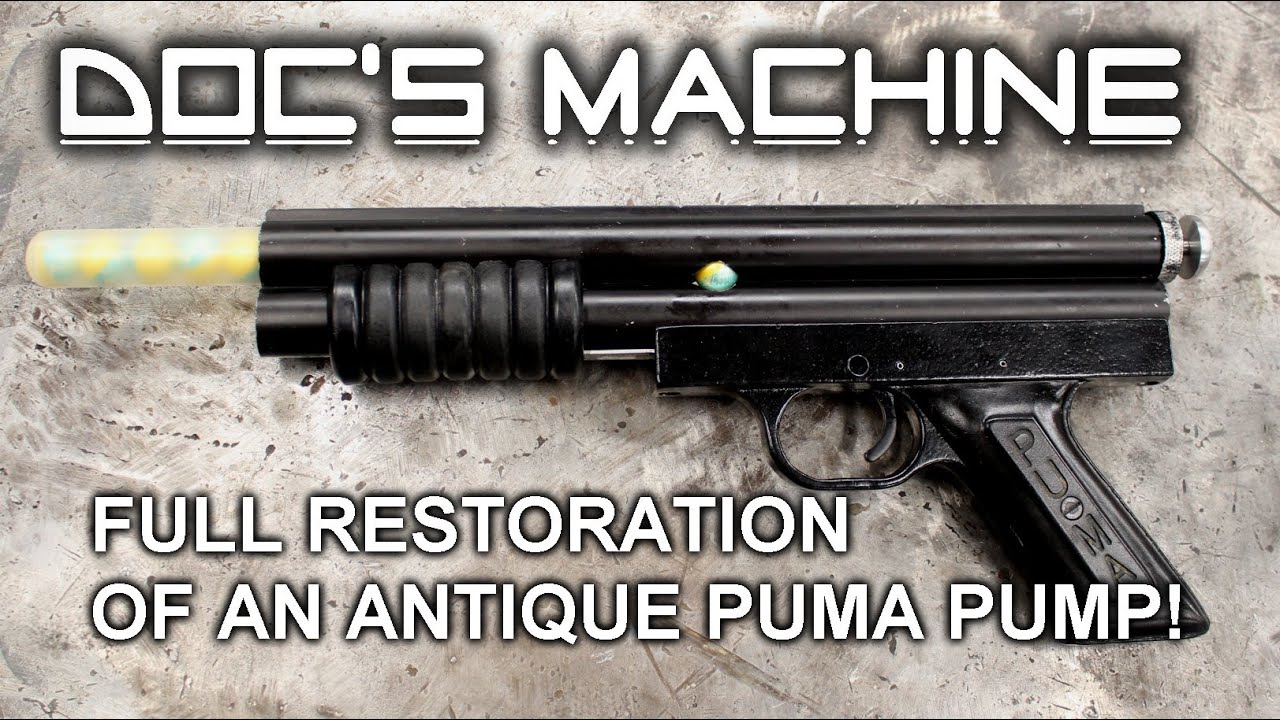

                And done! My biggest and best video yet!
                The complete restoration of a Puma, from a box of junk to shooting paint! In addition to the two I had, I was lucky enough to find a third on eBay that had the all-important CO2 plug.
                Had to make some parts and a couple tools, and I'll still need to make a second CO2 plug to get 'em both fully running, but they're done! I'd love to take one of these out in a pump game, if I could find enough people to put a pump game together.
                Give it a watch, pass it around if you can, and let me know what you think!

                  Loved watching this!
                • Drunkscriblerian
                  Drunkscriblerian commented
                  That was awesome! I love how you took the time to show us the *whole* process, which very much communicates just how much work went into the restoration. Also gotta say; that "push to charge" feature on the C02 system was pretty innovative. Its a pity the rest of the system was so wasteful.
                  I wonder if there's a way to hybridize that feature with a Sheridan or Nelson-style valve...
