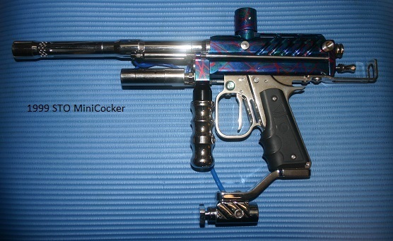

            You can always pick up a cheap cocker, that has the basics that you need, and then replace the parts you don't want, with those that you do.
            By the time you are finished you will know the gun inside, and out.

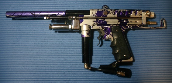

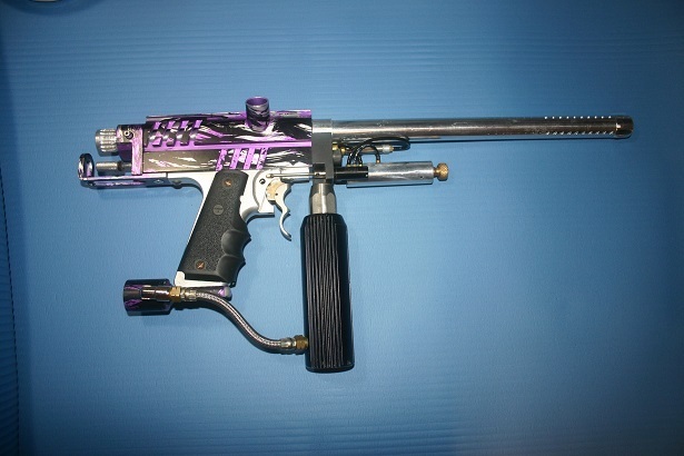

            99 STO Minicocker, bought it like this (which gave me a lot of the parts I wanted):
            Click image for larger version  Name:	s-l1600.jpg Views:	3 Size:	175.1 KB ID:	399746
            Ended like this:
            Click image for larger version  Name:	99_sto_mini.JPG Views:	3 Size:	85.2 KB ID:	399747

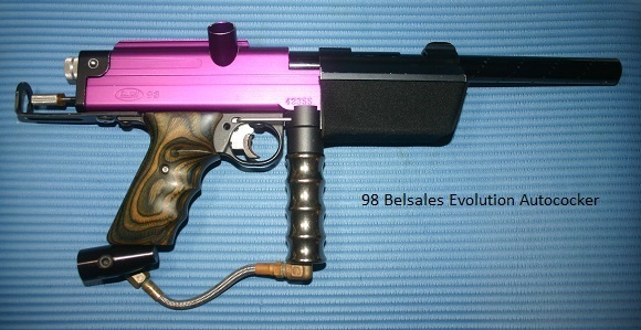

            98 Evolution, started like this:
            Click image for larger version  Name:	image_49485.jpg Views:	3 Size:	110.7 KB ID:	399748
            Ended like this:
            Click image for larger version  Name:	98_Evolution.JPG Views:	3 Size:	77.4 KB ID:	399749
            Walkers Current Feedback
            • CrowsFeast
              CrowsFeast commented
              I find it entertaining that in one case you added a drop and in the other you removed the drop.
            • Walker
              Walker commented
              I'm glad I could entertain you.... I bought it with the Gladiator reg and the drop, which would not have been around when the Evo was originally sold. I then added an ergo reg, and no drop since I didn't have one that matched properly. I also replaced the frame with the cut trigger guard, with an intact one, added the correct beavertail, and was lucky enough to find an Evo shroud. In addition to that, I replaced the pneumatics with ones from the correct time frame. Along with that I used the correct valve, cocking rod, and SP AA barrel. I now have a 98 Belsales Evolution Autococker.

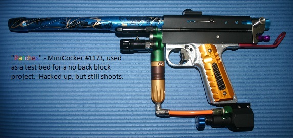

              Is it worth it? For me; Yes... I have several cockers that are not cookie cutter.
Name:	95 Cocker.JPG
