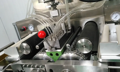

                Who wants to put their money where their mouth is? You can tell I haven't won the lottery because I haven't already done this.

                  iamthelazerviking commented
                  Let's all pitch in. MCB branded paint.

                  Oh man, to be able to shoot fresh, round, large caliber balls and support our forum. SHUT UP AND TAKE MY MONEY!

                I would not participate in an alibaba sourced paint run. However, I seem to recall that Nelson would still do custom batches of paintballs after they halted their paintball line. I'd absolutely participate in a custom batch of premium quality paint from Nelson - extra so if we get a silver pearleascent shell with non-staining pink filling. (i.e. Nelson Anarchy Upheaval, just without the staining people complained about with pink filling [which I'm not certain was Nelson - could have been other brands])
                Someone needs to be there for the setup of the equipment to verify certain quality metrics. I volunteer. See the link in my signature.

                I have friends in the industry who could definitely help get someone started. But there is a lot more to it than just getting the machine to make them.
                1. Gelatin mixing machine: This machine is used to mix the gelatin and other materials that form the outer shell of the paintball. The machine heats the gelatin and other ingredients to a specific temperature and then mixes them to create a consistent solution.
                2. Gelatin extruder: This machine extrudes the gelatin mixture into long tubes, which are then cut into small spheres by a cutter.
                3. Filling machine: This machine is used to fill the paintballs with paint or other fill materials. The machine uses a piston system to fill the paintballs with a consistent amount of fill material.
                4. Drying machine: After the paintballs are filled, they need to be dried to ensure that the gelatin shell hardens. A drying machine is used to dry the paintballs at a specific temperature and humidity level.
                5. Sorting machine: Once the paintballs are dried, a sorting machine is used to separate any broken or misshapen paintballs from the batch. This ensures that only high-quality paintballs are packaged and sold.

                  I was bored at some point and I think I priced out #1-#3 at about $85k. From the videos I watched they seem to use drying rooms like industrial Powder Coaters use (but at lower temperatures), so I assumed that's built on site by a specialty company.
                  Yeah I’m thinking $150k minimum to dip your toes into the paint making business.
