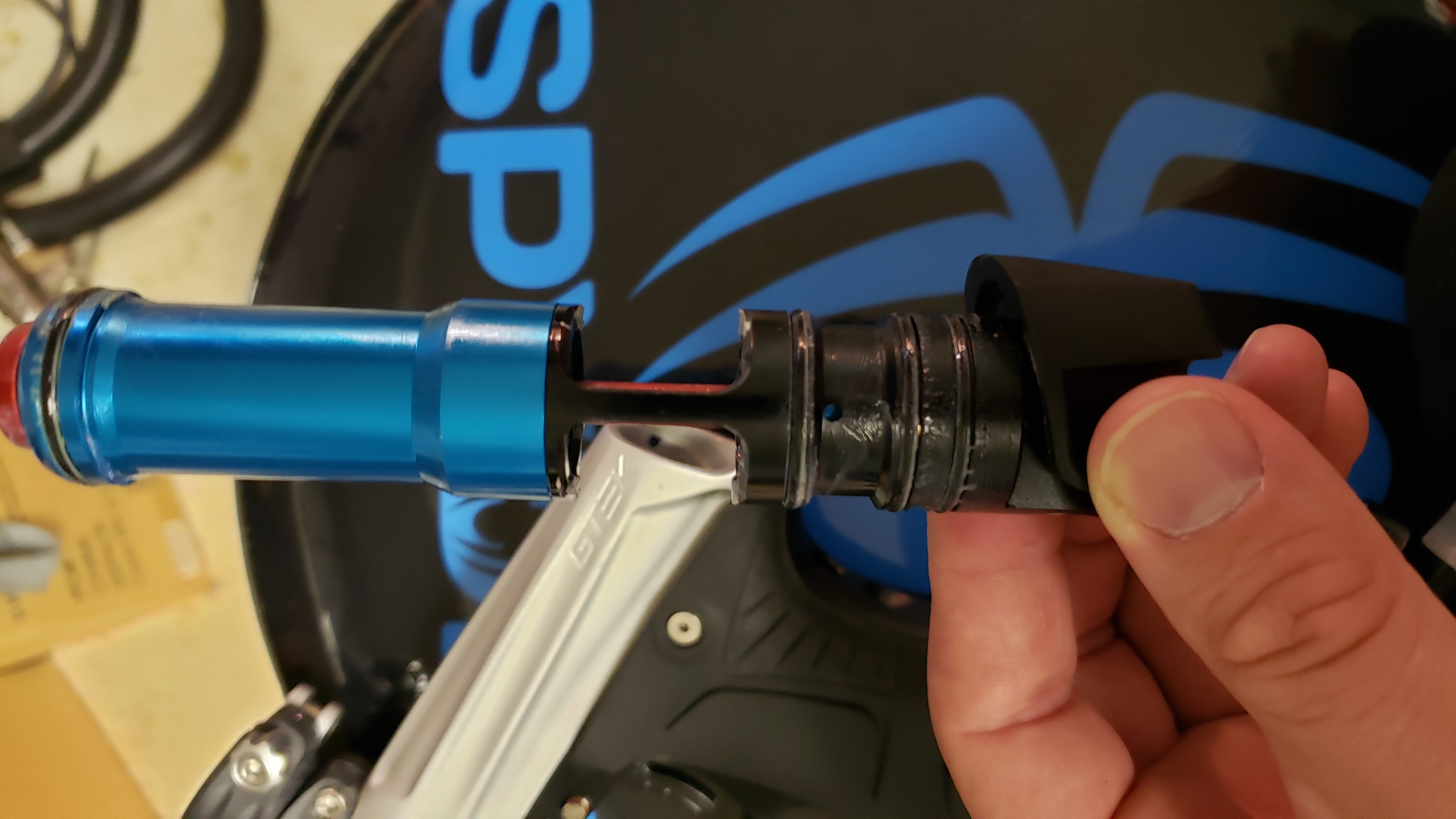

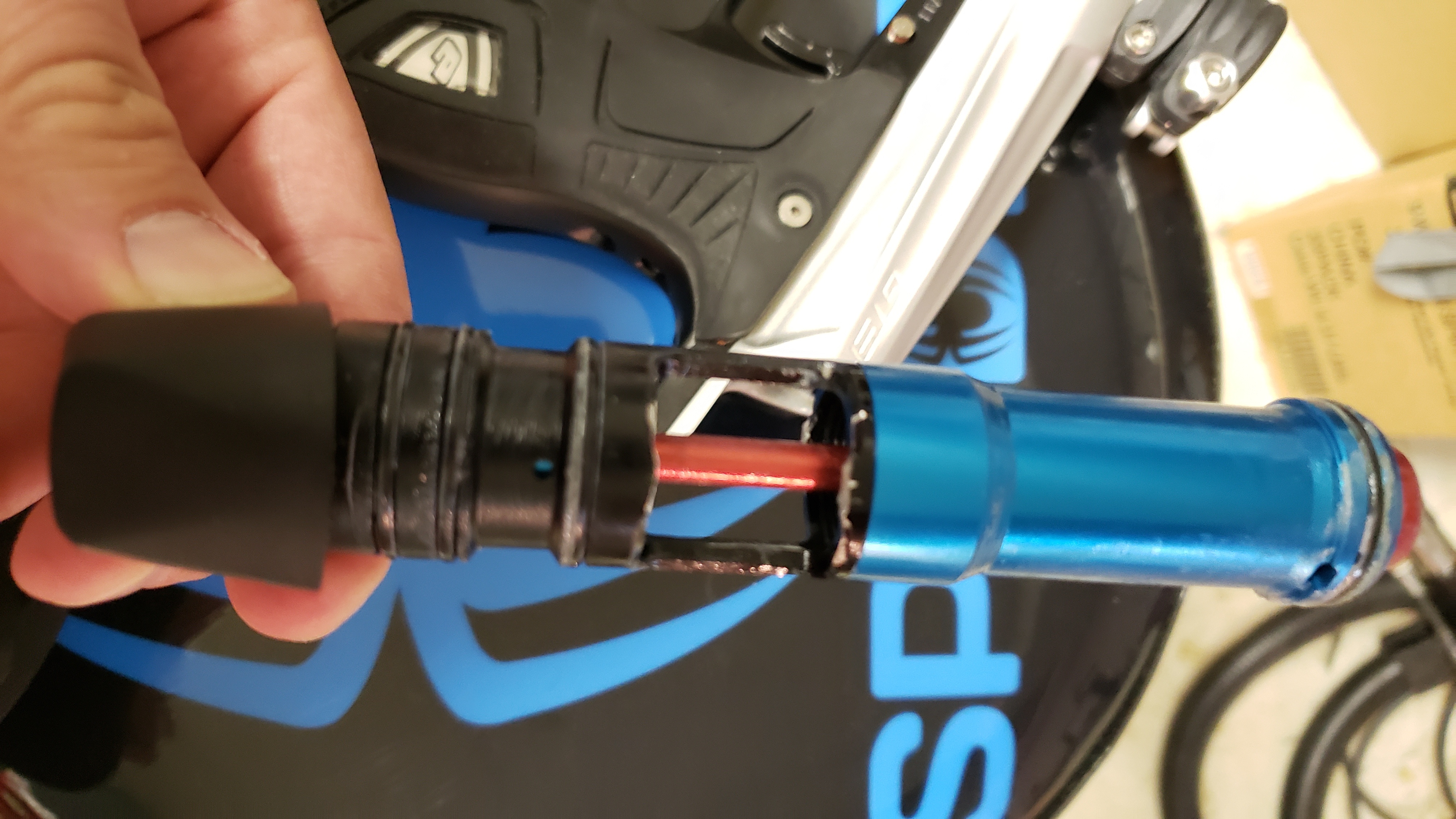

    pretty sure the lp mod was just cutting off 2 of the can tabs on the bolt.

      Two "legs" on the back of the bolt are removed - you'll see where if you pop the bolt out - thereby increasing the can volume and decreasing the OP. It helps with efficiency as well, according to Stanchy.
        Jordan and superman are correct. You just cut off two of the supports for the dump chamber. According to Stanchy, it's supposed to drop the operating pressure by 15%, and likewise the trigger pull weight by 15%. But, you'd think that would be across the board.

                I agree. Mine came like this, and it's obviously a Dremel job. The only benefit I can think of is the lower pressure allows the air to vent quicker, allowing for lower dwell since the spring doesn't need to overcome the higher pressure.
