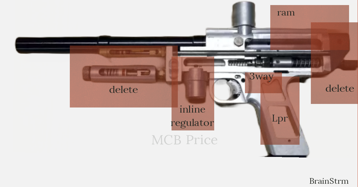

    Getting rid of the front block...
    Autocockers are a lot of fun to build but it feels like the code is still uncracked (exclude nummech) Adobe_Express_20230918_2211160_1.png
    I see room for reengineering and such that make believe that it was done to be reliable and save cost but what if it would be possible to retrofit a 2.0 vision the Andy way,
    With more integrated placement weight cut and efficient auto. What if.. it was possible to clean the codeAdobe_Express_20230918_2222550_1.png

    Whoa. I like where this is going.
    • Hobbes
      dodgy
      • 1258
      • NH
      Maybe we could call it a Blazer.
        • 6253
        This was my thought exactly as I was reading this
        Also that "wasted space" in front of the valve, if you remove that you can have lots of problems regarding velocity. I worked on a minied cocker with a mq2 that physically would not shoot above 260 because there simply wasn't enough air ready to go in front of the valve.

          Something tells me that external pneumatics decorating the build, watching the back block moving back and forth, and the solid feeling metallic chunkiness is almost the entire appeal of Autocockers at this point. See the rising popularity of full body and slab side builds. It all stopped being about performance, weight, and cost a loooong time ago. Plus, you get to pick what color the microline is! That’s not to say there isn’t someone looking for this sort of thing. There’s always a few folks at the car show determined to shave and hide every last bit of mechanical stuff for the sake of cleanliness or weight.

            Autococker are coolness in all pieces but I personally prefer the pump look modern and simple, still want pneus but not in front I feel the whole front block can fit in the frame
          • Ego10Baller
            Ego10Baller commented
            Morgenstern Yeah the way the autococker is set up is why I like it. Easy to service and tune. If you start making everything internal and eliminating the moving parts and external adjustability, might as well just run a more modern mech like an Emek or an LV where you have the bolt visibly moving back and forth.

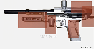

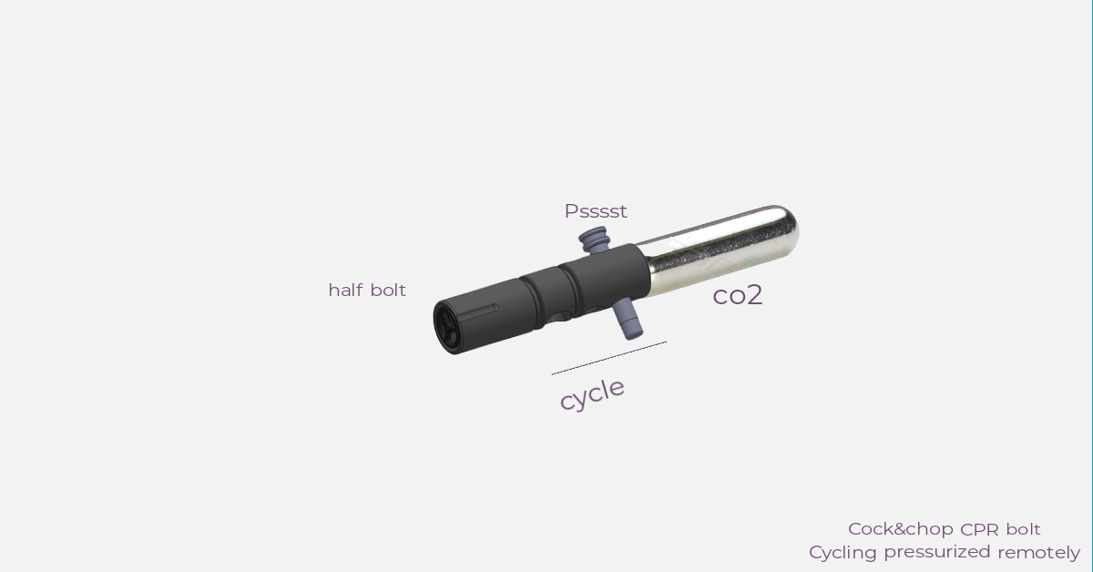

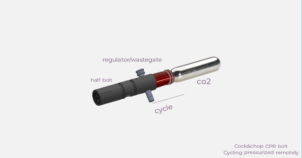

          How about a self cycling pump! gestimate is 2krounds

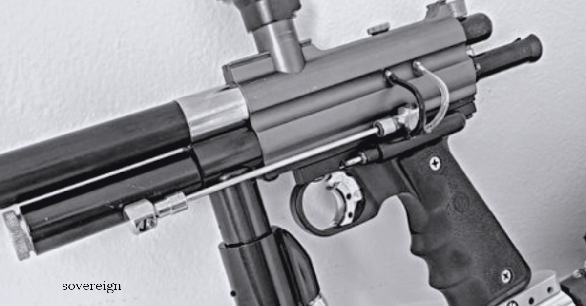

            To me, autococker 2.0 would be a combination of a few odd cockers. Integrated front block like the trilogy, manifold system from the SR, internal ram like the Powerlyte Hybrid, gas thru frame like the nummech, and a midblocked body.
            • Price
              Price commented
            • 4381
            The sovereign did a lot of this but failed to become as popular
            • Price
              Price commented
              Had to take a look..definitively hit hard thanks for the input
            That was my first thought too 👍
            Autococker 2.0 = sovereign

            Picture of a sovereign
            • maggot
              • 497
              Brad Nestle reverse minicocker

                R&d
                Do the deadlywind valve can replace the 3way? Raise your hand.
                The hpa air can be routed from the asa without affecting the regulated vasa supply all front block can be relocated to the frame.
                Motivation quote: If nummech would have done it.., how?
                Parts delete list
                front block
                cocking rod
                ram rod
                3way rod
                backblock
                ram body
                The ram can actuate an automag sear looking plate on a pivot to slide in a groove located next to the actual sear and actuate the hammer directly, a groove is added to the hammer to connect.
                nb. by having a pivot the.lenght of the ram can be reduced. Ram is now fusioned into the spine of the frame

                  • 6253
                  Nothing is moving the bolt now.
                  Also, go do it
                  Also also, it sure is easy to fit everything in that frame when you scale all the parts down in Photoshop. Good luck making that all fit and maintain any kind of structural rigidity in real life though.
                  Even if somehow you managed to somehow make this work, I wouldn't buy one, can you imagine trying to do any work on any of the stuff in that frame? No thanks

                    bolt is midblocked in this setup, it retract on spring?
                    Ecapnation commented
                    You'll have blowback with out means of holding a bolt in place.
