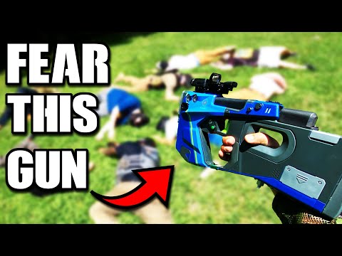

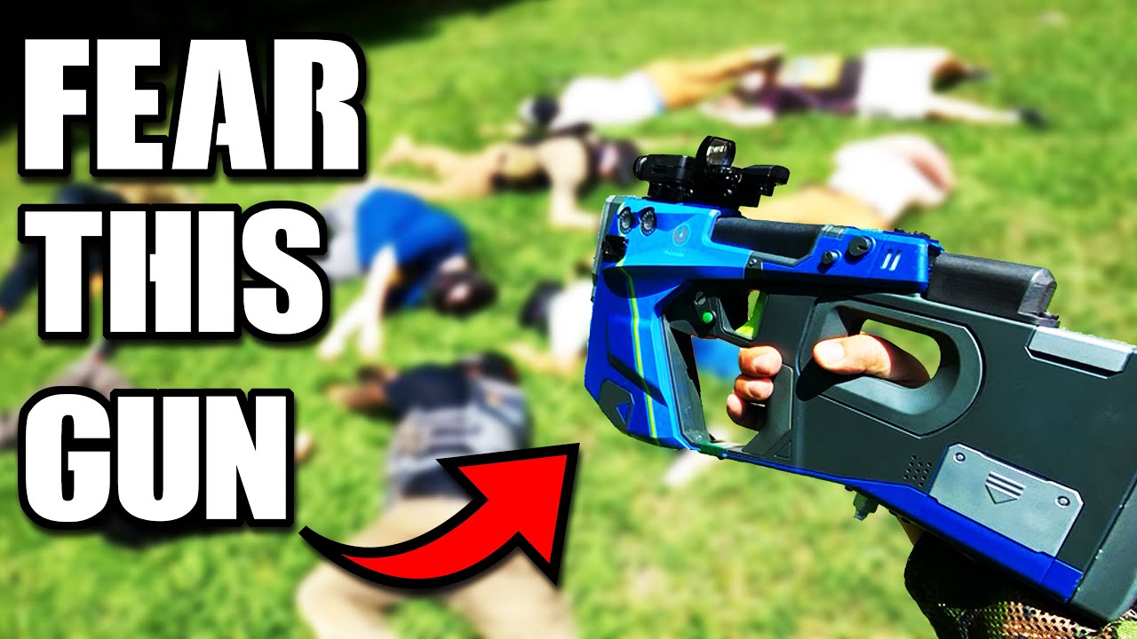

                          I found this really good vid ,where the shooter is using something very custom and non-Larpy, in the spirit of what we were discussing above. It sounds like the Customizer dropped in one of those HPA engine kits mentioned above. The performance is something else!
                          it must be driving the other Airsoft players nuts ,that his gun doesn’t look like a replica !
