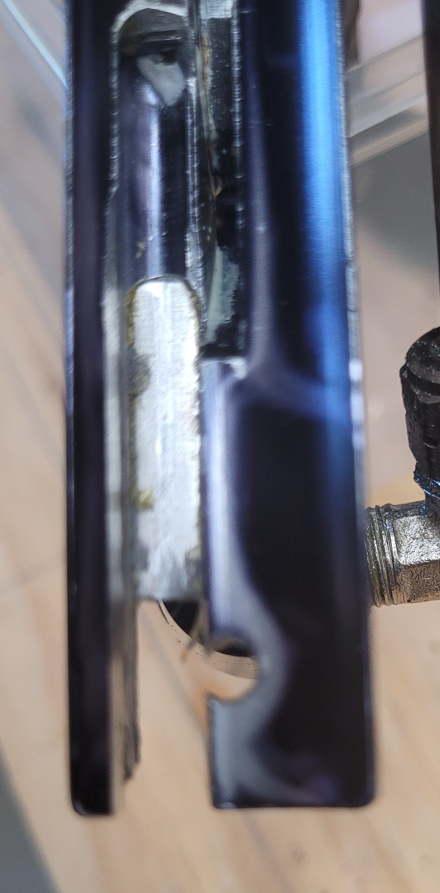

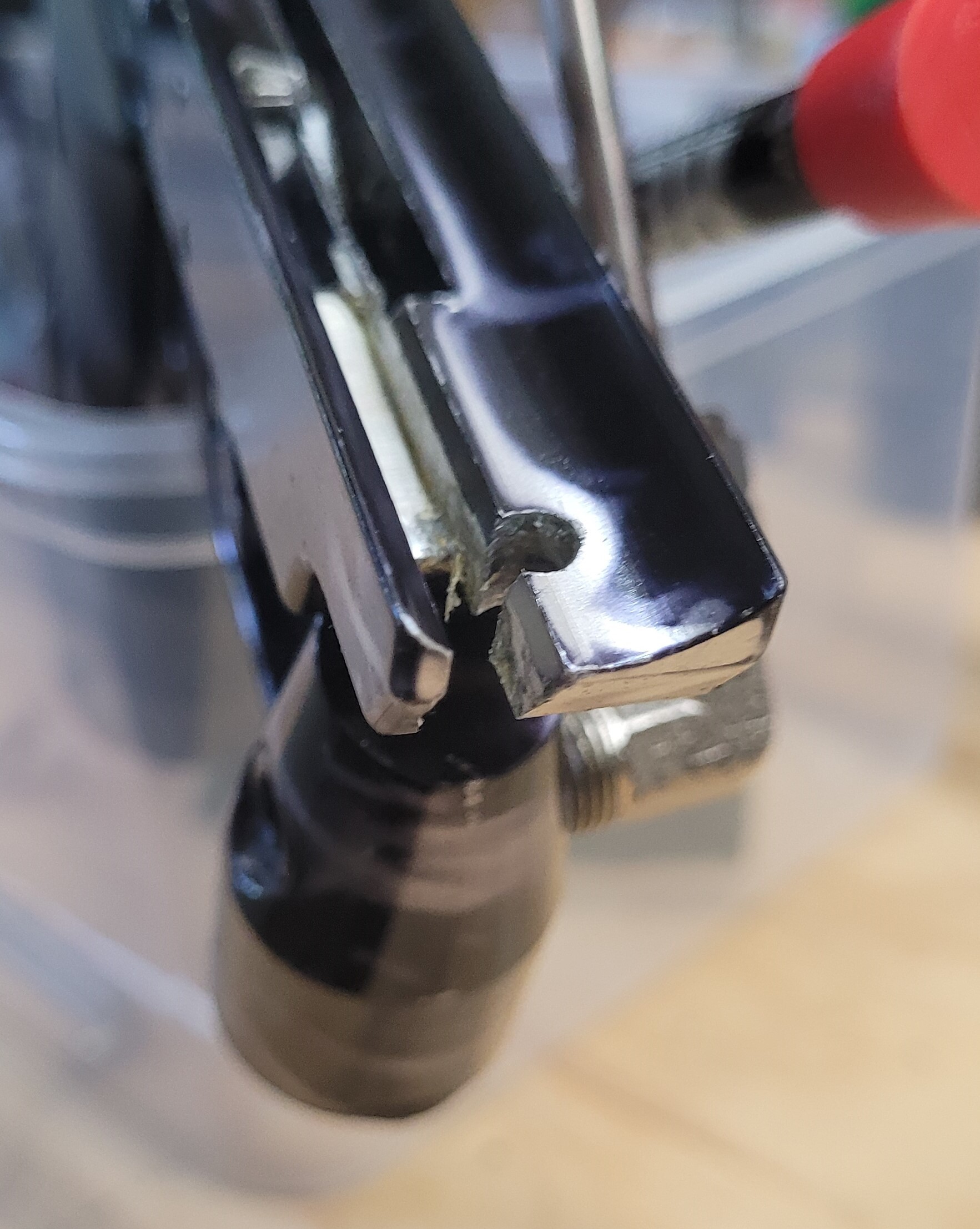

    Oh and here are some images of the milling work done on the Trigger Frame at the pump slot that I need to figure out how to fix without damaging the rest of the anodization:

        Jb weld a brass shim in then notch the top so I the rods removable. It will ride on the brass. Probably your easiest solution.
      • Grendel
        Grendel commented
        I think that is basically the route I am going to go. I'll use some thin wall brass tubing I have that is the right diameter for a typical pump arm shim and cast it in place. Thankfully I just bought Epoxy masking and casting wax so I can use the actual pump arm, shim stock and assemble the frame to the body as part of the mold the fill the gap from the end. I think I will just fill the front bolt hole as well then just re-drill it. I found a couple of aluminum filled epoxies so just need to make a decision there. I can always open up the top of the pump shim once the repair is fully cured just enough to get the pump arm out.
