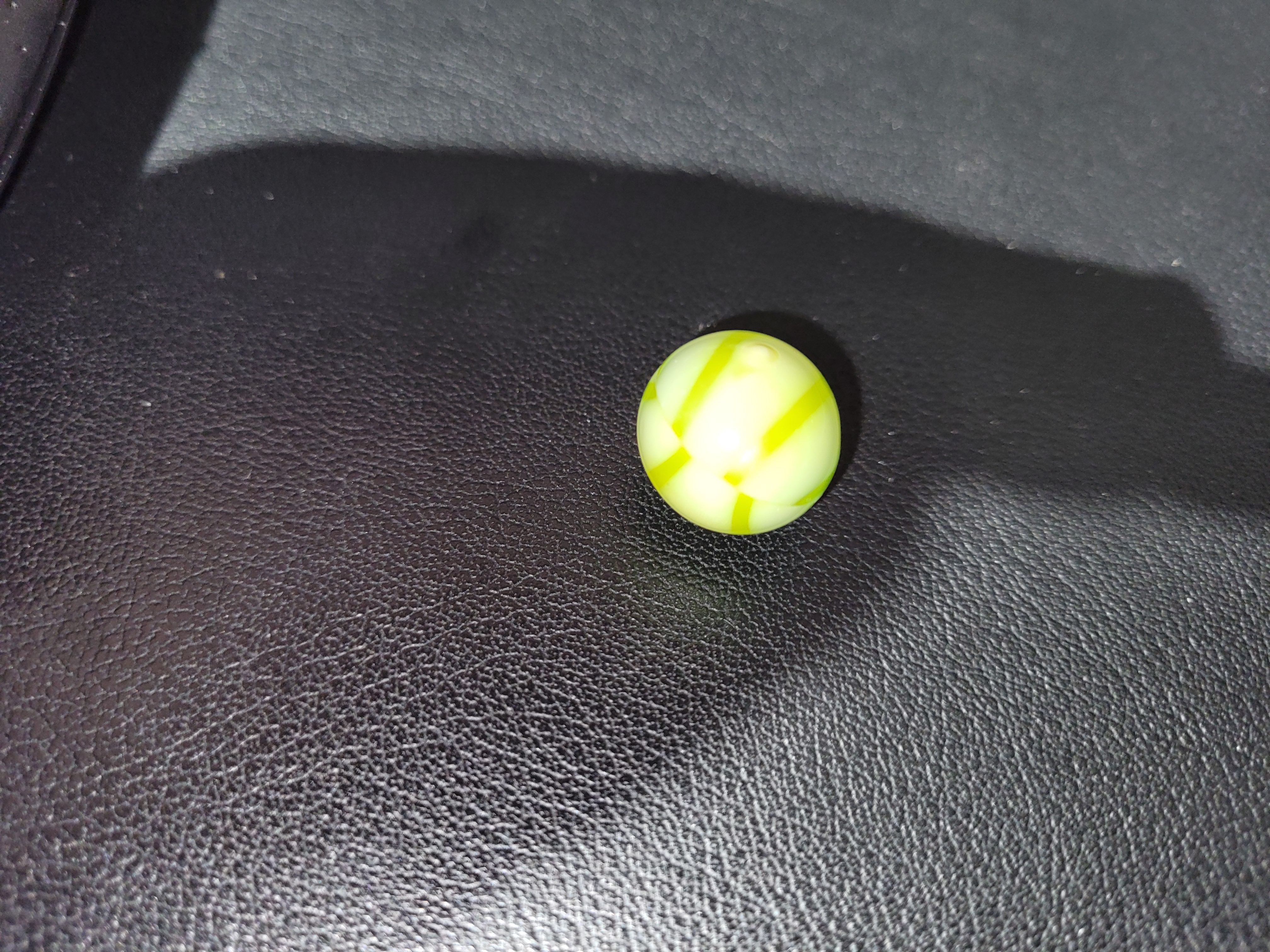

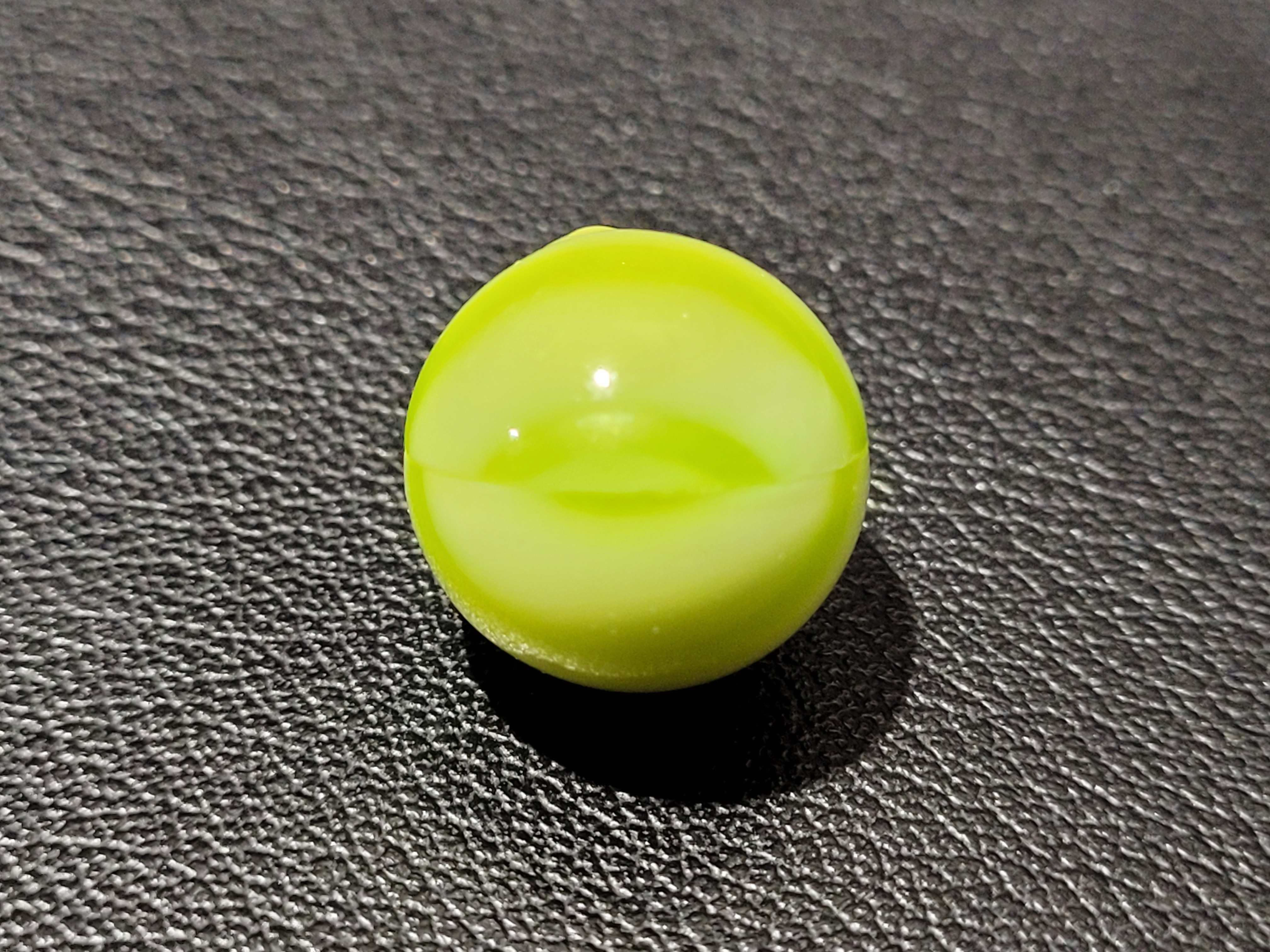

          Here are the results of my measurement session.
          I took 10 samples out of my paint jug and took measurements on the seam and opposite of the seam.
          I also found one that appears to have a wart or zit on it.
          Did not measure on that, but it would certainly affect the flight of that ball.
          My measurements seem to confirm that the paint is small and egg shaped.
          Wish I still had access to the optical comparator from a previous job.
          It would really show the profile of the shell well.

            Thats so small, I bet you would have issues with stack clipping and roll back. More barrel breaks too I bet.
            • PBGunny
              PBGunny commented
              Lots of barrel breaks and confetti just past the barrel. I had a .675 insert I maybe should have used, but it was so egg shaped, I thought it would cause more issues. I may just leave it sit out and see if I can get it to swell a bit. Sometimes that and rotating it a couple of times helps get the shape again.

            #22
            The measurements in post 23 don’t surprise me. I’ll be a broken record and say again, it’s why I use a .693 and forget about it (.689 or larger should suffice).
            I’ll measure paint and do drop tests out of curiosity, but there’s nothing I can do about the results. I measure 4 places around the seam and 4 places around the polar axes.
            In general:
            Good: .010” spread on one seam, .015” spread between both seams
            OK: .020” spread on one seam, .030” spread between both seams
            Poor: Anything greater than above
            Worst I remember is something like .635-.685”. I couldn’t hit 280fps with the Etha 3 reg maxed out with a .685” barrel at that time. The GI 3 Star I have right now is .668-.692”.
            I’d love to see more measurements like this from others with brand/model, location, and general comments about its performance.
