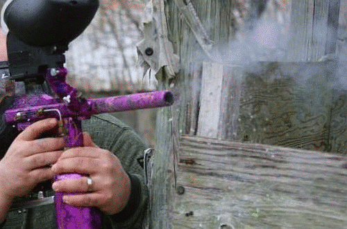

            I'm sure I was expected to pick the Montneel MegaZ. It is my favorite gun. I have a whole wall full of them that I will never sell. They are much more efficient then the tippmann on liquid co2. Much lighter, and can fire much faster. They are also super easy to strip and clean. It was a simple, elegant design. In its time, I think it was the best gun of its era, but I might not recommened one today to play with. Parts are scarce, and running without the siphon is difficult. The receiver bodies are prone to stripping, and sears to wearing out. Tippmans, even older 90s-era, are everywhere. But those are my 2 picks anyway.

              I wondered how long it would take for HP to wander in here and extol the virtues of the Mega Z lol
              But yes absolutely agreed on all points. Best guns I've run on CO2 are blowbacks. They just eat that stuff up. Oh and that purple Z is a stunner too. Viva la vertical tank!
