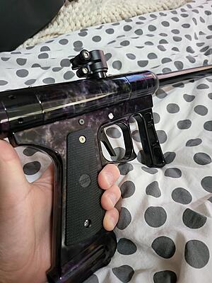

        I have in my hands one of the classic super nova in purple, fits in with my purple collection. The guy my friend picked up from could not stop raving about it, all his friends that got one and those that used his also said it was the most fun marker they used. Reliable too, was his work horse when playing(unless he decided to play pump), never had issues.
        This one has not been used in years, so likely will need complete rebuild, looking to pick up orings. Maybe I will pick up a new version too.

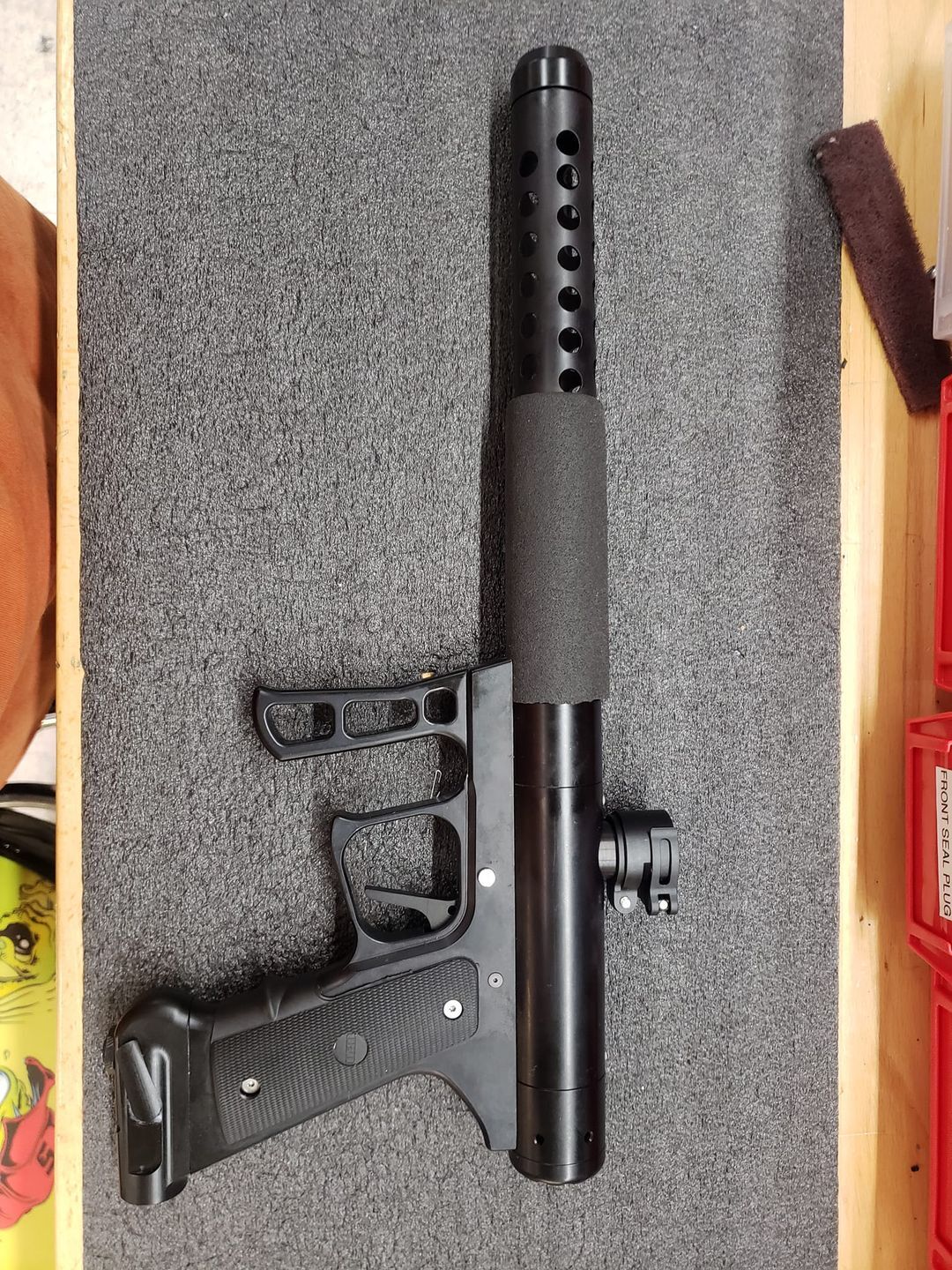

          Got my N3. Pretty neat.
          Abyss is indeed an acid wash. Black base with grey, a bit of purple and some greenish orange for a case hardened look.
          Initial thoughts;
          Some small imperfections on the body and frame, a small nick in the frame pre ano. I can see some machining marks under the ano and it came completely covered in grease and finger prints. Has a scratch or two brand new. I dont really care though, small shop is bound to have a few imperfections.
          Some of the inserts fit in the barrel both ways, most only fit in one way, and they were marked so that the identifier ends up inside the barrel. Kinda strange but not a big gripe, just odd, I'm guessing they had them arranged incorrectly in the laser machine.
          Barrel swap looks like its gonna suck, you need snap ring pliers if you want fo swap to the 14 inch. I'd like a back that can take UL fronts. This would be dope with my raincover tip.
          Comes with a pressure tester which is nice.
          Mine has a small leak from the asa bleed hole. Might be a tank oring issue.
          ASA is very tight to screw tanks to.
          asa knob is kinda thin. I'd be worried about breaking it if it wasn't fill off and I fell or something.
          Im not mad about anything though, this is a neat marker and I can't wait to shoot it.

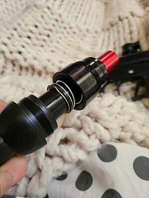

          Here's what I meant. To change the 10/12 to a 14.
          • Siress
            Siress commented
            Wait. Do you have to unscrew both of those components separately? Looks like ~6 turns each?
          • zinger565
            zinger565 commented
            Only to change to a different barrel length Siress, otherwise the entire assembly screws into the marker body
          • Bow
            Bow commented
            superman I'm only gonna change it once to the 14, but I hate Snap rings with a passion. I'd love to look into the possibility of getting a dye style back for it, mainly so I can use my preferred tips. But I think I'd have to get a weird 3 piece design for that to work judging by how this comes apart.
            Siress No, the forward section is just a delrin cover to conceal the spring and probably stop paint from getting in there. The rear section is the actual barrel threads.
