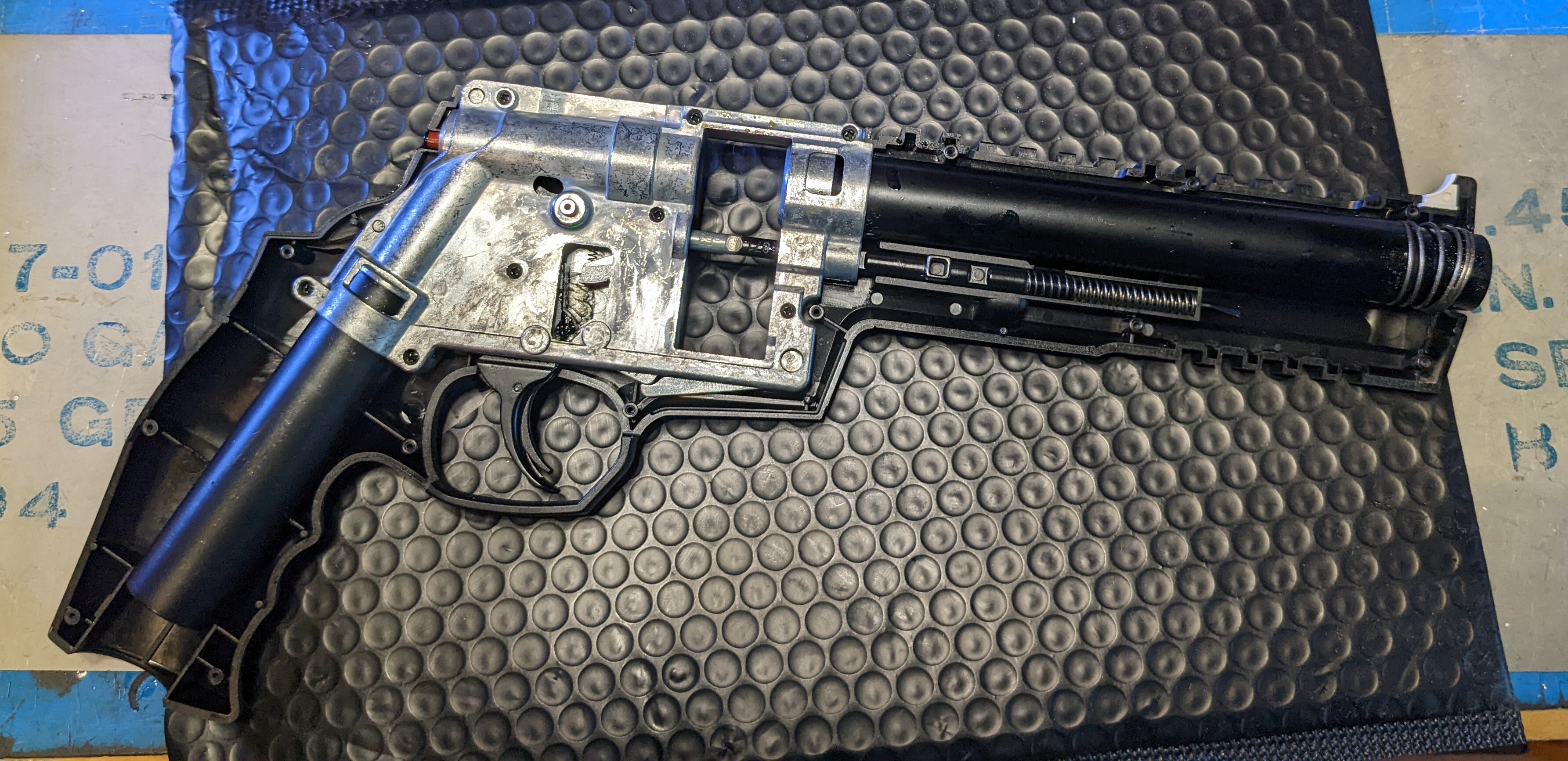

    Ok, I think I found a way to bump up the velocity a bit ... Gonna do some testing and get a few parts, but I'm 90% sure it will work 👍
    Also, some pics for reference:

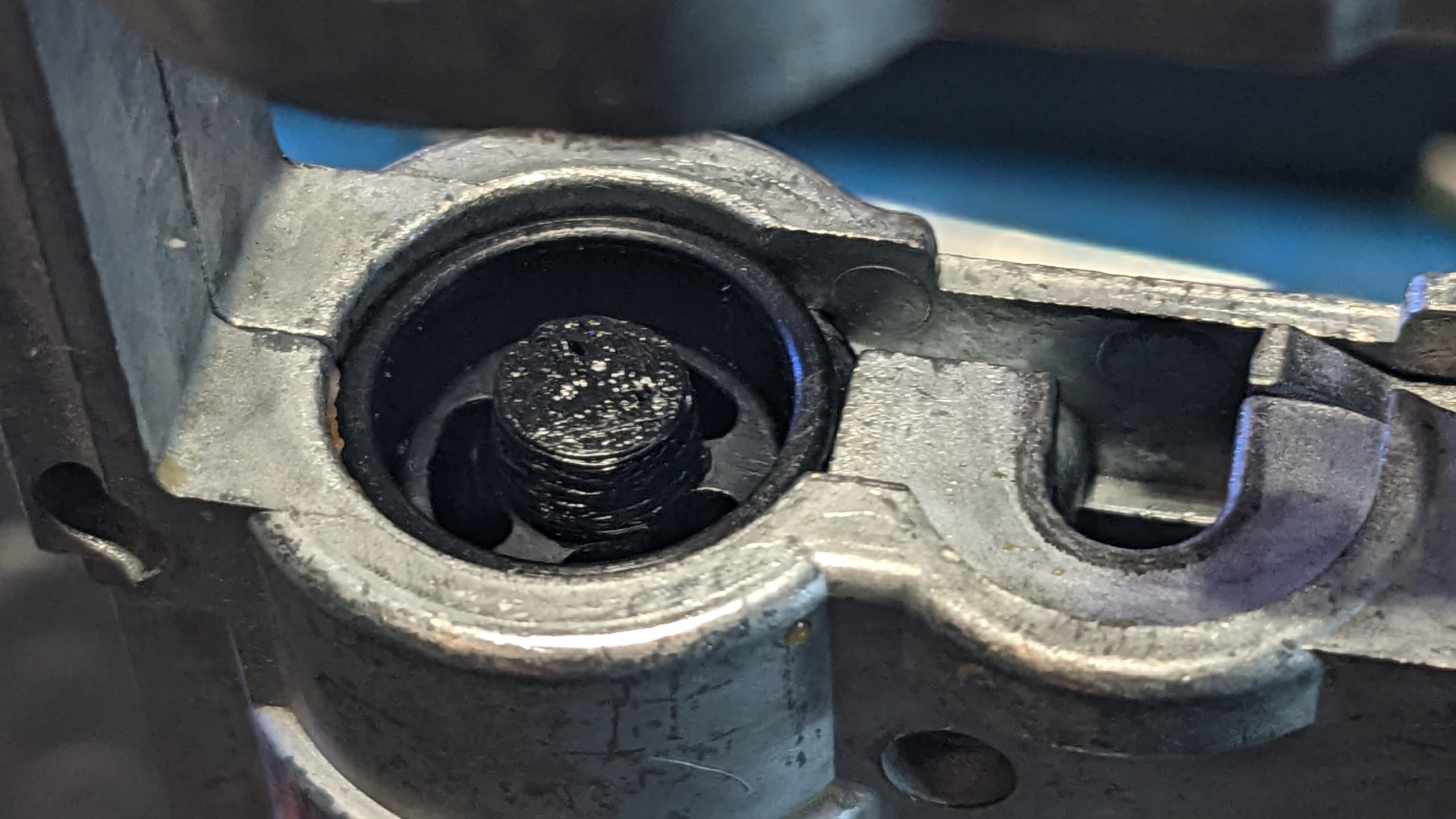

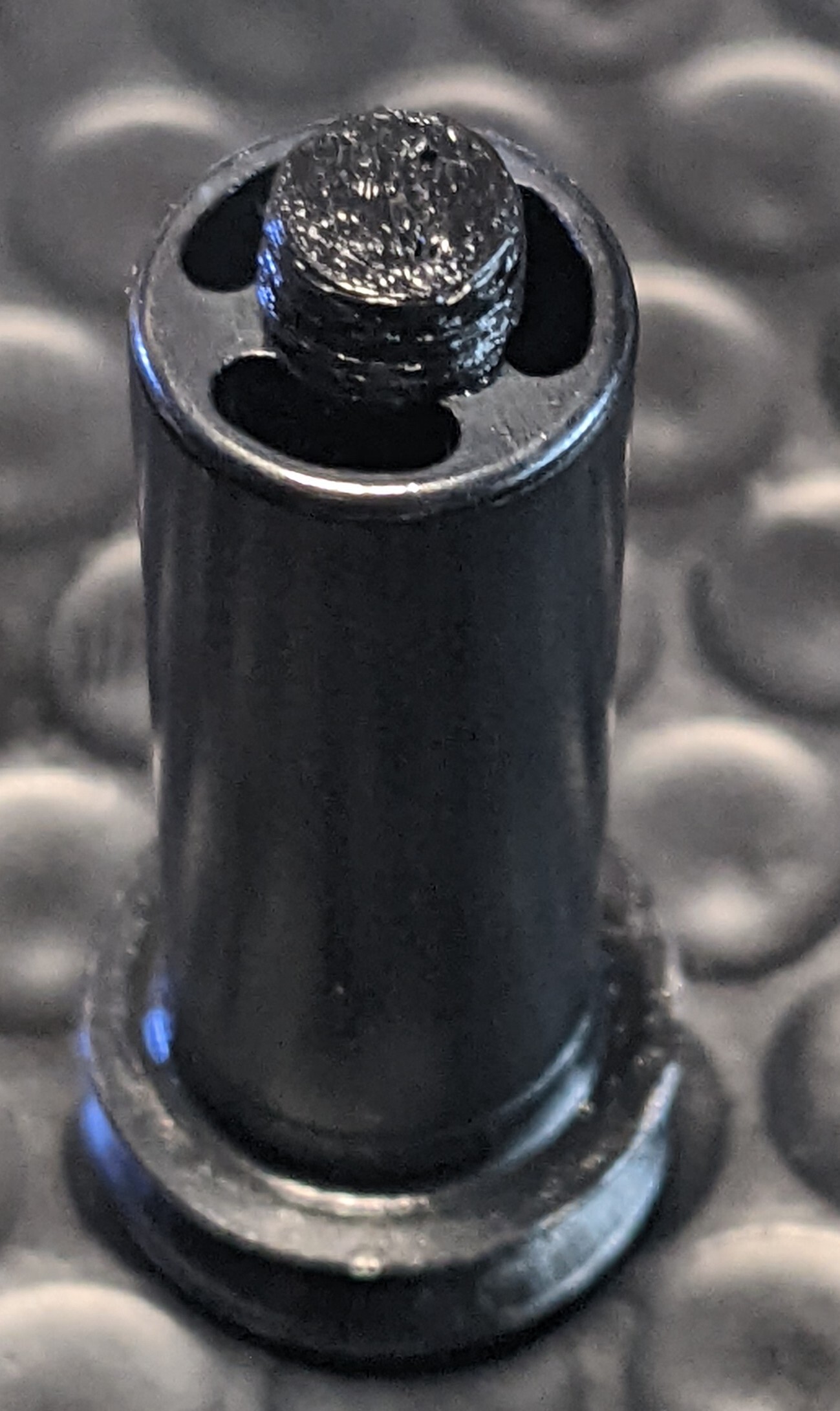

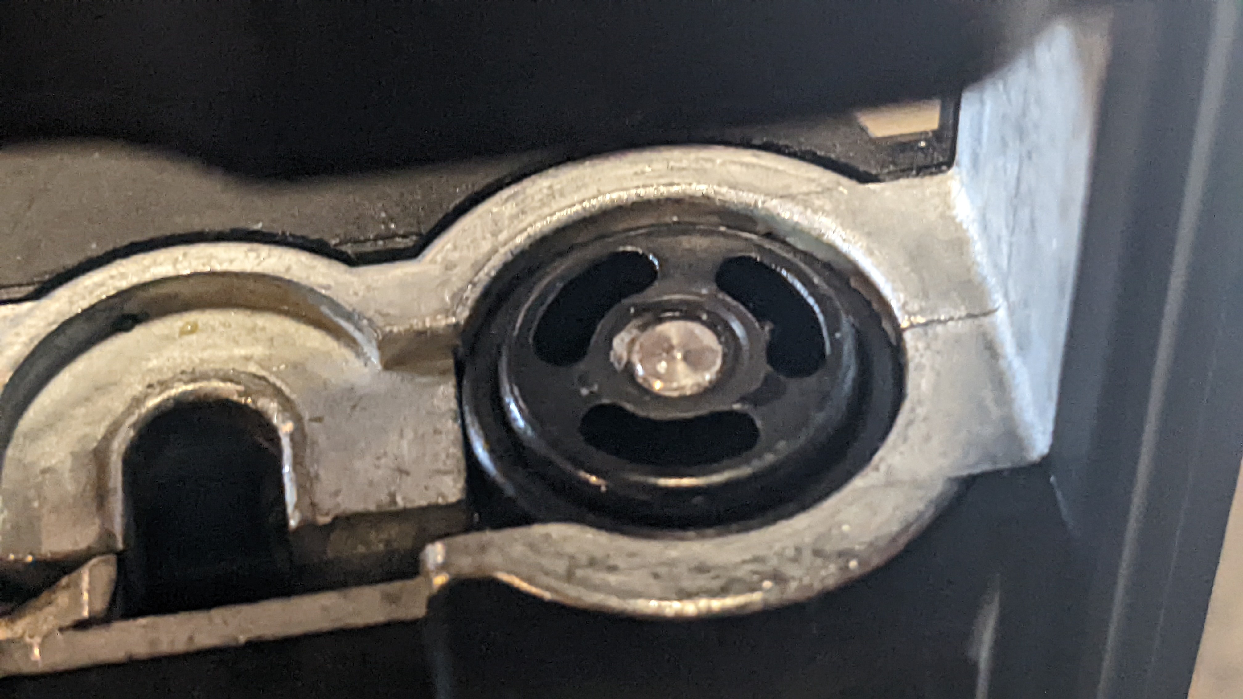

                I am strongly thinking the breakage is coming from teh impact of the bolt onto teh ball and not the air ...
                The front of the bolt has a "ventury style" face ... it looks a hell of a lot like a mag bolt (similar valve design)
                I am wondering if putting a foamy tip, similar to the one on mag bolts, wil help reduce breakage ...
                Does anyone know what those foammy tips are made out of?
                • Grendel
                  Grendel commented
                  99% sure the Mag's Foamy is low durometer neoprene but a low durometer TPU would likely work as well.

                Wait, so it's a revolver but there's still a bolt that makes contact with and chambers each round? Through the cylinder?
                  XEMON commented
                  Yes, when firing, the bolt protrude into the cylinder ...

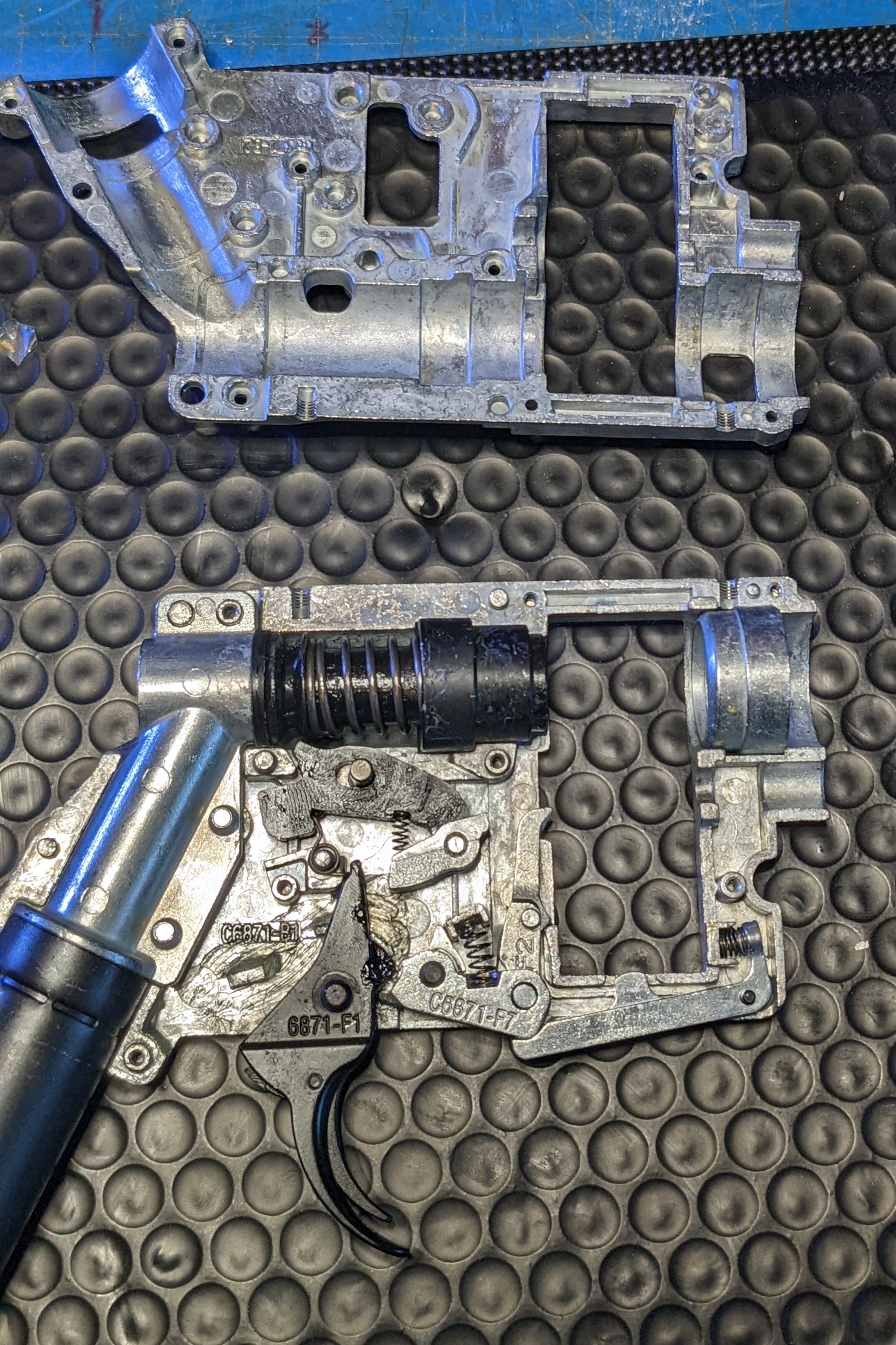

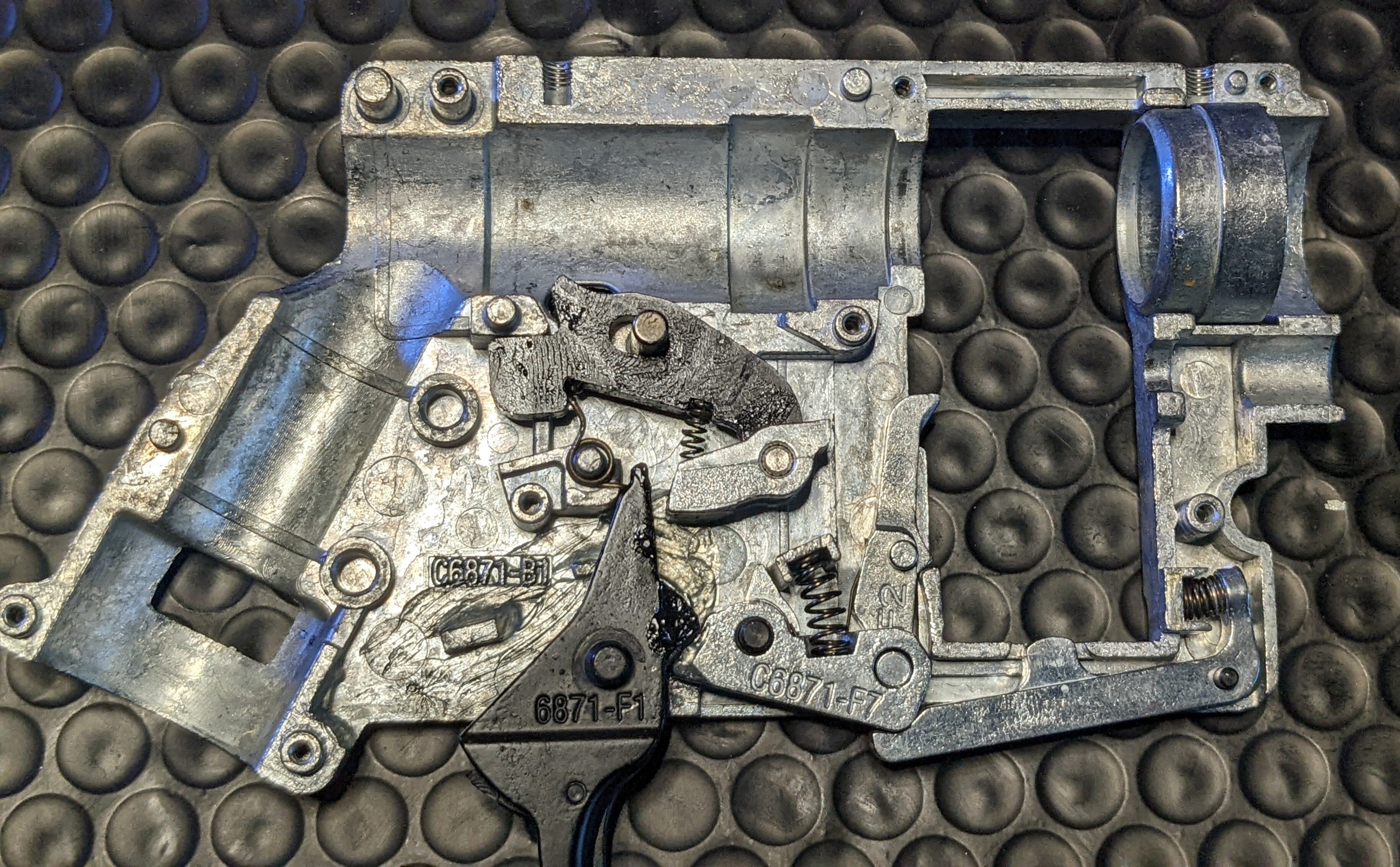

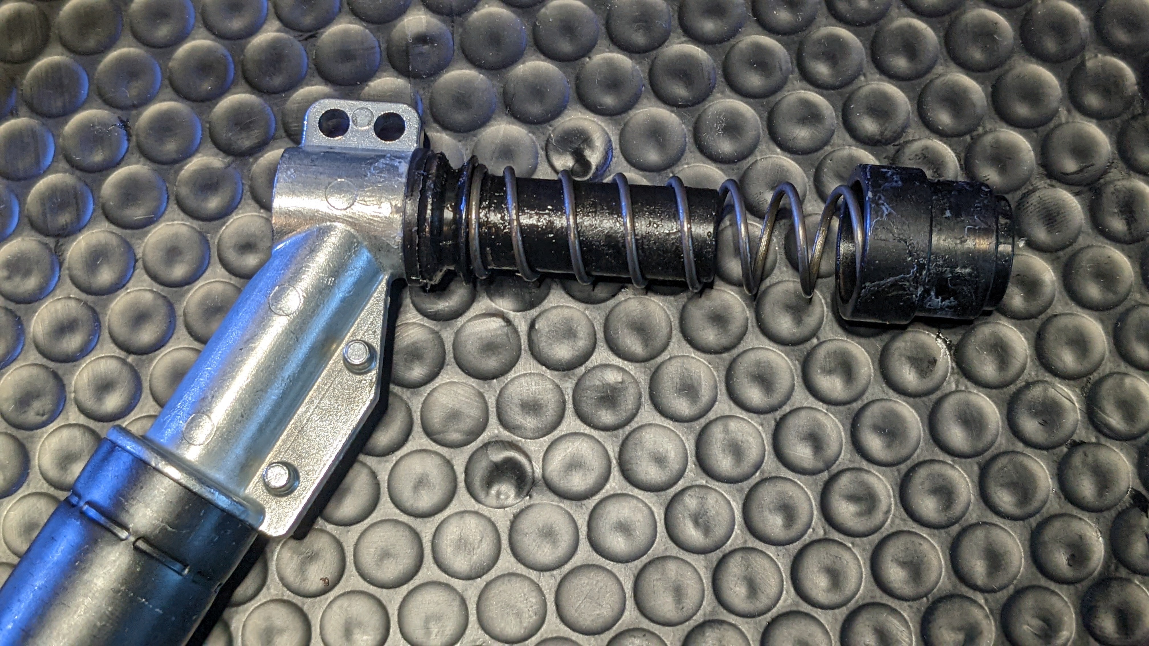

                I didn't pull it apart yet but I believe that is the case as there is a spring in front of the bulb which almost looks like a blow forward type thing you find an automags..
                ​​​​​​ Xemon... They are a dense foam however I have made 3D copies of them in flex material which work on Automags... Once I mess with the gun a little more I'll be a little more intrepid to tear it down and take a look

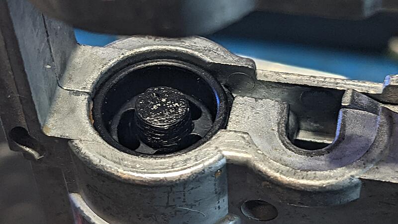

                  Made an awesome foamy tip:
                  But once it's aired up, the bolt move forward and become flush to the cylinder ... So the cylinder won't turn with the foamy tip:
                  On a good news, after the third attempt at upping the velocity, I'm now between 250 and 280 fps on a fresh CO2 👍
                  I may or or may not try to go a bit higher ... I really don't want to go above 3 and have to drop it down ...
                  And here is a "slow mo" (as slow as my phone can take) of the bolt firing:
                    So a heavyweight spring helped up the velocity or just a longer one? Finally got some time off I want to mess around with mine.
                    XEMON commented
                    I haven't touched the spring ...
                    I did some machining inside the valve ... Once I field it and do some more test I may put up a "how to" if people are interested 👍

                  S9. Xemon has me thinking. Let's get dimensions for that foamie tip figured out and we can 3d print a mold. Then with my rocket foam, I pour a 2 part polyurethane foam to make a bunch in one shot.
                    XEMON commented
                    Great idea, the problem is that once the gun is pressurized, the bolt move forward and is flush to the back of the cylinder ... We may have a few thou, but that's about it ...
                    Punching a gask t material the proper thickness might be a better solution ... I have some thin and soft silicone sheets that would be great if they fit in there ...
