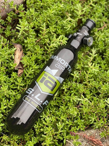

    Inception Designs has new small pump/magfed tank to compete with the First Strike ones.
    15ci/4500 output pressure of 430psi (according to email)
    https://www.inceptiondesigns.com/pro...f-1545-xlp.htm

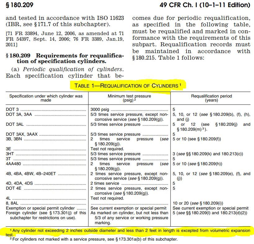

    Do we still have to hydro these in the US or are they exempt?
      BrickHaus commented
      Yep, 5year hydro, no lifespan.
      But its the same thing as the fs bottles. Shame IA isn't delving into the 17ci bottle.
    • William the Third
      William the Third commented
      Really, there is debate over if the 2"x2' rule applies to all tanks, or just aluminum, all metal, or ??? tanks. The way it is written, it really does appear to apply to all tanks. First Strike have labeled their mini-tank with "5 Year Hydro", but that could have just been done out of an abundance of caution. When a fellow MCBer contacted the DOT for clarification, they never got a reply.
    • Grendel
      Grendel commented
      Willian the Third I did get a response from DOT on clarification but did not post it because it did not really answer the question beyond that the statement - "Any cylinder not exceeding 2 inches outside diameter and less then 2 feet in length is excepted from volumetric expansion test" is that statement only applies to the Specifications listed in the table. They did not clarify if Table 1 applied to fiber wrapped bottles at all or are covered under the Exemption or special permit section. So really did not get the answer are fiber wrapped bottles covered.
      This might be a moot point anyway, as FS spent the time and money to get these ISO bottles listed and exempted by DOT [suspect Immortal Air's are the same] based on ISO testing and application to DOT] and the exemption letter for these particular bottles lists 5 yr inspection/hydro with unlimited life. I spent a good amount of time a Fulda Gap last November talking to FS about the hoops they had to go through to bring these bottles to US market.
