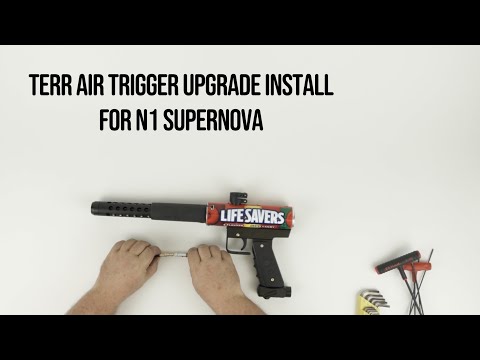

      Looks like they did an install video yesterday,
      BW Youtube

            Installed mine last night, not too bad of an install, but I wish they had picture by picture instead of videos. Videos are tricky for ADHD sometimes. Now it seems like my trigger frame doesnโ€™t fit flush anymore, gonna disassemble and reassemble today and see if I can figure it out. It did noticeably shorten the trigger pull !

              I just finished up the install on my N1 and itโ€™s amazing
              • FlightMedic938
                • Feb 2023
                • 440
                I swapped out the trigger return spring for a significantly firmer and shorter spring. I couldnโ€™t get the stock trigger guide or new trigger guide to work with the stock return spring using Terr Air.
                It shoots just fine without any spring/guide and there is a noticeable improvement but there was a lot of play in the trigger. With the much much shorter and firmer spring and using the new trigger guide provided with the kit it shoots even faster with a 80-90% reduction in trigger play

                  Terr Air is not supposed to have a spring.
              • FlightMedic938
                • Feb 2023
                • 440
                It works significantly better with one. No trigger play and lighter trigger pull
