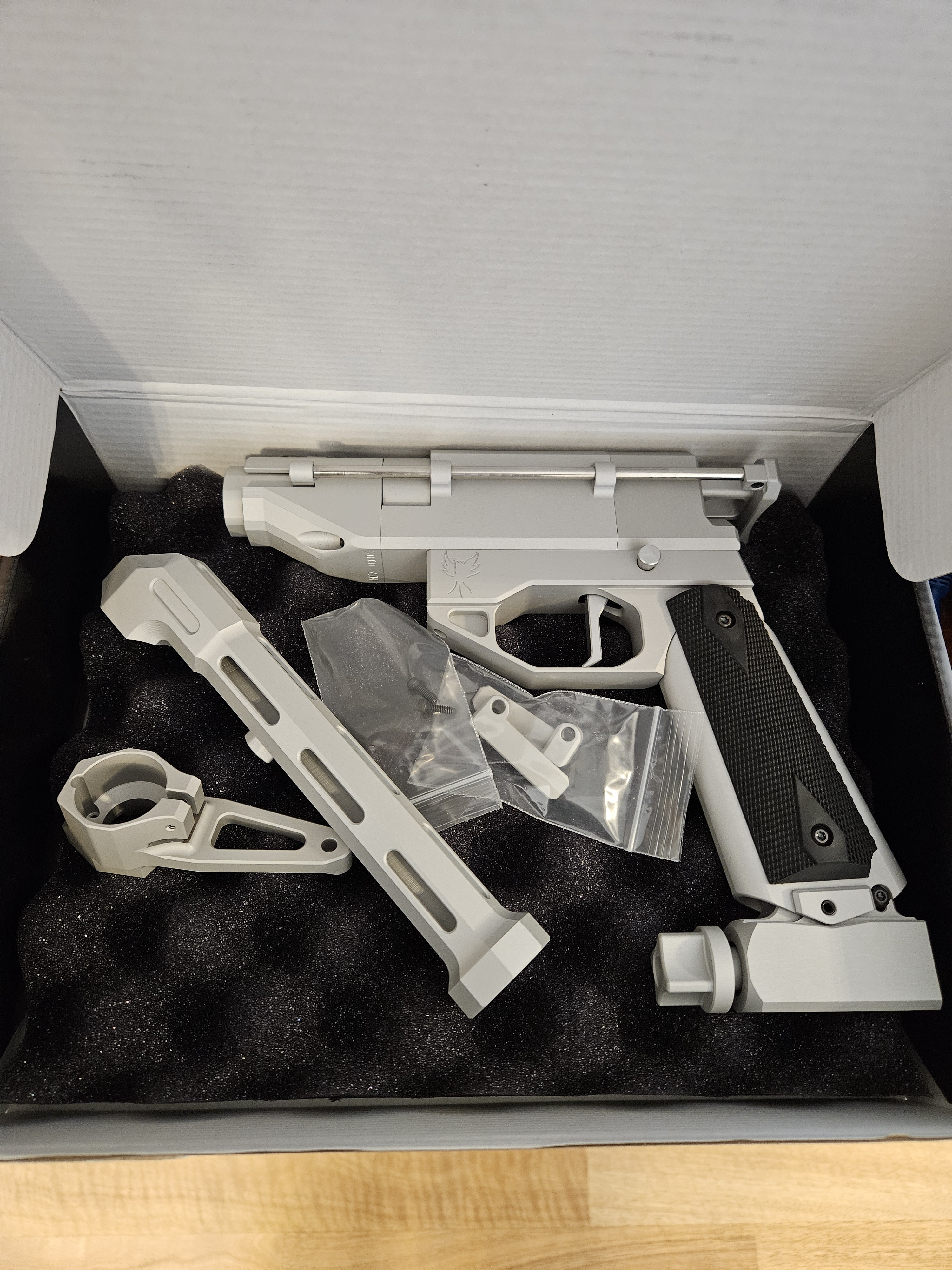

    Based on that picture, my assumption is that for reliability, the valve is designed for HPA only. Maybe they are working on a CO2 valve, sort of how the Phantom Revolution had 2 different valve setups. Either way looking forward to the Vasa version, as I think the grip will be a LOT more comfortable for thumb cocking.​
    super squirrel - Might be a good time for another video update, or maybe a Q&A video?

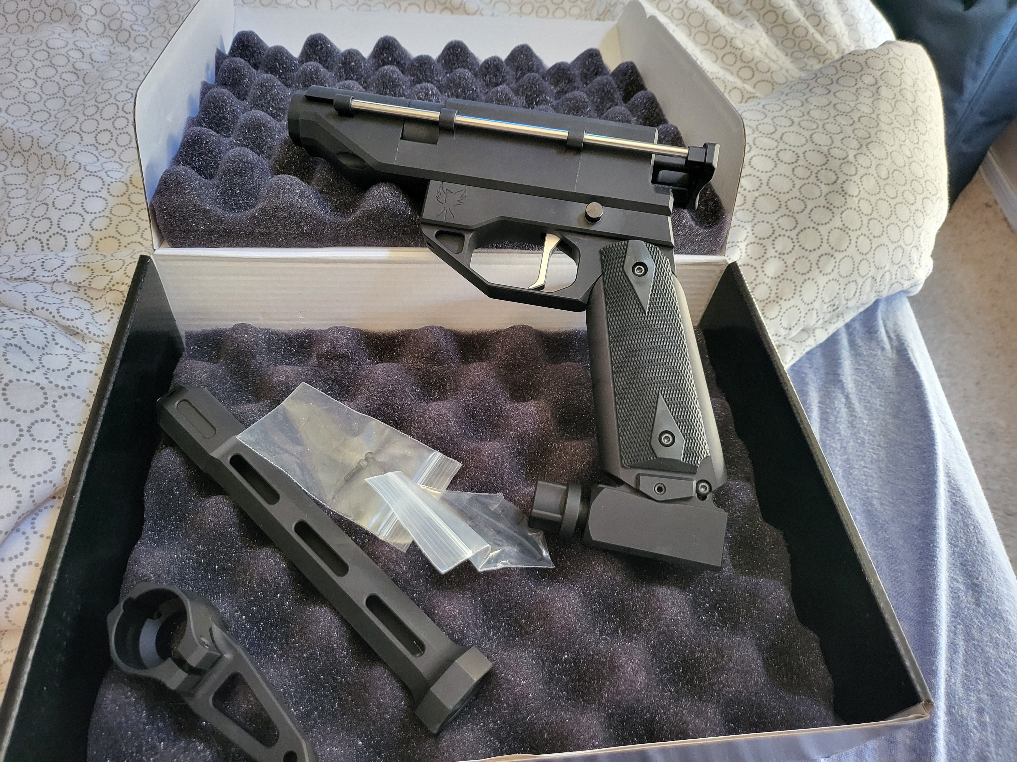

              Alrighty. Couple of quick things I've noticed because mine got delivered yesterday. Also, Scott sent out a disassembly link today for a breakdown.
              Some markers were shipped with matching right or left paddles. Scott is gonna be sending out the correct paddles if you reach out to him.
              Onto the marker. My thoughts so far.
              Disassembly is a bit easier than thumper #1. All the same screw size except the torx on the grip and the big boy for the regulator.
              Body has less screws holding it together overall.
              The action comes out much easier.
              Dual detents.
              1/4 turn Asa.
              I like the new feeds. They feel nice.
              Scott recommends super lube or dow33. NO OIL.
              Current gas through grip is HPA only. He says co2 will void the warranty. He says he uses milspec orings, and all are common sizes.
              Seems to be very similar inside. Piston is redesigned but has the same basic DNA. He mentions that the common fail point is that front oring, just like the Thumper. Heres to hoping mine doesn't shred it at 500 balls like clockwork like my thumper.
              Seems to use the same "hammer hits valve" design as the Thumper. The stand in for the clippard is very beefed up compared to the og design though. The pheonix hammer may slide rather than arc though. I haven't taken mine apart yet to look.
              Trigger is short throw and stiff. I'll be seeing about replacing rhe spring with something lighter and looking into greasing it as well. It's not bad, just stiff.has maybe 1/16 inch travel overall.
              Can be cocker upside down. Thumper couldn't do that.
              You won't be striping this in game. Bench strip only.
              Heavier than a thumper for sure. Has a slightly higher bore axis too. (The trigger tray is all one piece on this pheonix) doesn't have the speed/thumb paddles cuts like the og thumper either.
              I'm taking mine to the field today to shoot. I'll update after I've put a bag through it. Click image for larger version
