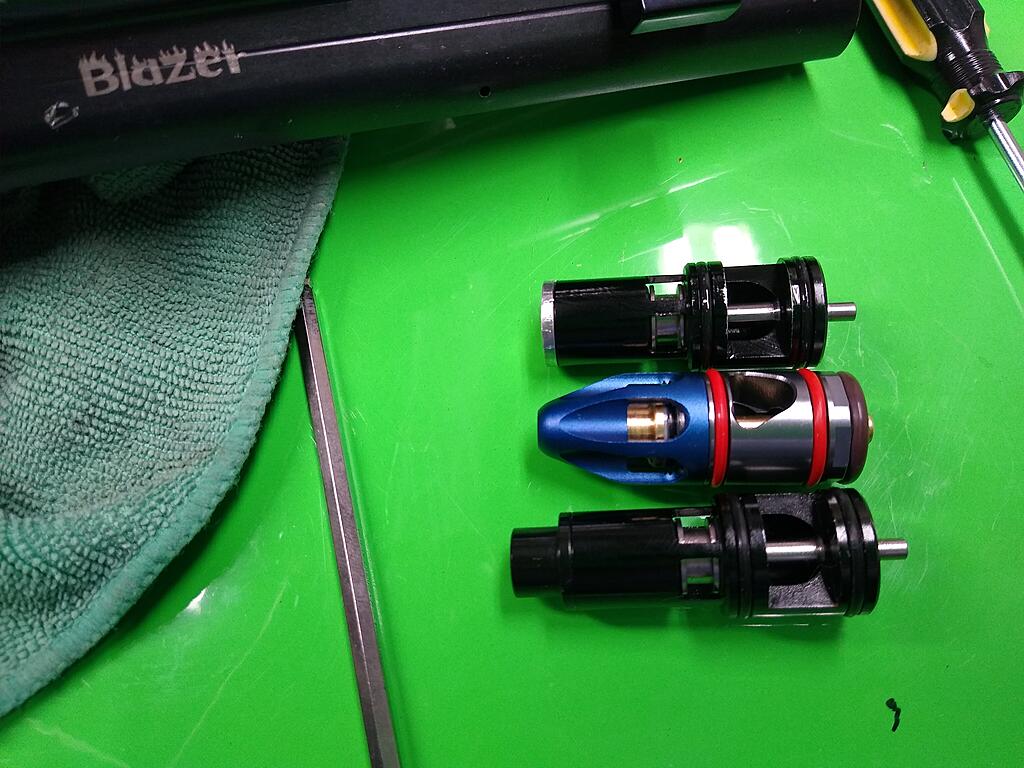

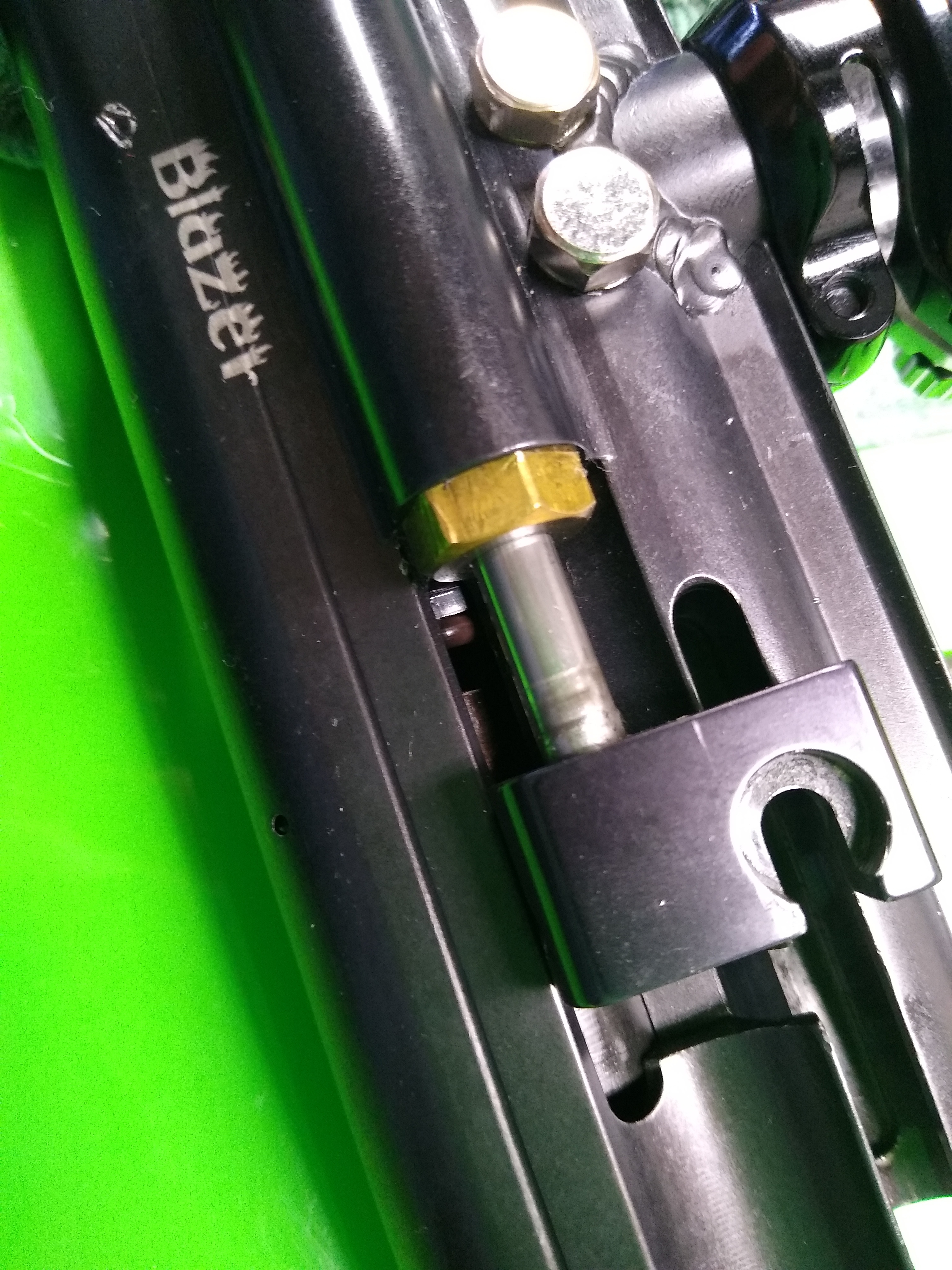

        I received mines and decided to shove it in my modded Blazer. IMG_20231015_144316400.jpg IMG_20231015_143911751.jpg
        • Jackson
          Jackson commented
          Did it work?
        • Kit
          Kit commented
          A touch louder and a bit lower velocity than the morph valve. Velocity is probably because of the bigger front on the dye valve and my blazer already fighting for space with both valves.

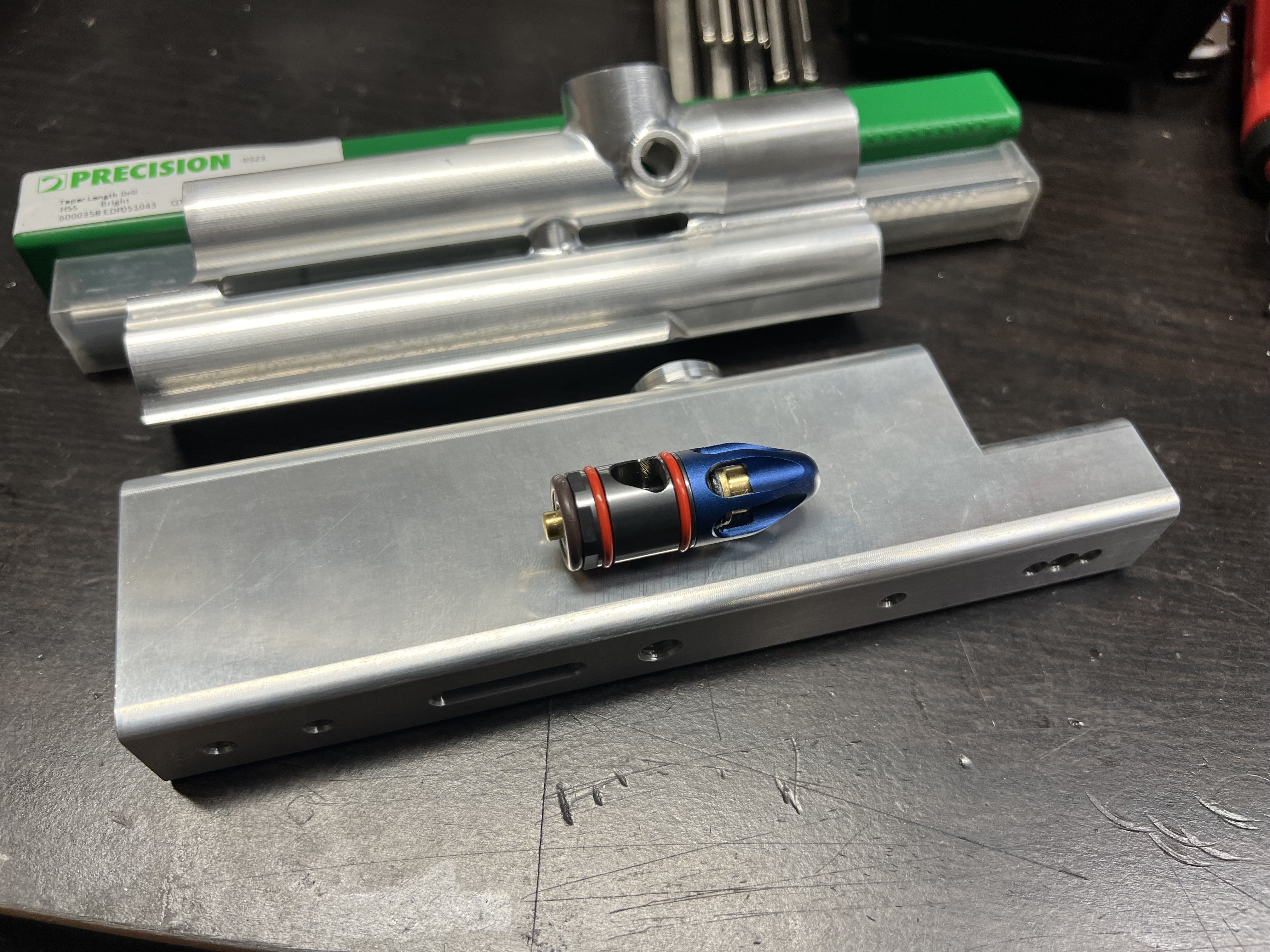

            So I drilled and reamed the lower tube of a pre 2k cocker I have. Plugged the front so I can use the original front block.
            It's shooting 320fps at 230psi with reballs. I'm running a delrin hammer from the morph valve and blue madman hammer spring. I'm getting a little bit of farting but that's the lightest hammer spring I have.
            Who makes the lightest hammer springs?
            IMG_20231018_162658003.jpg IMG_20231018_162651226.jpg IMG_20231019_140710177.jpg IMG_20231019_145041024.jpg

              Kit commented
              I got some slps springs coming from @maggot.
              I will report back when they show up.
              What pressures are people reporting with the valve?
              I should also get a new gauge for my tester. My gauge no longer starts at zero.
            • Brokeass_baller
              Brokeass_baller commented
              I second SPLS springs.
            • imped4now
              imped4now commented
              You may need to spec a "non-paintball" spring. I've spec'd one on McMaster Carr and can report back with the PN#.

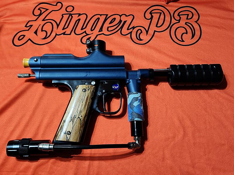

                Got mine in my trilly pump today. Slice pump kit and SLPS hammer spring. Just dry firing this thing is smooth, and such a crisp shot. Can't wait to field test.
