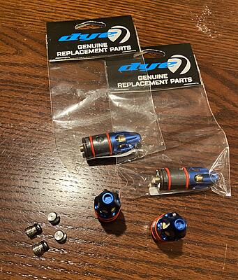

    ACParts had some listed in stock so I picked one up with an order.
    Probably going in a Trilogy build, too.

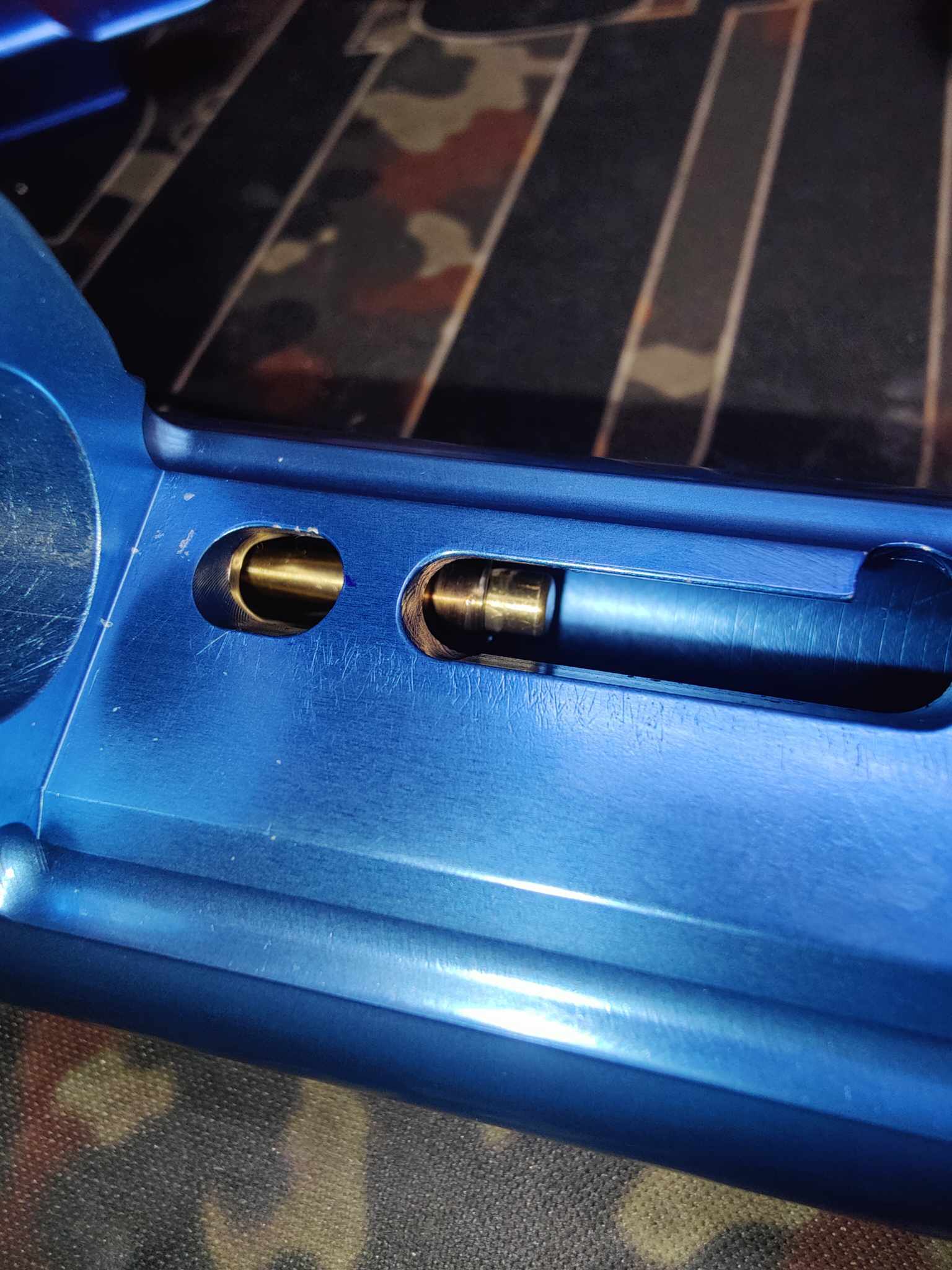

      It fit! Had to steal the valve nut off my T2 and file it down a little as the stock one was too long. Threw in a Jenni Kraig hammer and the main spring it came with. Pump stroke went from ~6.1 pounds to ~3.7(!). IVG flush. Sidewinder set to a little under 200psi. Don’t have a chrono at home but eyeballing it I’m at or around 300fps and the sound signature sounds like a nice clean pop, much more satisfying to the ears than stock. Wild. Can’t wait to hit the field with it.
      I only wish I could throw this in my T2.

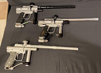

      Did some compares the other night in an AKA Ehm. CCM and AKA 11/16” valves were on par with each other, with the Lazarus gained 30 feet per second at the same dwell and pressures.
      Had to do a little modification to the hammer but very happy with how it shoots. Probably will be installing these in more of my markers.

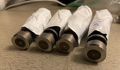

      I thought maybe I had 1 too many of my wife’s gummies last night, but installed 3 Lazarus valves in Vikings and observed ~60 fps gain on each with no other changes. Another individual on the AKA fb page saw similar gains. Insane to me. No comment on efficiency until I get to a field this spring.
      Gloss silver Viking +63 fps
      Dust silver Viking +60 fps
      Valhalla Viking +59 fps
      This gallery has 3 photos.

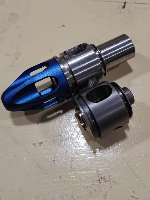

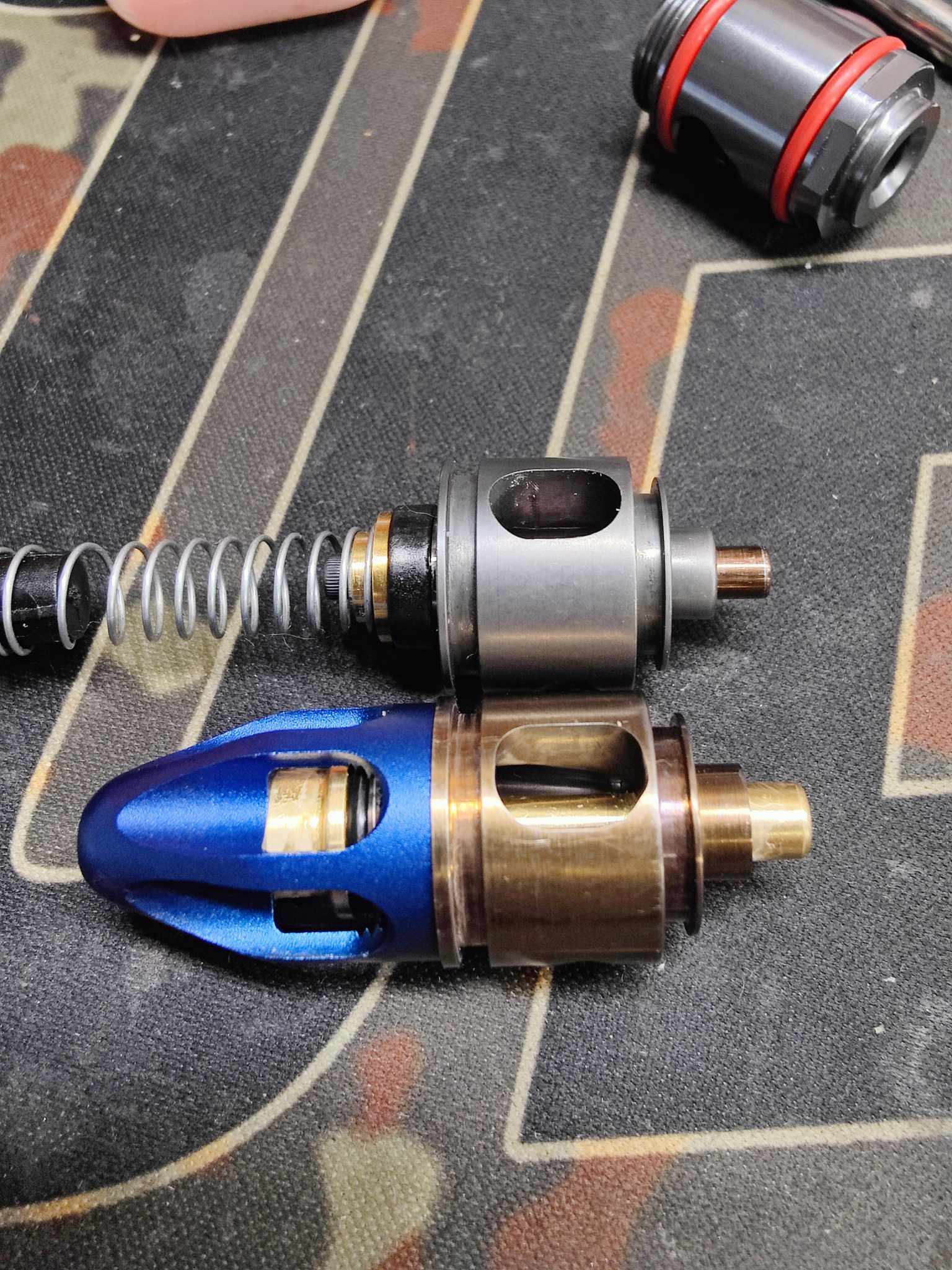

        Decided my MT A4 angel needed a Lazarus valve too. Made a new valve body out of SS. Going to hopefully get some testing in next weekend. I have a light weight hammer to try out with it.
