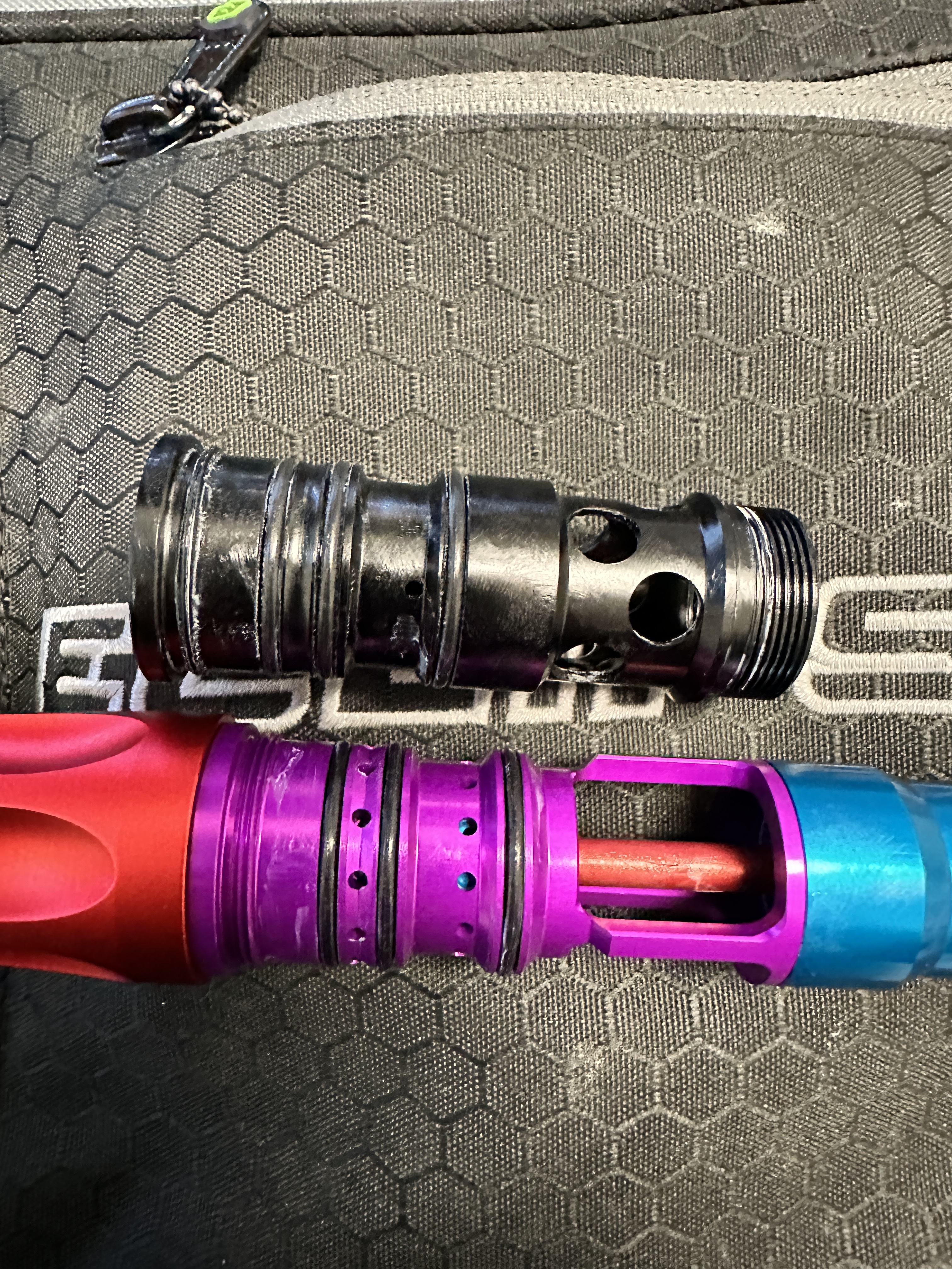

                I think the big change isn't necessarily between what we see on higher-end gamma's (the 4 post design) and this, but more on the "honeycomb" style gamma's you see in EMEKs.
                oh wow. There is a difference in the emek and other gama cores. My gen 1 GTEK doesn't have the honeycomb design. I wonder why they did that. Cheaper to manufacturer? Maybe it's got to do with it being screwed in, instead of just sliding out?
                • flyweightnate
                  flyweightnate commented
                  Certainly looks cheaper - drill instead of mill!
                  I have a spare on its way and will be... adjusting it for science.
                • MrBarraclough
                  MrBarraclough commented
                  Probably both. Less milling and more robust.
                • flyweightnate
                  I modded a spare can and saw a negligible difference in velocity, trimming a group of three holes into one big triangle. Color me suspicious that the improved flow is better than placebo.

                        Well, I got my valve and installed it. With a fully stock Emek, there is no way to reliably fire off a single shot every time I pull the trigger. That's both when dry firing and actually shooting paintballs. Worse still, when I tried to shoot a string of single shots I'd often ged mad drop-off (below 200 fps). I know, I had a chrono. However, when I did fire full on the streams were steady with no discernable drop-off. I was using old paint on a cold day and had no issues whatsoever.
                        When I tried the valved coupled with an aftermarket Exalt trigger, forget it. The thing became possessed and wouldn't stop firing. I had made sure that there was plenty of play so that the valve rod had ample space to reset properly, but still.
                        Yet, for now, I've decided to keep the valve along with the stock trigger. At least with the stock trigger it is actually easier to fire off a single shot or two for chrono purposes. The beauty of it is that within 30 seconds I can easily swap valves if I want to. That for me is the clincher. This Emek will make for an awesome loaner or for overall s*** & giggles purposes. OTOH, I can easily revert to the stock valve and slap on a PAL loader, going for a totally different effect (slow ROF - I find that the PAL works fine with a fully stock Emek, but can't keep up even with only an upgraded trigger).
                        By the way, it so happens the field I was at offers the cut o-ring mod to Emek owners.
                        "Aren't you getting too old for this??"
                        "Nope."
                        • Cyberpyr8
                          Cyberpyr8 commented
                          I also bought the cheaper Core Ignition Valve and it does the same thing. These valves are only good if you want to do full auto. Though, I didn't have the drop off issues you are seeing. I gave my RapidFire valve to a buddy with an EMF and he didn't like it either. I have my Emek back to Hair45 and fang trigger configuration. It rips that way and is predictable.
