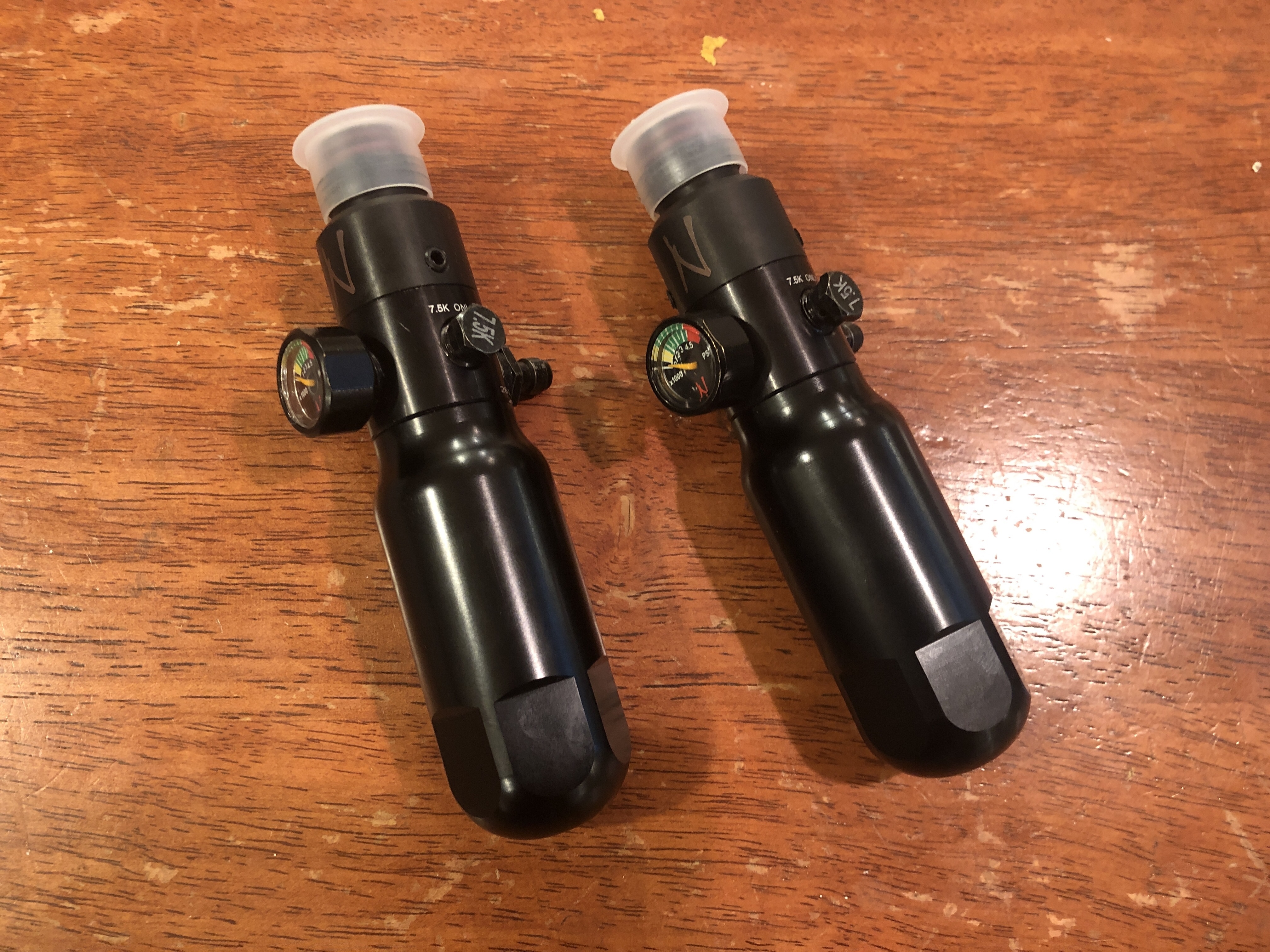

      Originally posted by procarbie
      There are tiny 4500’s you can get as reg testers, (they’re just little steel tanks that take less time to fill due to their tiny size). I imagine they’d work just as well for testing regs as testing markers. I got them to play with and for the novelty (they just arrived today so I haven’t tested em out yet), but I’m sure they’ll see some use for that as well.

      • k_obeastly
        • 450
        If you’re filling with your own small compressor, these would be great for testing instead of waiting a half hour or more to get a 68 up to pressure.
