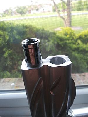

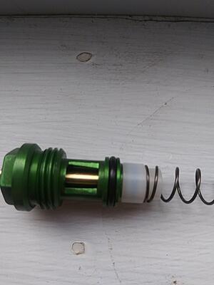

    Not super impressed with the small details, as @​Araphel said the transfer port looks like it was done drunkenly.
    The anodizer didn't clean the sealing solution off leaving it sticky to the touch. This is easy to fix though just use a solvent such as isopropyl alcohol, I used wd40 as that's what I found first. The photos are from before I cleaned the residue off.
    I found that you have to use a 1/4" drive socket as the 3/8 drive ones I have are slightly to big.

    • jetenginekyle
      jetenginekyle commented
      I'm willing to bet Nova did the ano in house and they did a good job! If I'm correct I don't fault them at all for missing the final step to remove the sealant residue as there is little information on this online and you have to go digging for it.
    • superman
      superman commented
      pretty sure they do not have ano in house. however, i do think they have an industrial anodizer locally.
    • Masonhd81
      Masonhd81 commented
      Had the same issue, just went to Walmart to get a nut driver. Kind of a bad idea to use such a big size for a little valve

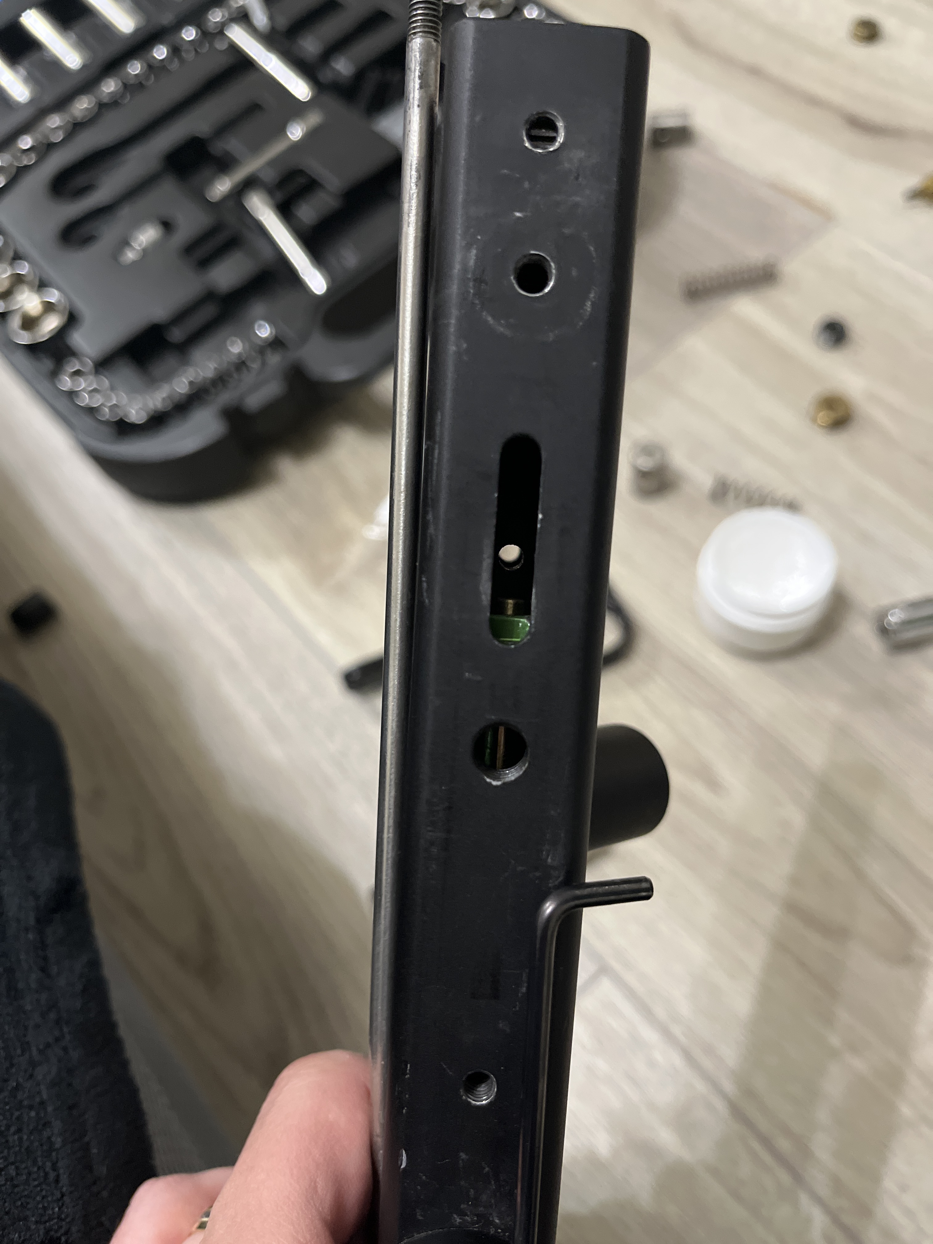

      #35
      This was a handful. Socket size they chose was a terrible idea. But it’s in. Let’s see if it actually seals now.
      • Masonhd81
        Masonhd81 commented
        Update it seals and shoots, I can tell I’ll have to turn the ivg quite a bit to get velocity. More testing to come in the near future.
      • superman
        superman commented
        It looks like you need to align the valve to the port.
      • Masonhd81
        Masonhd81 commented
        Yea I adjusted it later on. My socket got stuck to it for about an hour, so I gave up lol.

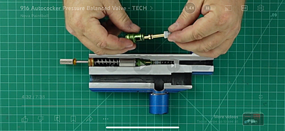

      Does anyone have pictures of the poppet outside of the valve body? I'm curious how they made this pressure balanced.
      • Masonhd81
        Masonhd81 commented
        Looks a lot like how the Lazarus valve is. Basically looks like a backwards valve seal.
      • timekeeper
        timekeeper commented
        It looks like it's using the same principle as the empire balanced valve for gen2/3 intimidators, where it's not completely balanced, but pressure runs through the poppet stem and pressurizes behind the poppet o-ring in the valve body (which also requires an o-ring in the valve body around the protruding valve stem). Personally, I like the way the Lazarus valve does it better, there's 1 less possible point of failure and the valve is more balanced (forces acting both ways are closer to being the same).

      #37
      tyronejk taken from nova’s YouTube video breakdown of the valve.
