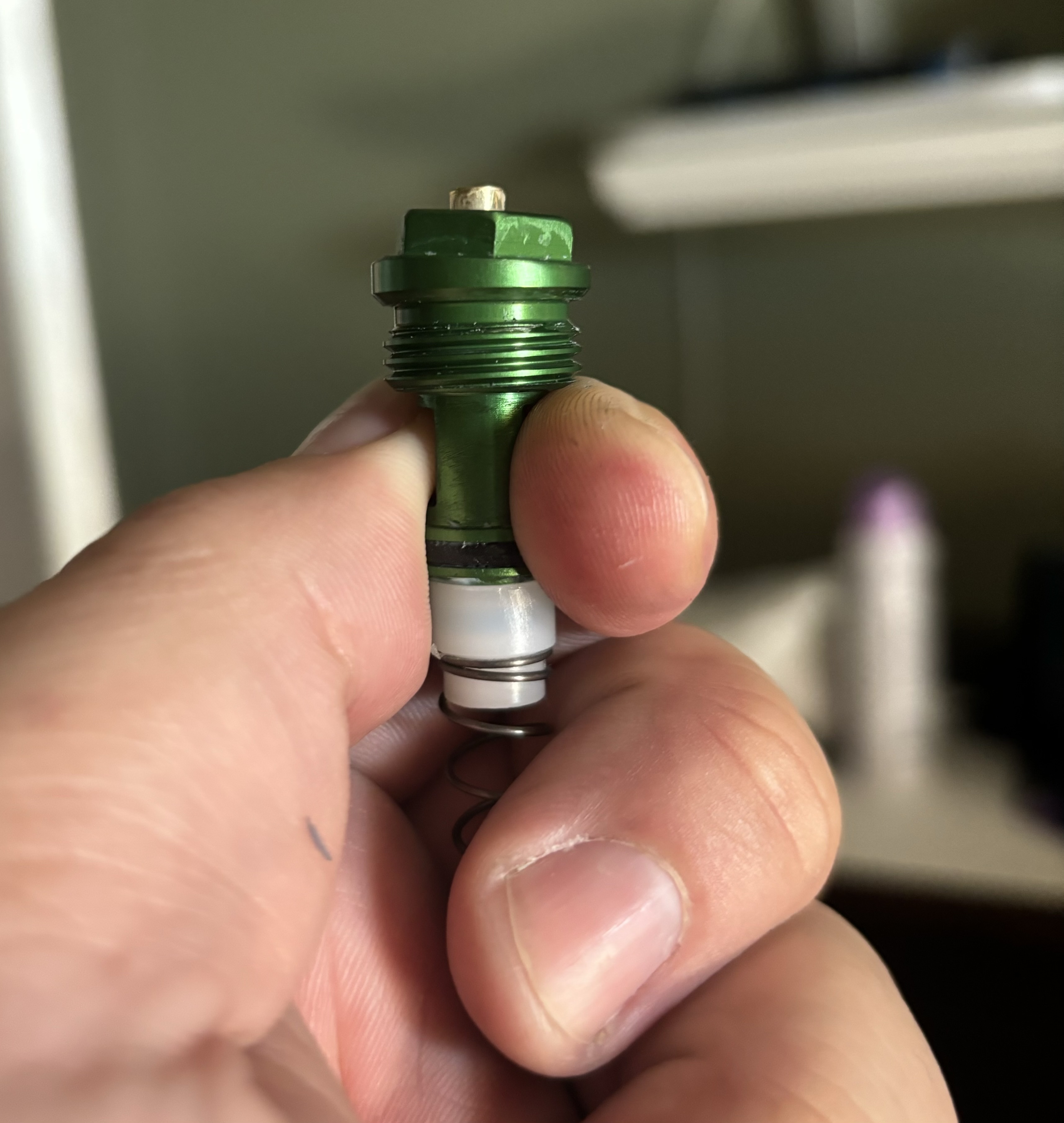

    One of my three valves was also massively cockeyed as well. They said they would send another out immediately so #fingerscrossed…
    Ive noticed the resistance I feel on the valve stem is different on each of the three valves, the cockeyed one having the most drag of the three. I haven’t bothered to spec them to see if there’s any dimensional differences..
    I couldn’t tell a sound difference between my test mule marker and my ccm S5 (built with identical parts except provided nova parts)
    • Myrkul
      Myrkul commented
      The resistance on mine felt kinda weird too until I squared it off. Once the top was actually flat the resistance felt MUCH better.
    • Frmrspec
      Frmrspec commented
      My big concern is that the hole for the valve stem is established when the hex is milled, meaning it’s likely off center/poor concentricity. Maybe I’ll bring my fubar’d vakve into work

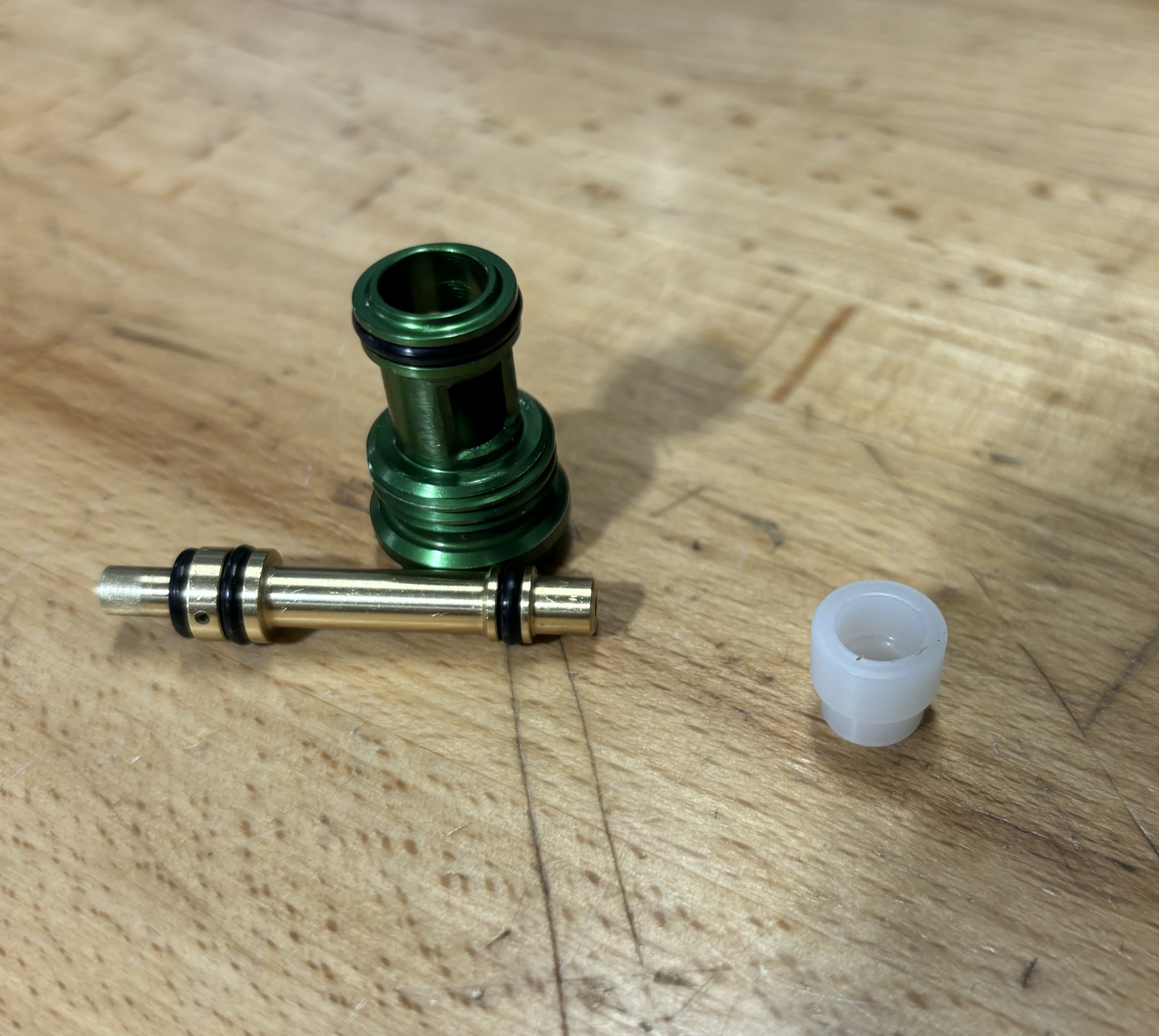

    Did anyone else realize the cupseal isn’t threaded? It’s slip fit over the valve stem with an oring being used for retention.. probably why it needs a more firm valve spring
    • William the Third
      William the Third commented
      I did, when I was chasing down a leak. It's actually one of the design choices I'm not fond of. The o-ring is needed to seal since the cup seal isn't solid, but some threads would have been nice to better secure the cup seal on the stem.
