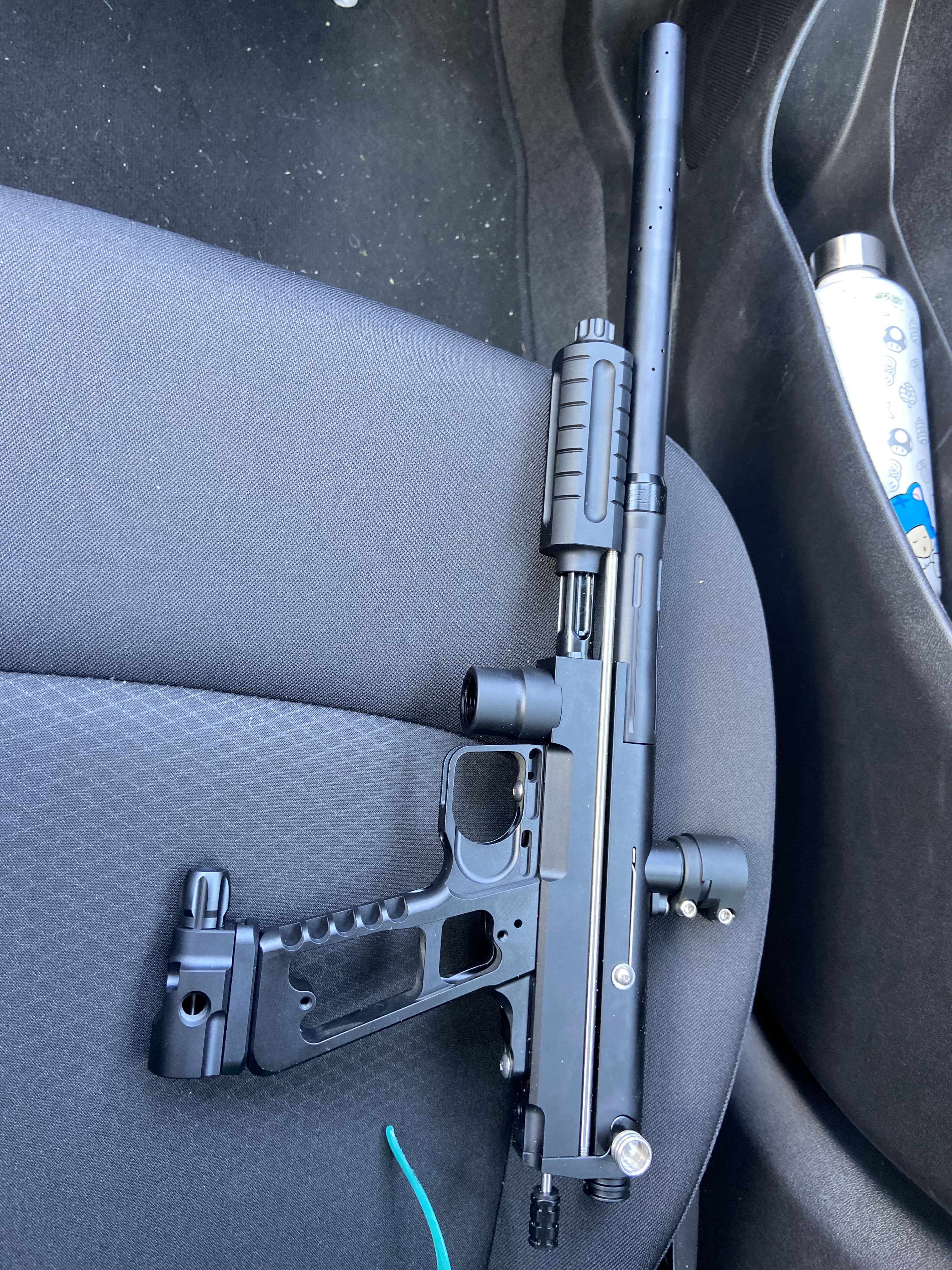

      Mine arrived today after a daring rescue from USPS (shipped to a wrong hub locally and it stalled out in shipping). Looks to have all its parts, but I haven’t opened it up yet to make sure. A local got his in from the original order with his main spring, trigger plate and IVG missing.
      these feel fantastic though! I didn’t see that they came with fittings, but some people were randomly getting them included. Did they just throw extra bits in Willy Nilly for some people in the first round?

        It’s in the box. I just unwrapped it in the car to fondle it, but there are baggies with grips, screws and the trigger bits under the peanuts.

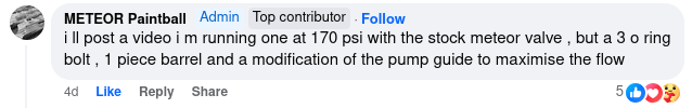

            I forgot to post this here. I made a post on the Meteor Facebook page about my testing, and Fabrice responded with this:
            image.png​

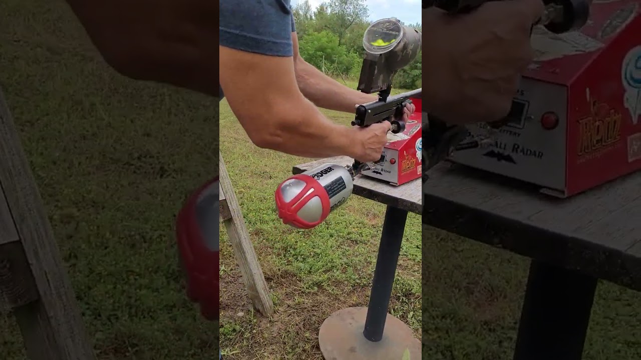

            Well, the video is up:

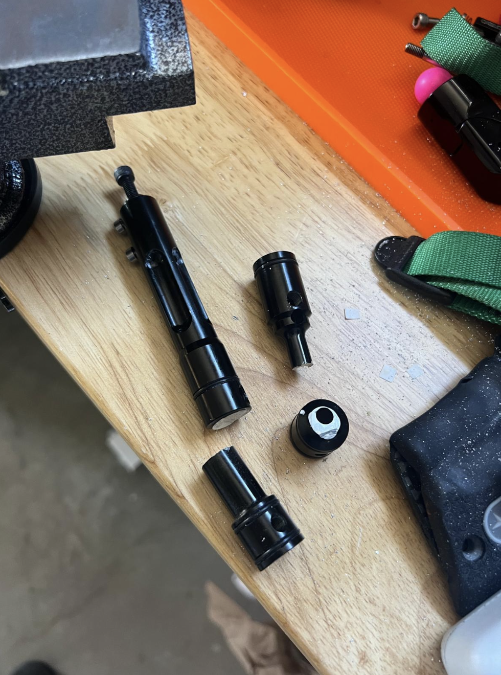

                  #87
                  science!
                  I was able to drop 40psi on the reg by removing the center section. I chopped off the front of an LP black chamber and the pump guide. I used the LP front for the frame screw and the guide with the vasa screw.
                  180PSI stock meteor valve, valve spring, hammer and a 2" spring. shooting 315pfs with reball.
                  • superman
                    superman commented
                    I don't remember doing anything different other than assembling it. I will double check the pressure. I actually have another members meteor here as well.
                  • superman
                    superman commented
                    It was in fact 275. facepalm.
                  • latches109
                    latches109 commented
                    superman Pre-chop lowest I could push it (reliably) was 250. The 180psi was easy to hit after removing the center. I’ll try one of Gants chambers for sure, looks great. I was able to push one of my trilogies to 130psi with a modified laz valve. I’ll swap it over to the meteor this week and see what happens.

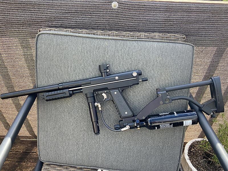

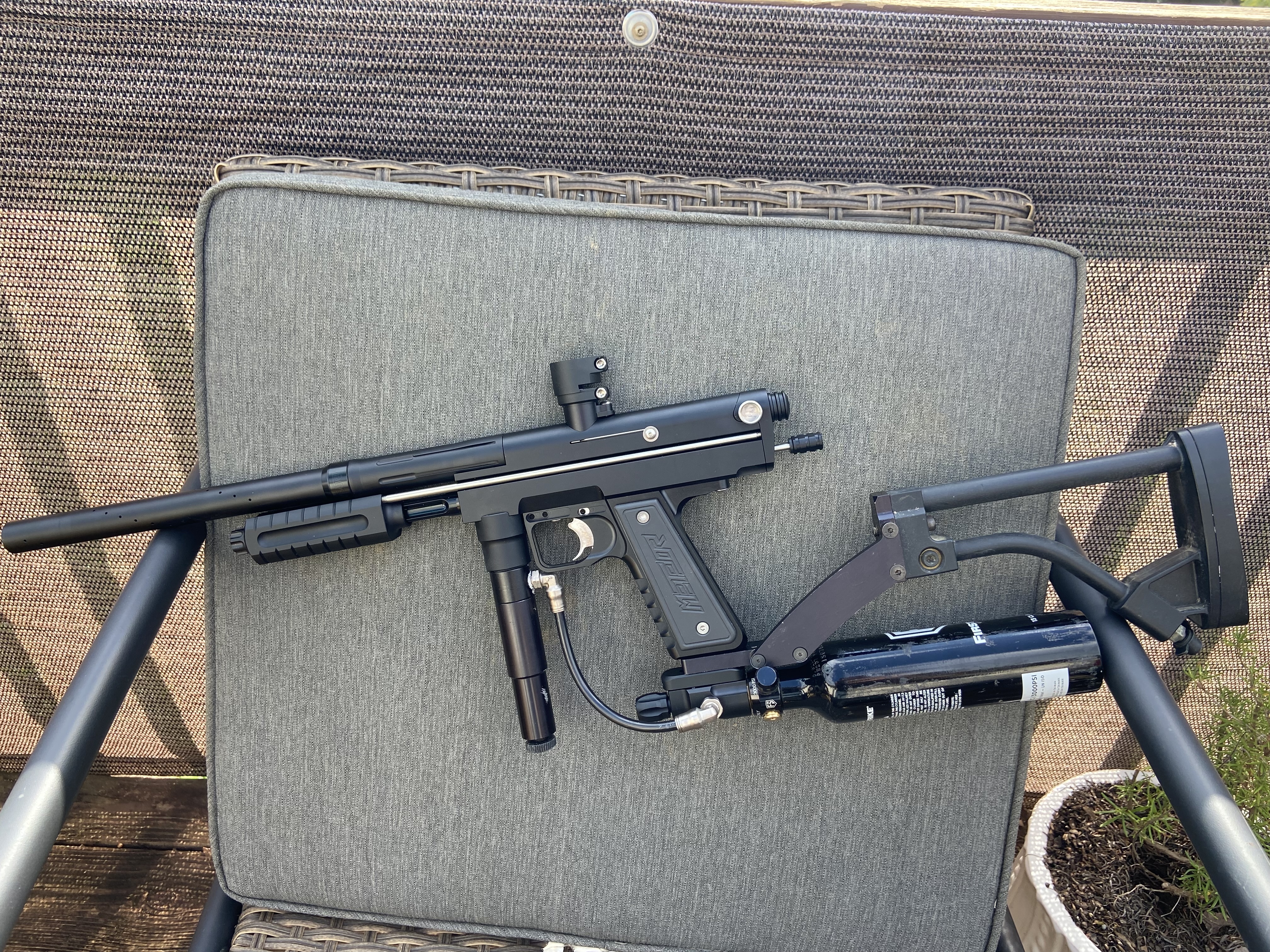

                  Got mine set up. just need to tune and crono. Also, got that reg 2nd hand, any chance someone can ID it?
                  • Vegabond
                    Vegabond commented
                    how hard is that going to be to resolve and where would I find parts? as much as I hate to abandon it, would it be better to get another reg for the time being?
                  • docfire
                    docfire commented
                    Send that bob long reg to Docfire fora complete rebuild
                  • Vegabond
                    Vegabond commented
                    ok relubed the bob long and added some to the reg seat and its holding at 200 psi right now
