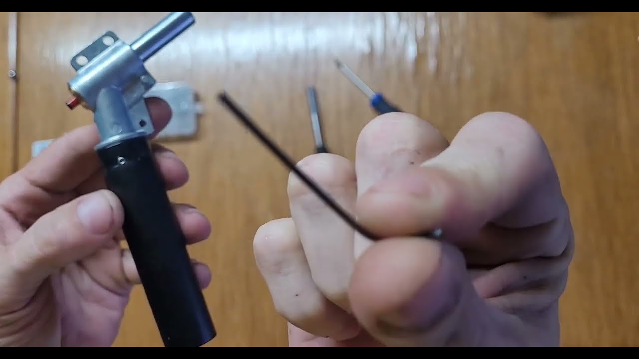

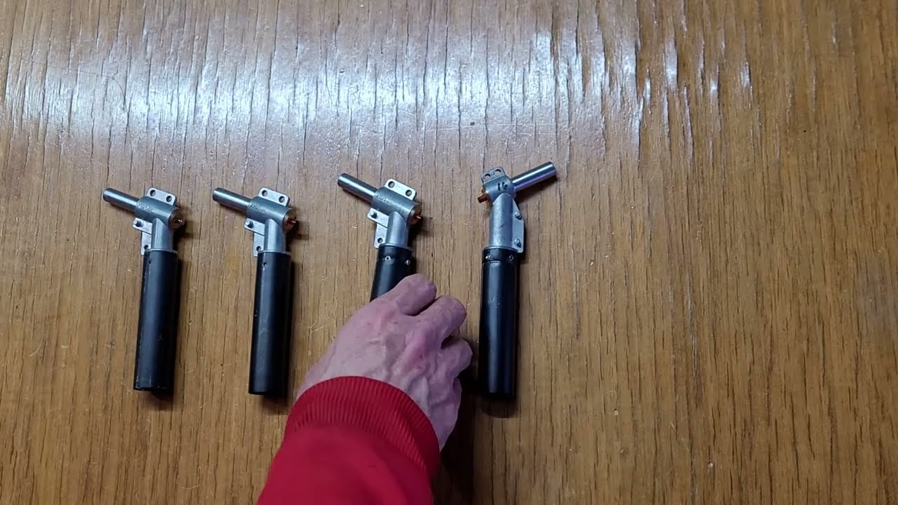

            EDIT: The following information isn't 100% correct. See post #7 for more information.
            My guess is that it has something to do with the black steel tube that acts as the cartridge housing, and is pressurized, coming unthreaded from the aluminum upper valve. This is a not unheard of problem that happened with the early valves that just used two little dimples to prevent the tube from unthreading. If you try removing the cap with a cartridge that still has significant pressure, you can easily pop those dimples out, and end up unthreading the steel tube from the aluminum upper valve. Over time you could even unthread it enough that it finally breaks free and rockets into your hand when piercing a new cartridge.
            There is information out there (my Google-fu is weak right now, and I can't seem to find it again) on how people were fixing this with screws to prevent it from unthreading. It happened to our friend, Tyler/Fat Rambo, and we just red loctited the tube back in place. Umarex has known this was a problem for a while, as they released a new valve a while back with a much larger crimped area. It's a design flaw, but chances are that if you don't do something stupid, it will never happen to you.
            Old valve:
            New valve (this is actually an HDR68 valve, but the design remains the same with the new HDR50/TR50 valves):
            I can haz feedback?
            • William the Third
              I do cocaine!
              • 1140
              • WNC
              Found it!
              Apparently it's actually the later crimped valves that are failing. From what it sounds like, in the pursuit of cheapness I'm sure, is the later ones aren't even threaded on, just crimped on. Over time the pressure causes the crimps to fail and turns the black steel tube into a rocket.
              More valve info.

                • COB
                  COB commented
                  This is why there was a safety talk before the game. The original steel tube was threaded and loctite in place. Gen 2 steel tube was pressed, loctite and crimped. Gen 3 is back to Gen 1 threaded, loctitie and dimpled.
                  If you over tighten the cap with the Allen wrench, or try to remove the cap under pressure, you will break the seal of the loctite and the crimp. The cylinder will leak at best and blow completely off the bottom of the marker at worst. We had this happen at the field. I am surprised at how long it has taken for the recall to be issued.
