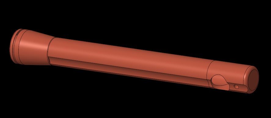

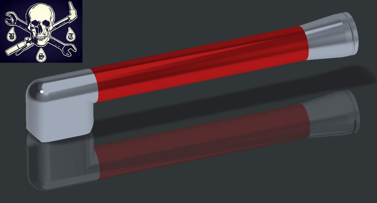

    Am I missing something or is there zero shape to this thing to keep it straight? Is it held in only by the screw?
      Looking at the rendering it looks that way. This may move around a lot if it’s bottom Profile is not keyed into the body like the other Stock class feeds. That’s a good point.
  • __Z__
    • 165

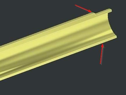

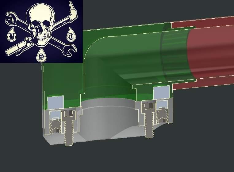

    It's keyed as a factory one or mongo feed would be, I have the model shaded not showing edges, therefore you cannot see the U channel that runs along the bottom.
    The easiest way to tell is using the section view here at the back. You would see an edge on the bottom as well as the top if the tube was perfectly circular. You can also see the different in material thickness between the top and bottom of the tube.
    Little faith guys, a little faith

      #18
      I’ll take your word for it...but it simply is not visible in any of your pictures.
      • __Z__
        • 165
        #19
        Ask and you shall receive.

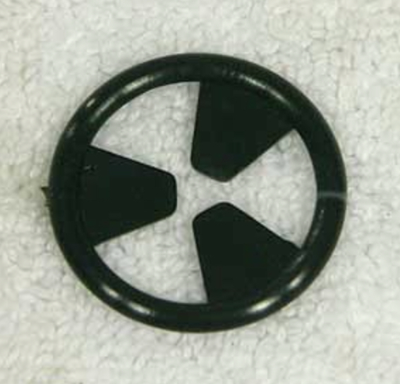

                  Aluminum feed gates are cool. Any way you can design them so the take the regular sock lock style feed gates. I don’t like the Oring retention design. I don’t see that oring lasting long and I don’t want to have to concentrate on reloading. I would buy multiple gates if they took the standard CCI style speed feed.
                  • __Z__
                    • 165
                    #27
                    Chuck, have you watched my video?
                    From the testing I've done between a typical gate and the oring, the oring imo is much easier.
                    As for gates using the typical gate, there's no current plan to run any, but we'll see what happens. I plan to continue to run more feeds, so it's a possibility.
                      Yeah I don’t load like that tho. I just push a tube in the feed never had to think about what angle I load at. Sharp edges on the 10 round tubes I don’t see that oring lasting long. Yeah it’s easy to replace but I see it being a wear item and it doesn’t improve on the original design, Other then the ability to anodize it. I have 15+ year old phantoms that still use the same feed gate. Looking at the old gate you can see it takes a beating.
                      What’s the benefit or reason you went with an oring. Is there a copyright on a feed gate? Machine time? Or is it sourcing the gate itself? Because you can design them around Sock Locks that have a slightly different dimension then the CCI gate. You can buy packs of them dirt cheap and they come in a variety of cool colors. Adding even more custom options while still keeping cost down. (24 of them are $2)
                      Wouldn’t be cheaper and easier to just add a small grove in the inside for the gate retention? Then the cut threw and radius on the outside.
                      I like the idea of the aluminum feed gates so I we can Ano match them to our custom builds. But the original design works flawlessly. Why change it?

                    In all honesty I was just trying to come up with something different to try. Designing something to use a sock lock would have been plenty easy enough.
                    I honestly prefer this, and am not a fan of the standard style gates. That being said I don't have much play time on mine. Maybe guys will love them, maybe they won't, time will tell lol.
