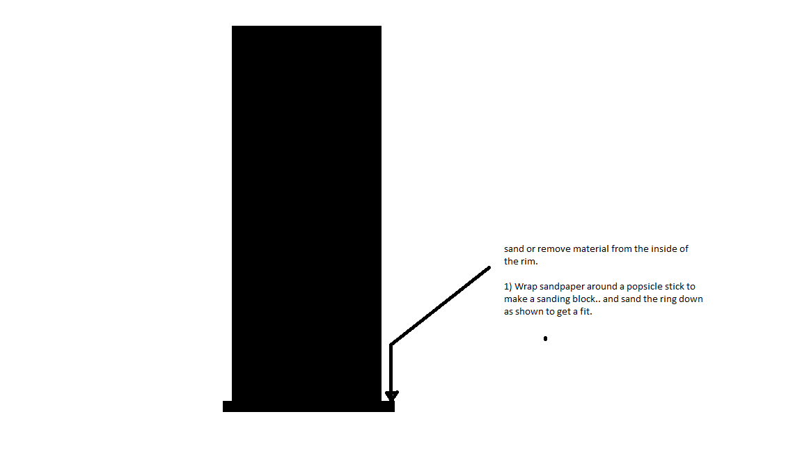

    Figure I'd open this up if anyone has troubles with their stuff. Shipping has been slow sorry about that, but there may be some fitment issues as sizes I was given for the 'rim' were not exact.
    If you have any issues PM or post I guess.
    There is 1mm rim space in the HAVOC (mine has 3mm ugh stupid Metadyne had to chance it)... so my rim is 1mm, but this may be too thick!!! If it is too thick, it can be sanded down. The rim isn't even really necessary, the TAPE is supposed to do the full friction hold.
    IF you have a rim problem PM me. I'm trying to get this sorted and may offer replacements once I get the proper sizing. It should be an easy fix to just sand it down a bit tho! (wear safety gloves if using knives).

            Weekendballer sums up my concern.. On the breech kit, female end, the inset is extruded in only to a depth of 1mm to accept the male end. On my old Gen1, it is extruded 3-4mm I can't remember, which provided ample room for a "rim" for DIY shells. The newer breech kits do not have ample room. I guess it saves a machining operation.
