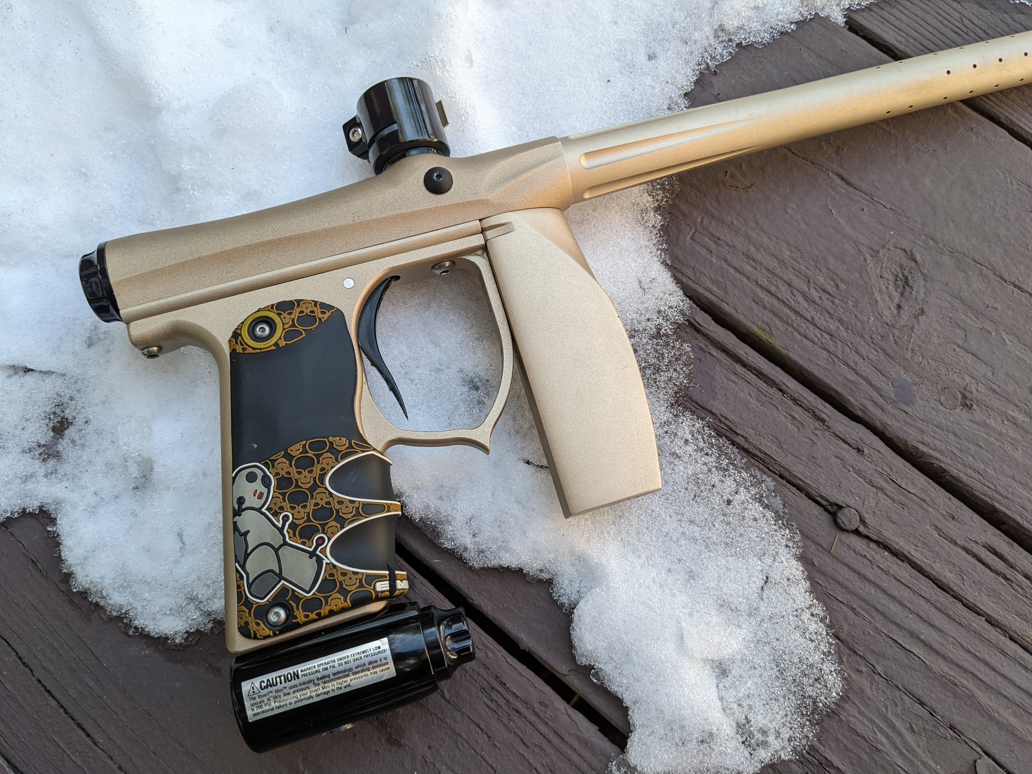

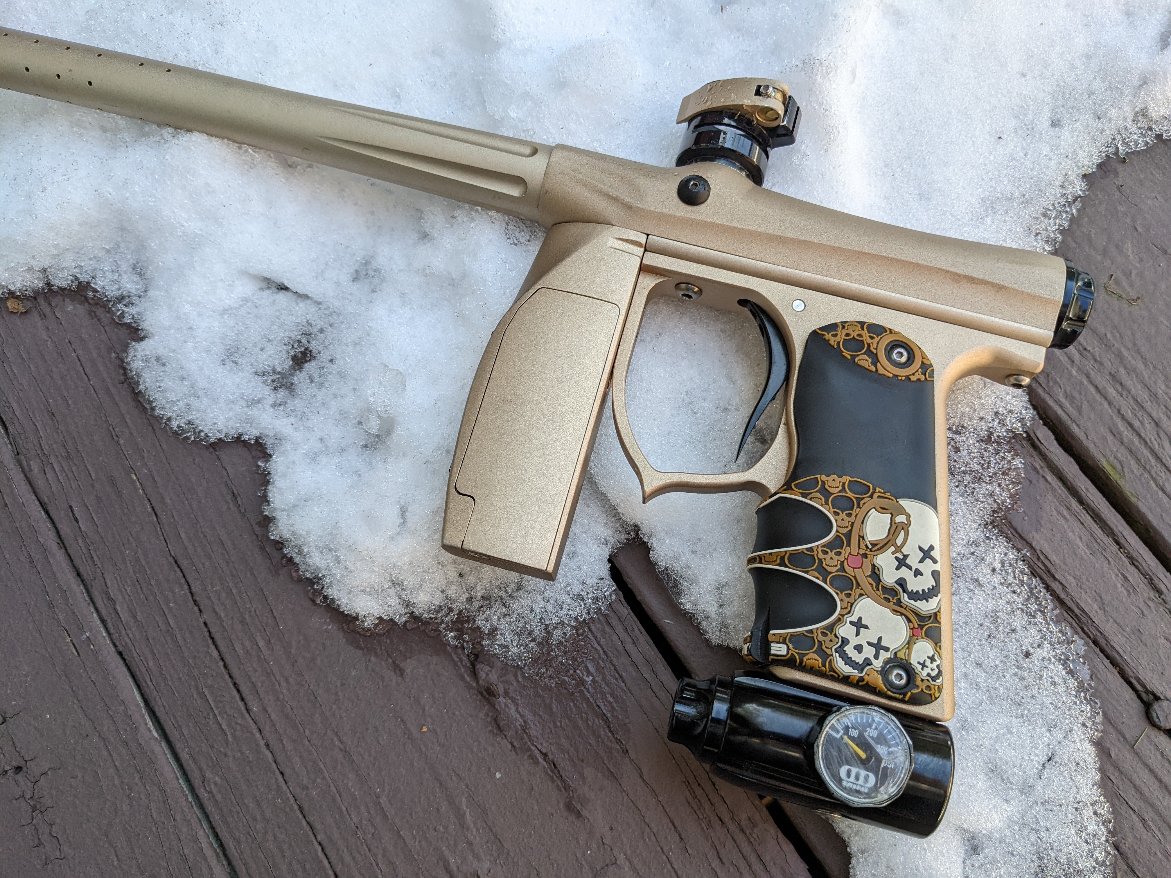

    I have an Invert Mini in fantastic shape for sale/trade. Sadly the poor girls trigger isn't activating. I believe it will need a new sensor board (the upper one). It will also need set screws for the ASA. They are a bit of a chunkier thread and I don't have any in that style. The gauge is also cracked. Otherwise this is untested. Internally it's also very clean and in great shape.

    Almost 100% of the time this is a result of the magnet in the trigger coming unglued and 'flipping' attached to the other side. I have had this happen with two of mine. Easy to check and fix. That is a nice example and great price.

      I will check that, thanks!

      I will second this magnet theory

        The setscrews are 10-24, if you're looking for them.

            The magnets appear to be OK to me.
