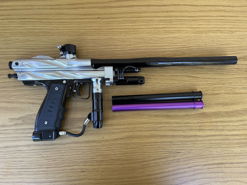

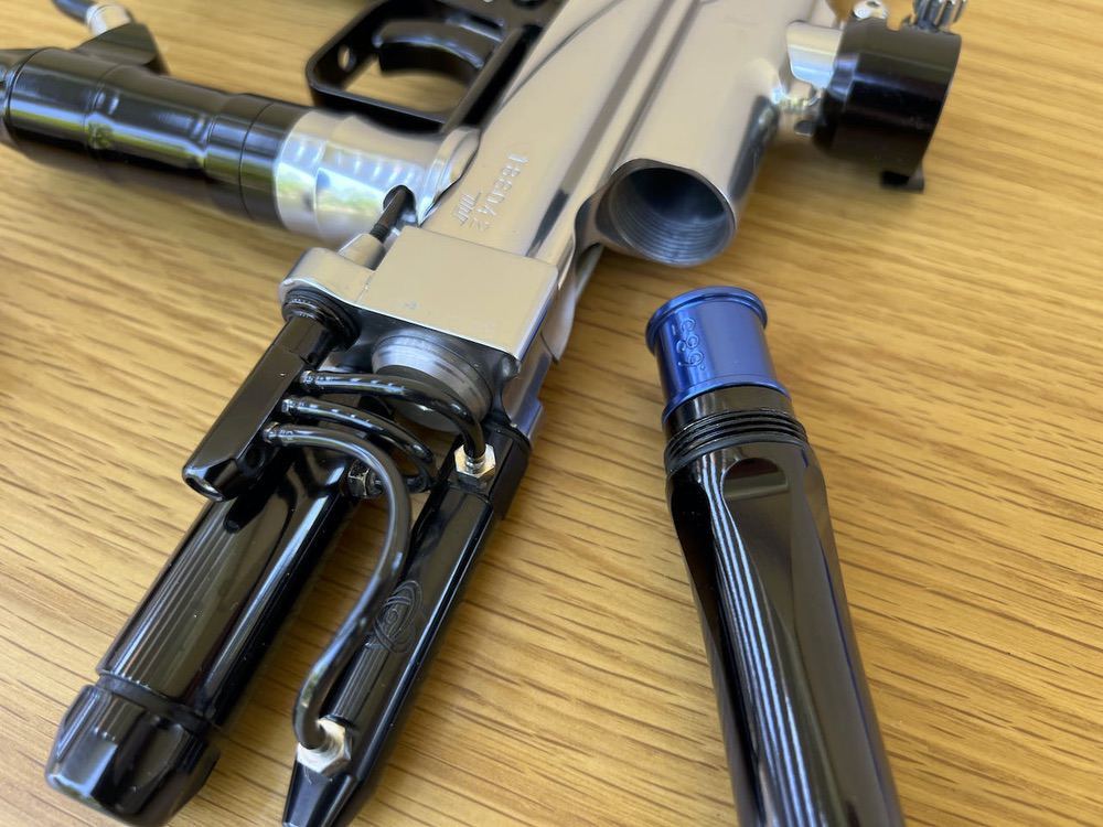

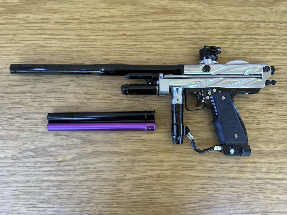

    I am selling my Modified Prostock autococker with inception parts. This body was milled to accept empire feedencks and Merlin Banjos - still uses 9/16 valves. The increased chamber size dropped the operating pressure to 190PSI @275fps and @202 at 300FPS. Shoots smooth like butter!
    Asking $1k shipped
    • Prostock body
    • inception pneumatics
    • Inception feedneck - new
    • inception v3 HPR - new
    • inception ASA
    • Inception slide frame
    • AKA merlin banjo w/o spring perch - new
    • Freeflow pump arm
    • Inception cocking rod
    • Inception bolt and pin - new
    • Inception lower tube
    • Inception PWR barrel
    • Eclipse PWR inserts .693,.689, .685
    Condition is used. Inspect pictures for condition. Ships USPS priority.

    I've been thinking about the merlin banjo since i saw your post the other day. That came out nice.

      superman Hellion360 .830 diameter .055 deep. is a good place to start. I think the front of the block should be a little deeper maybe .063 if you want to have your rams seat all the way. The AKA banjo and some rams will interfere with each other. Or round out your banjo to add extra room like the CCM banjo on the pink 99 STO I posted. Honestly there is not much benefit, more of a novelty, I did get a little better consistency when shooting fast (Standard deviation calculated by virtue clock 66) and it changed the sound signature. Maybe I can do a side by side with a standard Prostock and this one.
