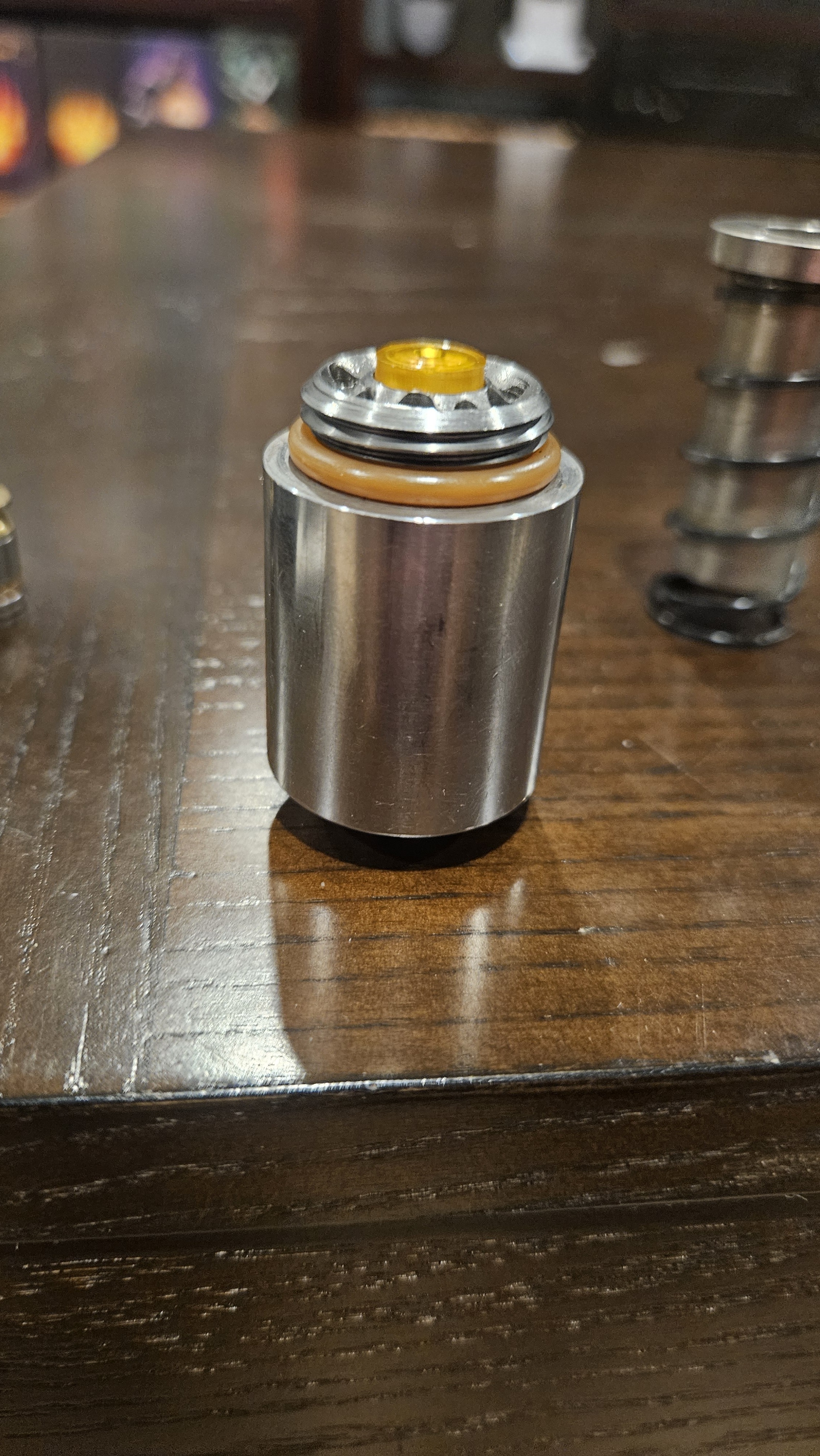

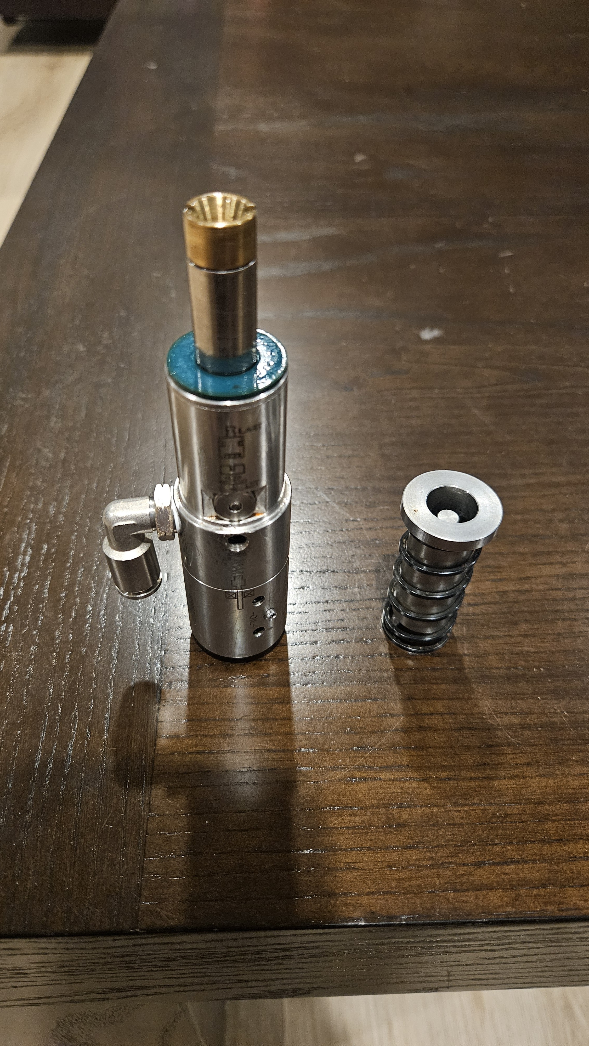

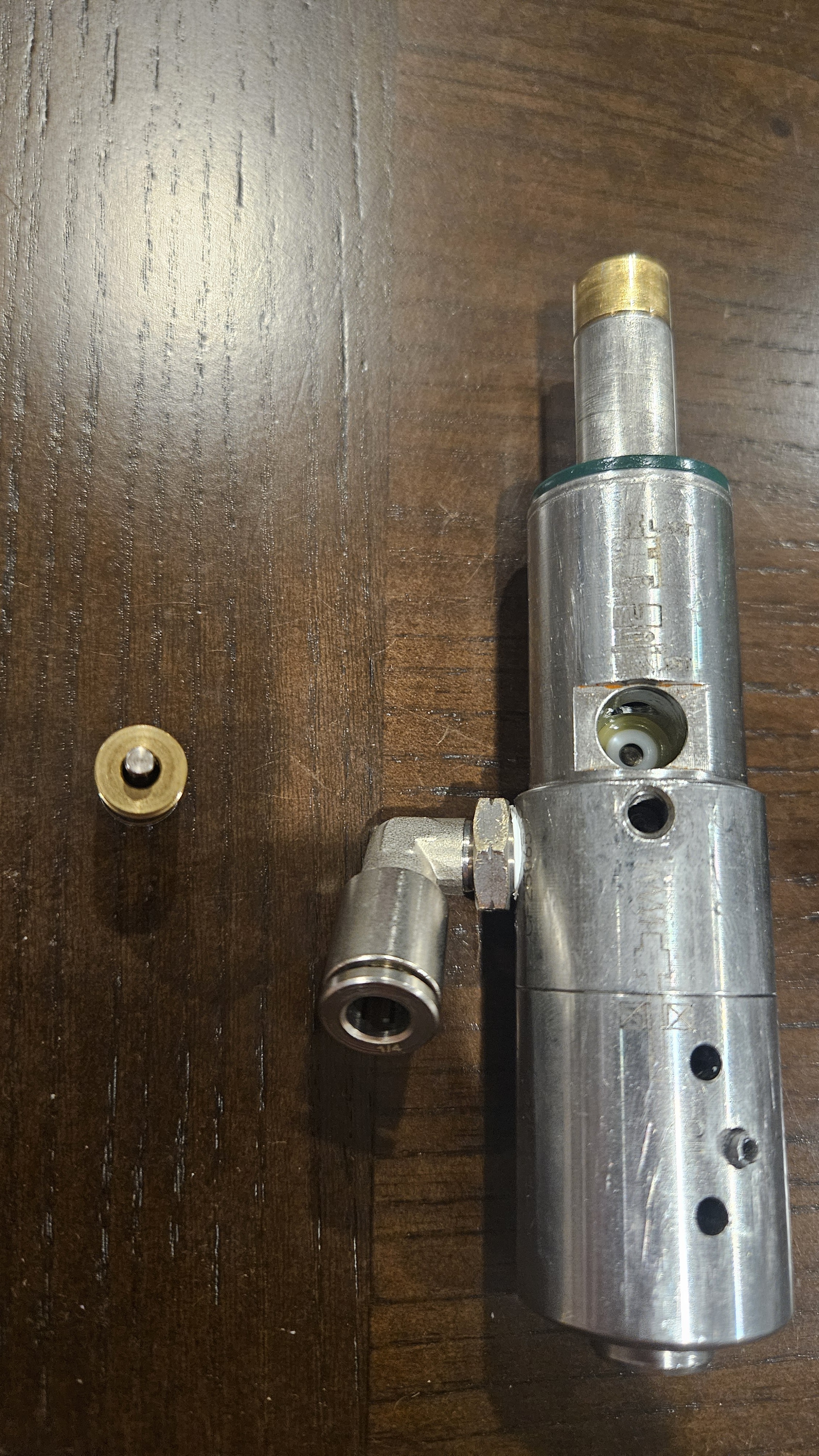

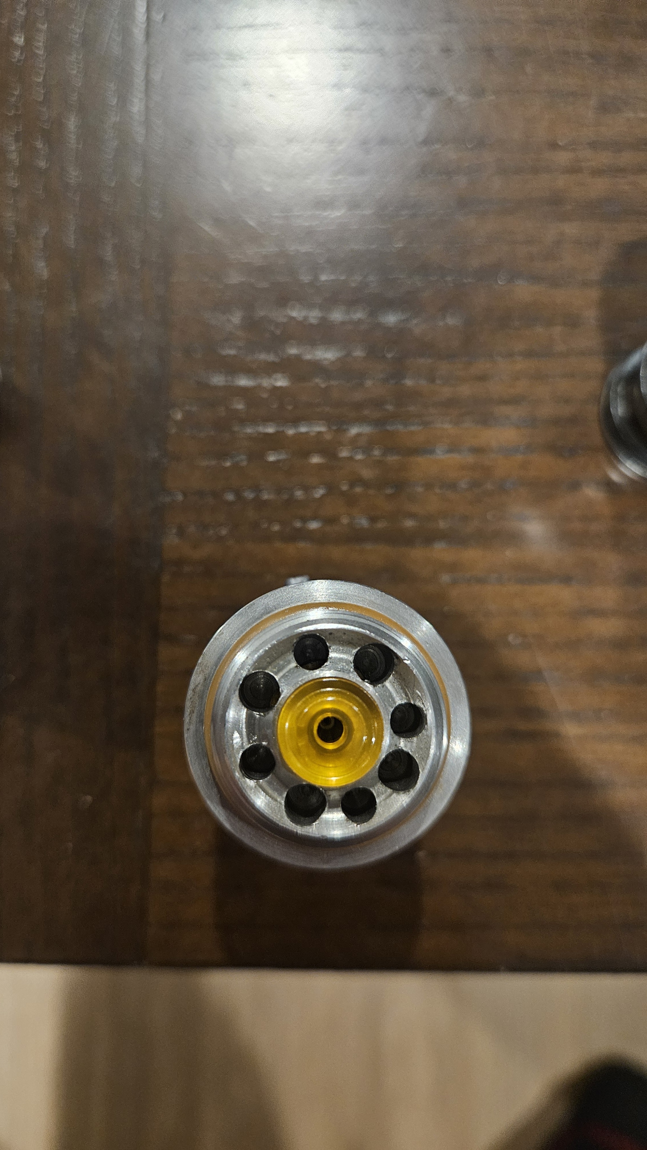

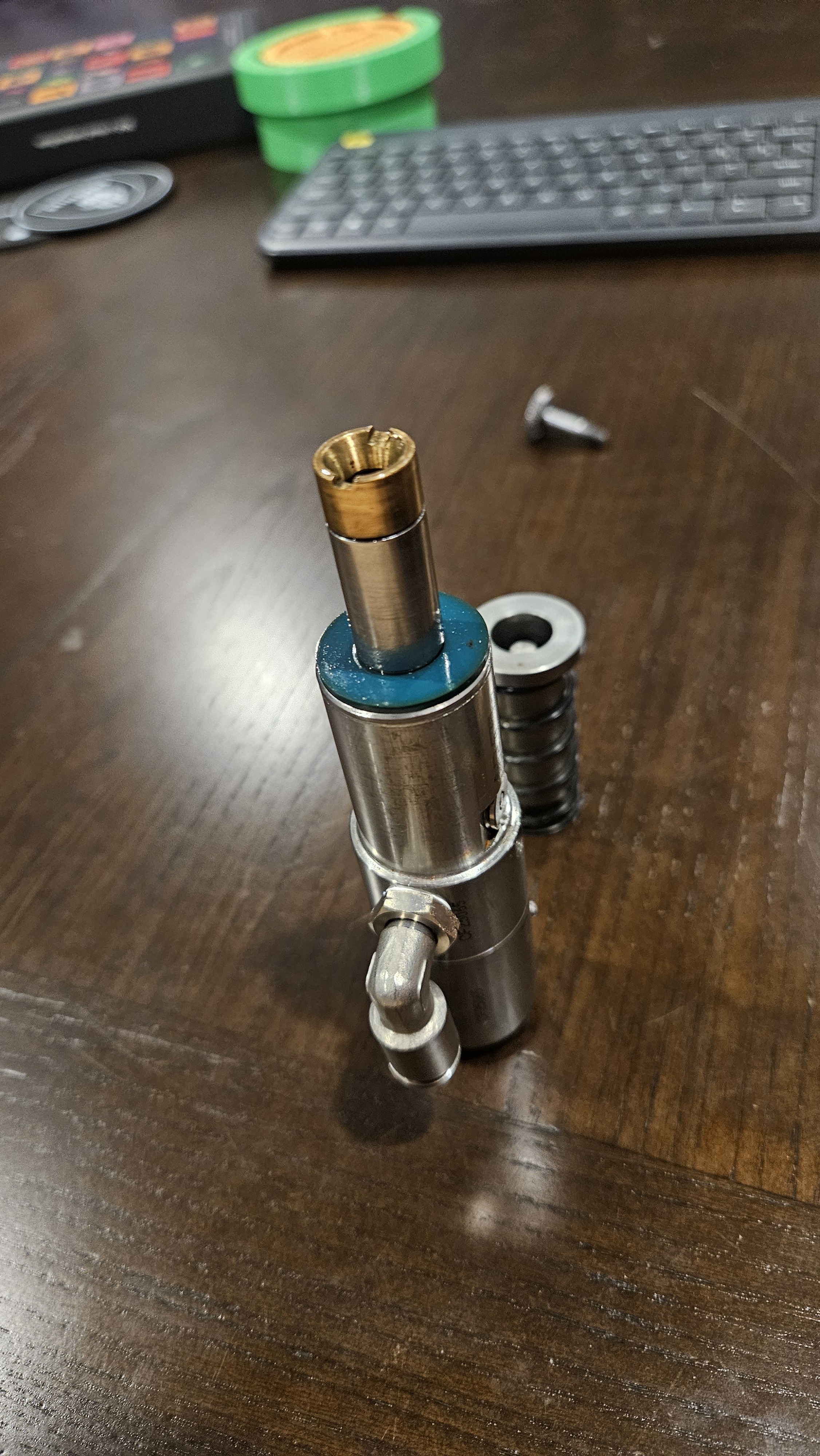

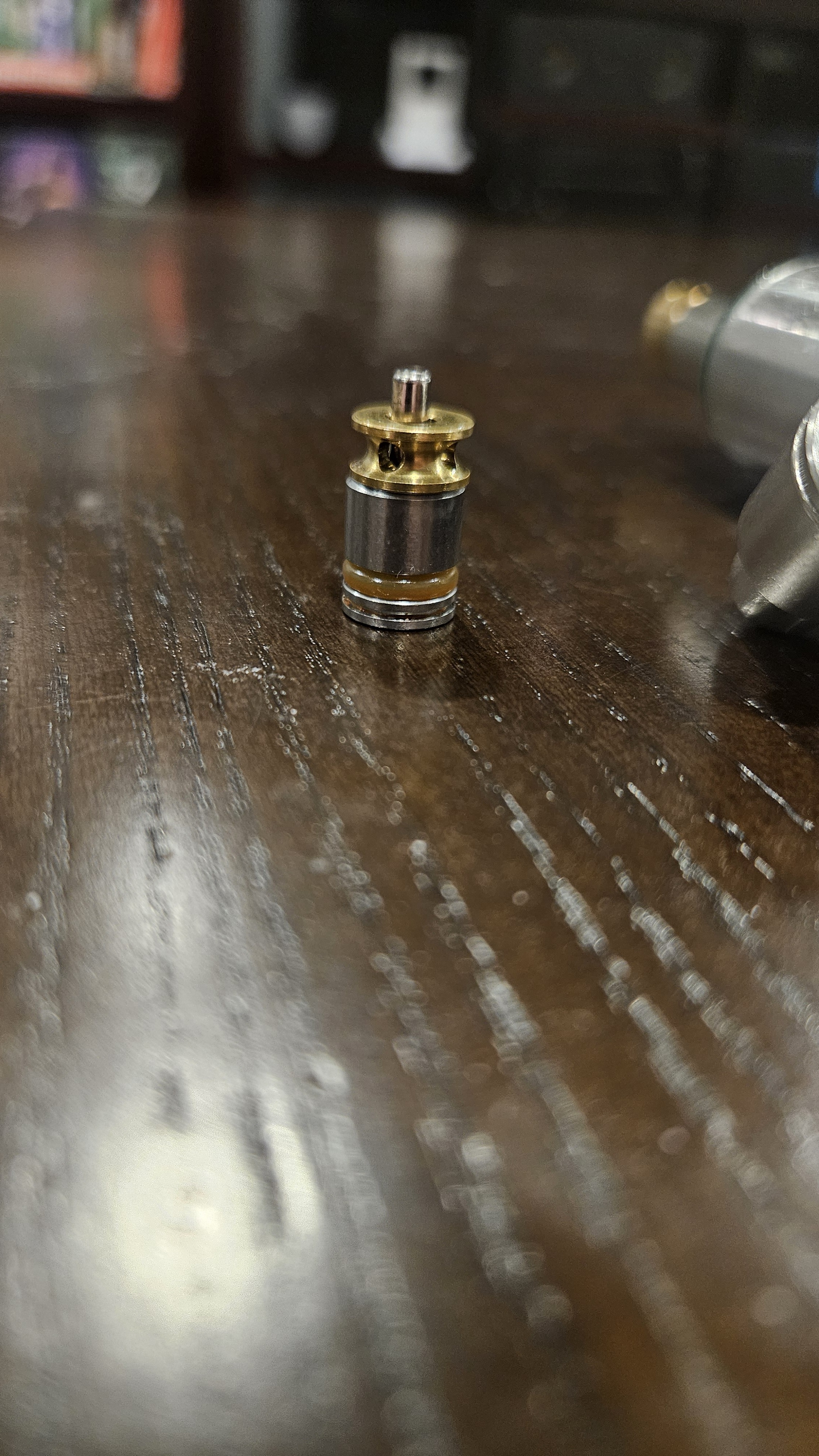

            Some pictures of the valve for more clarity. Everything looks well oiled and in decent shape to my untrained eye.

              Looks like a home brew 8 hole 🕳️ mod

                Care to fill a mag rookie in on what that is? Good? Bad?
              • F1FX
                F1FX commented
                Standard automag valve back end only has 1 hole, where yours has 8. Some claimed the 8 hole mode provided better air flow, some say just marketing gimmick and provides no benefit.
              • swagzy
                swagzy commented
                Ah I now see why it's called the 8 hole mod

              Powertube brass end piece looks like it is not fully tightened. That could be the source of your leak. Also O-rings looks fairly aged, valve would benefit from a rebuild.
              • swagzy
                swagzy commented
                I appreciate that feedback. I'll look into getting a rebuild kit to either include or install. Thanks!
