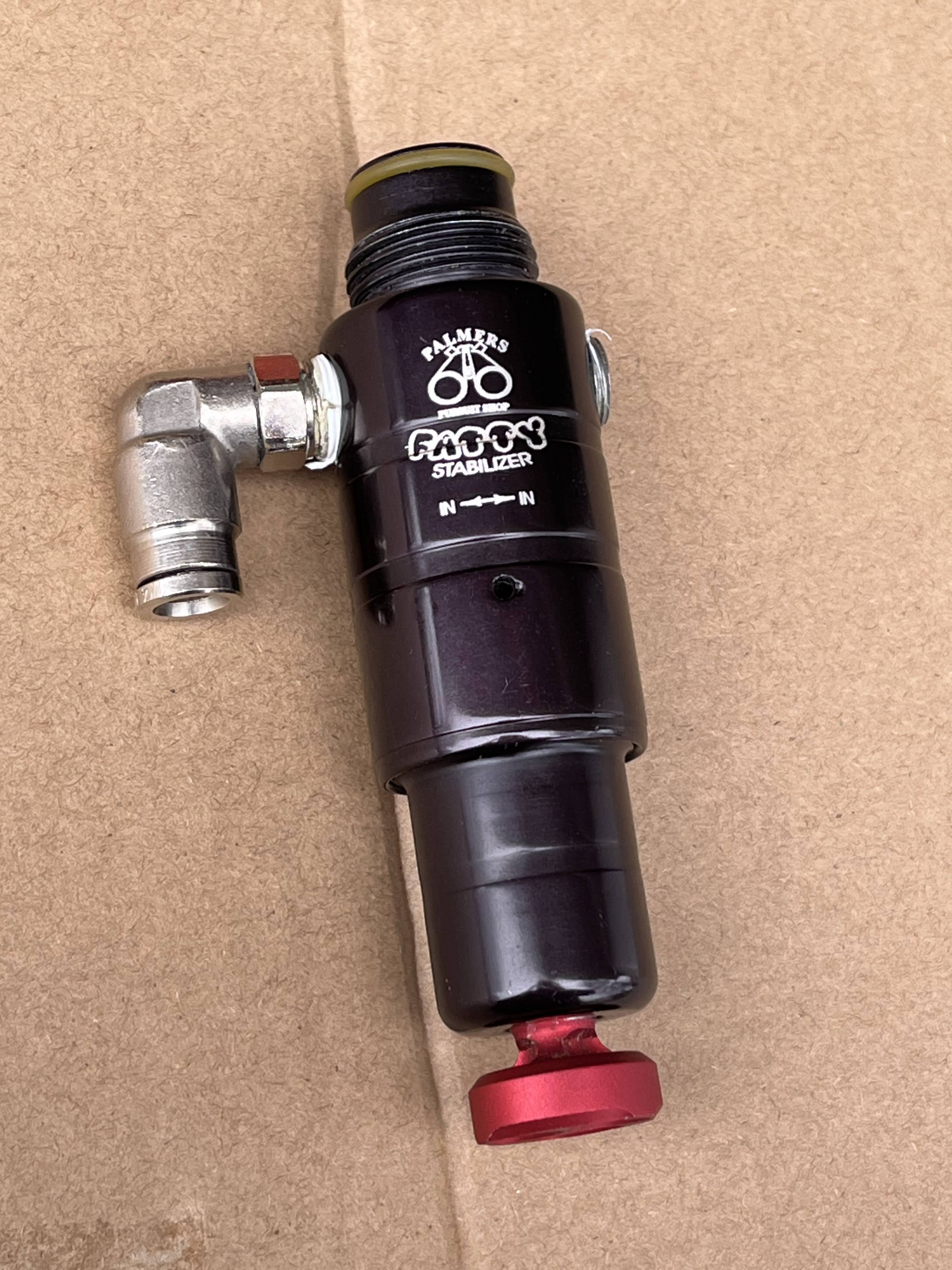

    Palmer's Fatty Stabilizer
    $80 shipped. Great shape. SOLD
    This has the low-pressure spring inside. It can go up to about 180 psi with the thumb screw. I seem to recall the low pressure kit maxes out around 400 psi, but the thumb screw won't go in that far. You'll have to replace it with a 3/4" long 3/8-24 set screw.

    There's a trick to getting a little more adjustment on these.
    you take off the bottom of the reg and add a couple shims between the disk and the spring.
    Hint hint: it's the size of a penny.
    It'll still top out at 400 but you won't have to bottom out the screw.

      the LP kit with the green piston is 0-200psi
      The pre-built LP fatty is 0-400psi
      just incase it was converted and you were expecting the 400, I had this happen once.

        Thanks for the info. This was pre-built. I ordered it from Palmer's for a pneumag build.
