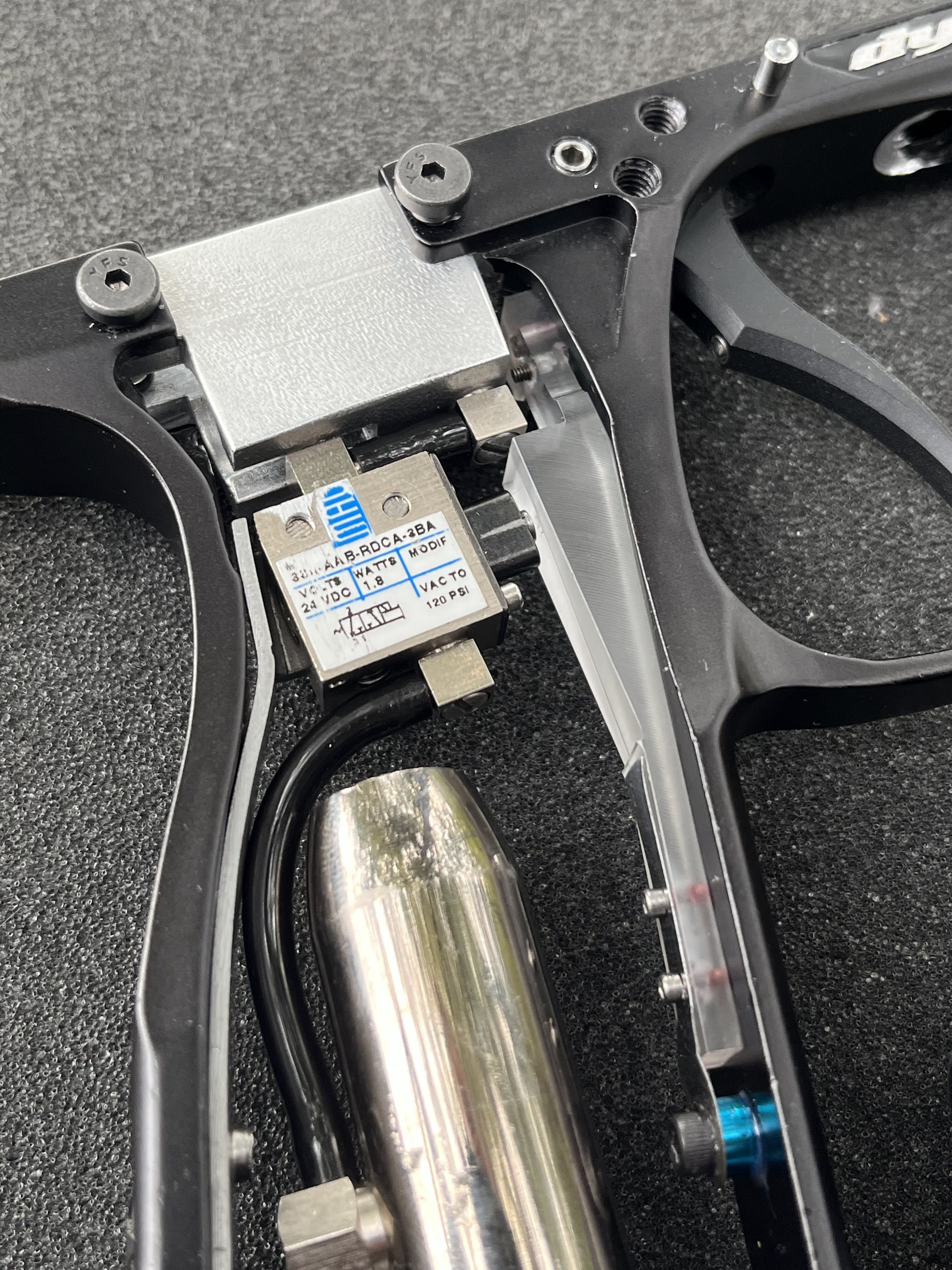

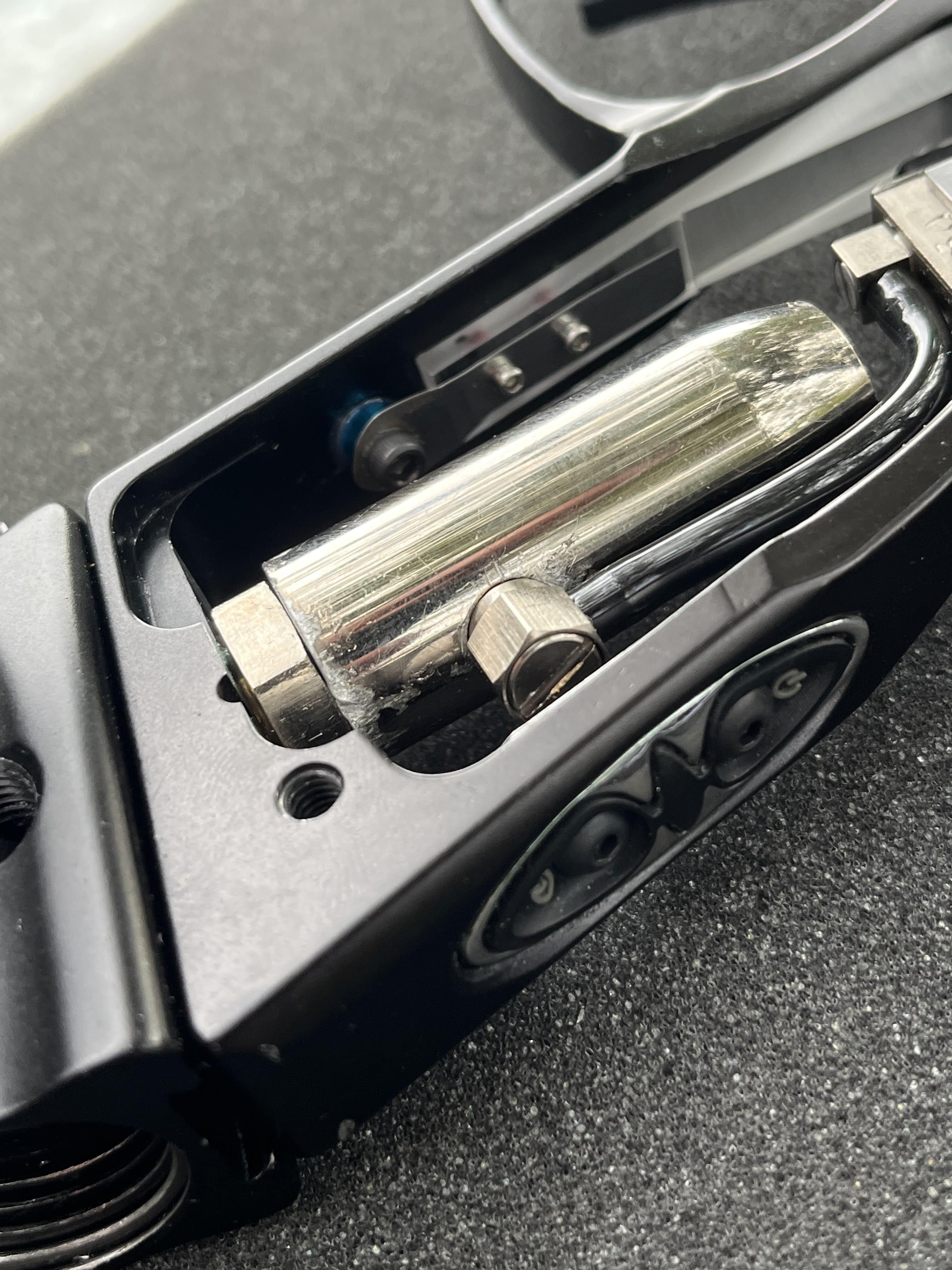

    It’s been a while since I’ve made one of these, but I'm glad I finally got around to this particular frame. I've been saving this PM5 frame for, oh...about 8 years now. As far as I know, no one has ever made a pneumag frame from one of these, and for good reason. Most of the design choices in this frame should be familiar to those of you who follow my work, but this frame need a few additional special parts, more than any other Dye frame that I've done before. There’s a valve bracket behind the LPR that screws in through the button holes on the back of the frame, and there’s an acrylic “swing arm” between the trigger and the valve. It look a long time to finish this one, but it's finally ready for a new home.

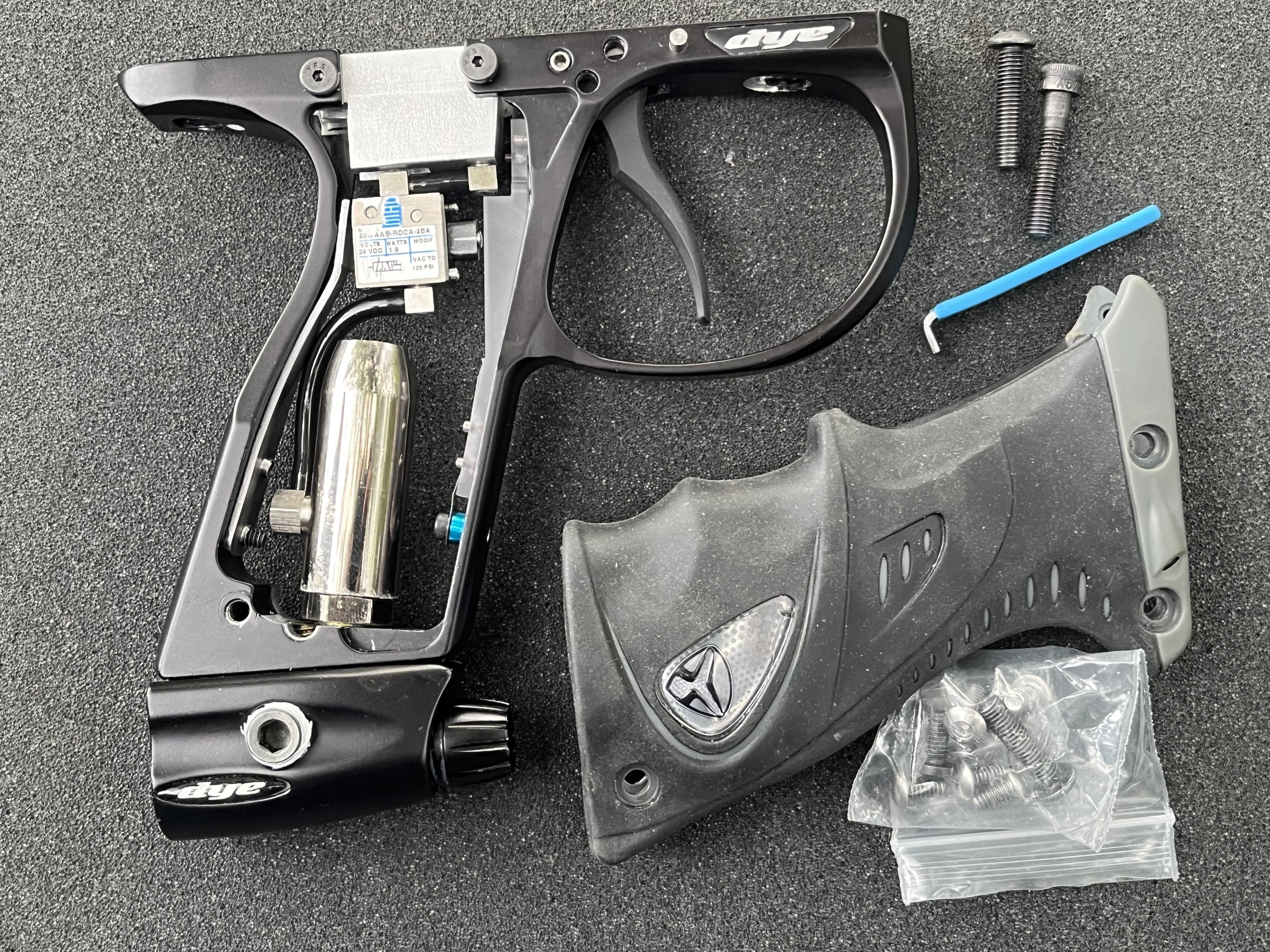

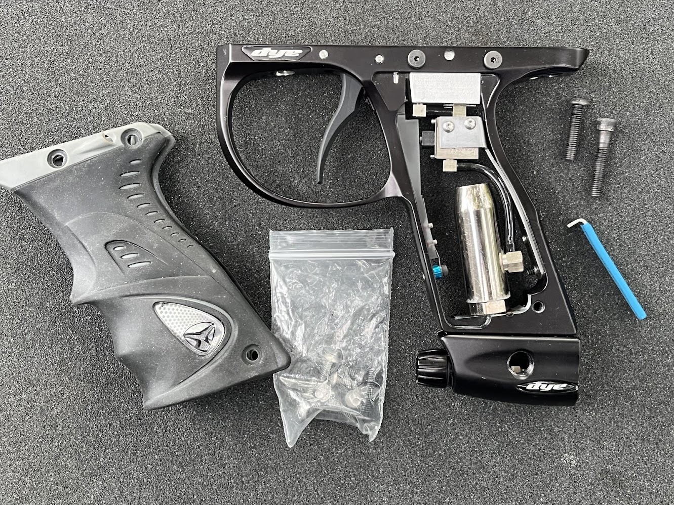

    Other side.
    Close up upper interior. Best view of acrylic swing arm.
    Close up bottom interior.

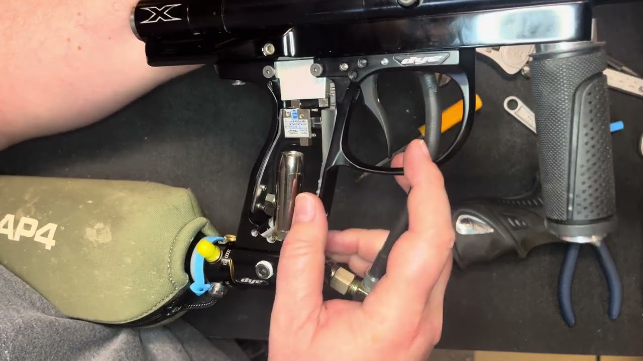

    Testing rig.
    Back view, included grip bulge.

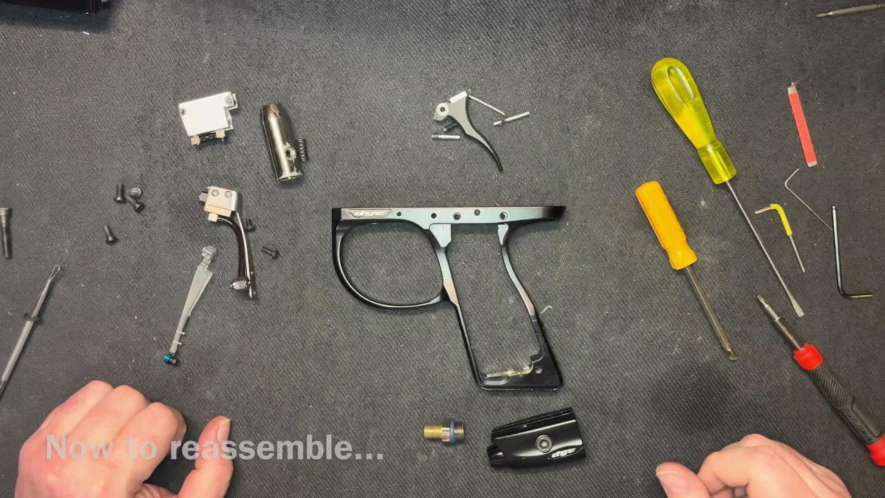

                  Thanks to some replies on a thread I started about the grip issue, I learned this week that the grips I have for this frame are just old and warped. If you buy new grips, they should fit much better. I happen to have a pair of new grips that came with a Dye DFF Autococker frame that I bought recently. I didn't even think before to check out the fit because I thought all grips were the same. So, I swapped them over and what do you know? They fit great.
                  https://photos.app.goo.gl/KKEx8Yun9o1DqDqo9
                  To be clear, these new grips do NOT come with the PM5 frame I'm selling. But I'm going to drop the price a bit so you can buy some new grips for yourself. You will have to mod the grips slightly to get them to fit right. You will either have to enlarge the screw holes or trim the top of the grips so they clear the Automag rail. But that's easy to do and I can walk you through it.
