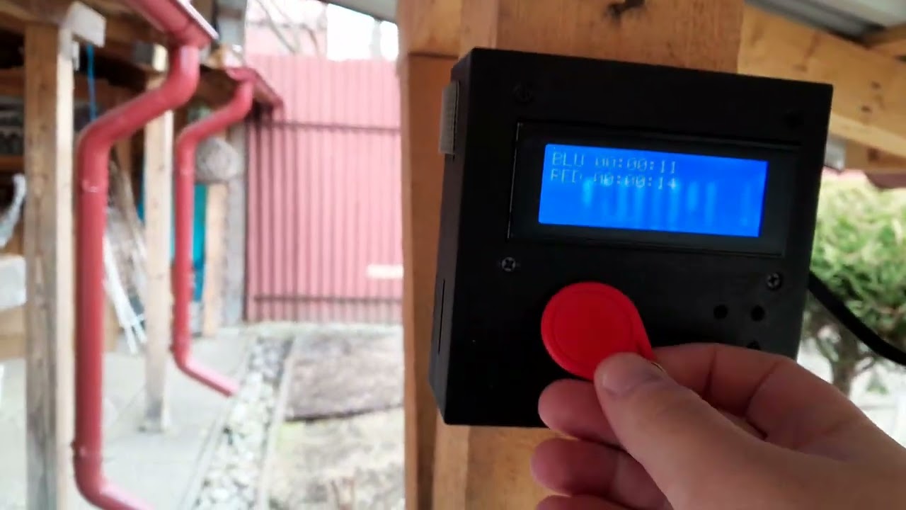

    Dear all, I would like to offer the following.
    During last few year I was developing a Domination Timer device, that is suitable for Paintball events, especially for Domination or Capture the Point game mode.
    It is a stopwatch that is counting the total occupancy time per each time. Time is counting per team that already occupied the point, until it is occupied by other team, or until the point will be neutralized. Winner of the game mode is a team that was holding this point for the most time. Team that is actually occupying the point are represented by LED diode on the device aswell. There are 4 LEDs in total, so 4 teams can be used in a single game, but standardly 2 teams are used - RED and BLU. When a team occupy the Domination Timer, there will be beep engaged from the device that informs anybody nearby, there is a significant change on the point. Time is visualised during whole game in real-time on LCD 20x4 character screen.
    Domination Timer itself is a point that can be occupied by a team member, who is trying to hold it as long as possible after successful occupancy.
    Based on version, the point can be occupied using:
    • RFID version - player is able to attach a RFID wristband / card to capture the point

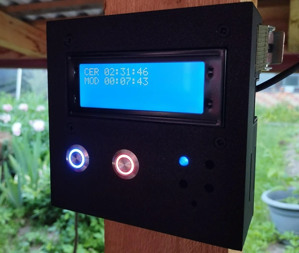

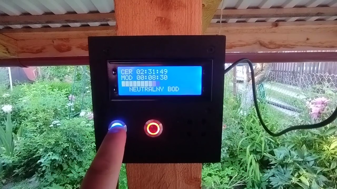

    • Button version - player is able to hold button for a set period of time to capture the point. If he is not holding the button for set amount of time, he needs to do it again. If there is a other team already on point and during occupying, there is button held for more than 50% of time, point will be neutralized, even the occupancy process is not fully finished. Player can see current progress during holding button on LCD screen
    In terms of hardware, for both version there is used identical hardware. In button version, RFID reader is removed and swapped with buttons. Buttons can have separate LED backlight, which is helpful during night events, when buttons are fully visible. By different wirings you can also add other functionalities to the buttons, such as turn on backlight on press, or by software, turn on backlight for a losing team's button...

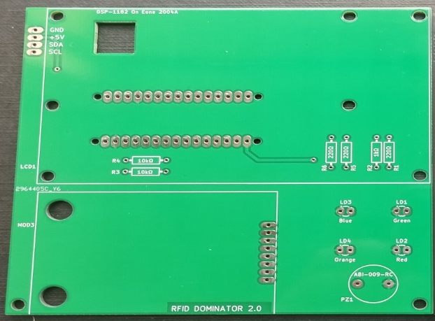

    Domination Timer is based on DIY open-source hardware (Arduino, modules). Also the main components can be used in modular design on the PCB, if pin headers are used. Meaning, these components you can swap without needing to solder anything in seconds. To buy all hardware components, the price is like 10 USD, up to 35 USD depending on where you will get your hardware. Fine is to get all the components from China, Aliexpress. Had no issue with these, also not a lot components are used, easy for soldering and installation to anyone. To mount hardware properly into PCB and 3D printed box, you will need to use a few extra components - M3 screws, nuts, Standoff Spacer Screws such as 10 mm base + 6 mm, 6 mm base + 6 mm.​

    PCB dimensions:
    • 104x103x1,6 mm - FR4 material

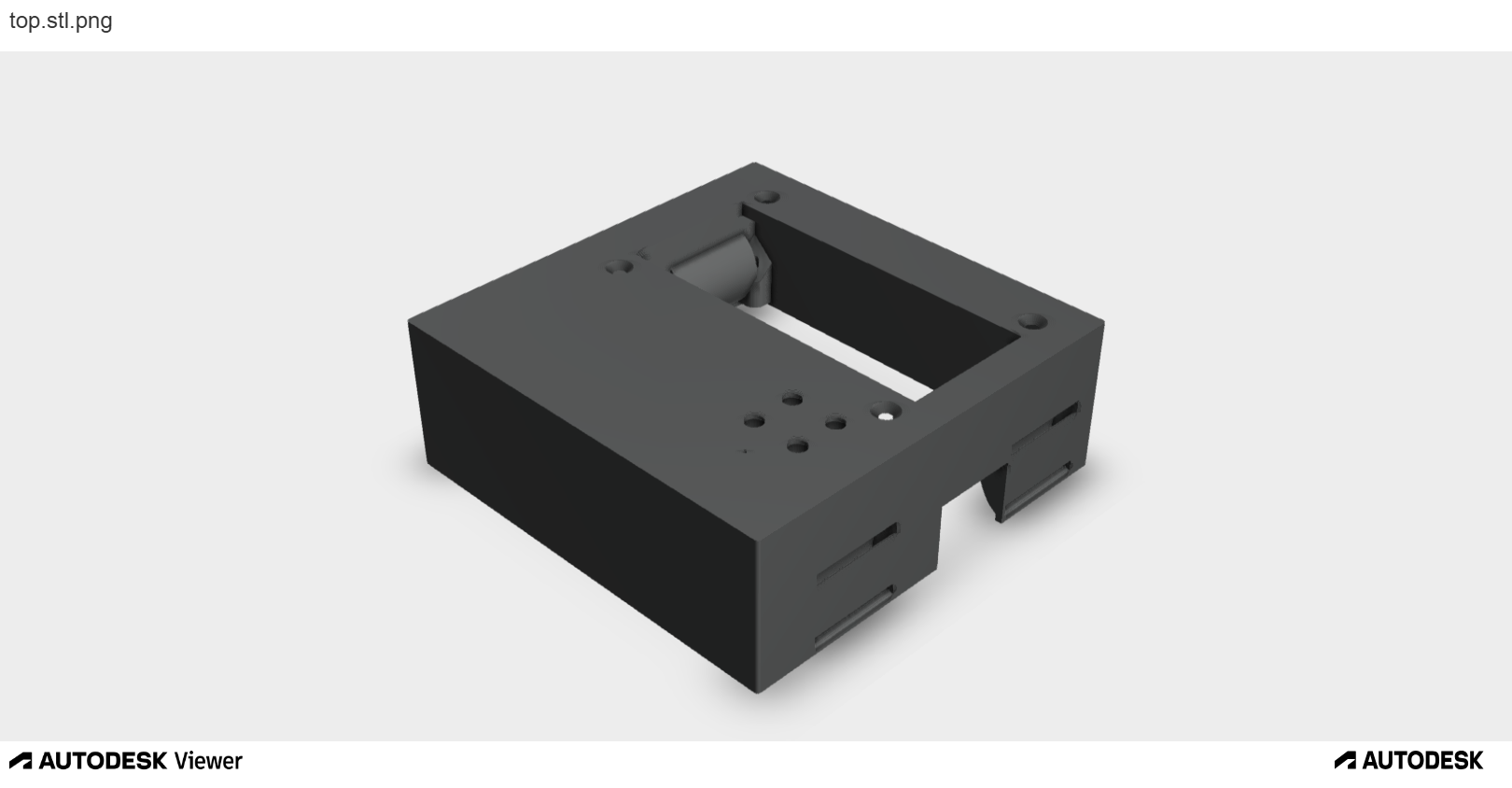

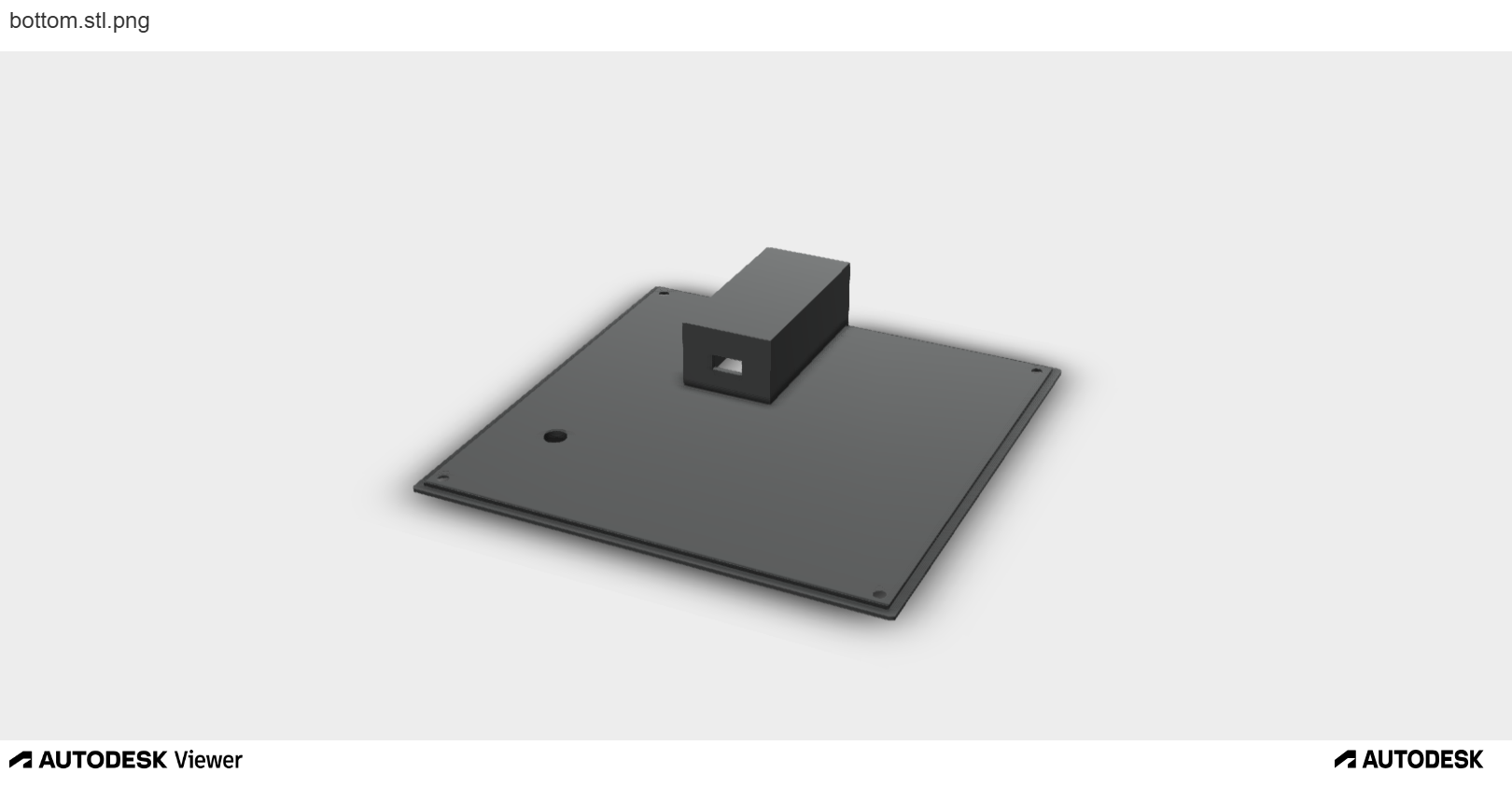

    Device's box dimensions:
    • 124x123x48 mm - ABS / PLA plastic
    • Weight including hardware assembled in it: 300g
    Note: PCB and box has hole in them, which is used for a screwdriver access to a LCD display's contrast trimmer.
    With that trimmer you can adjust contrast related to ambient temperature.

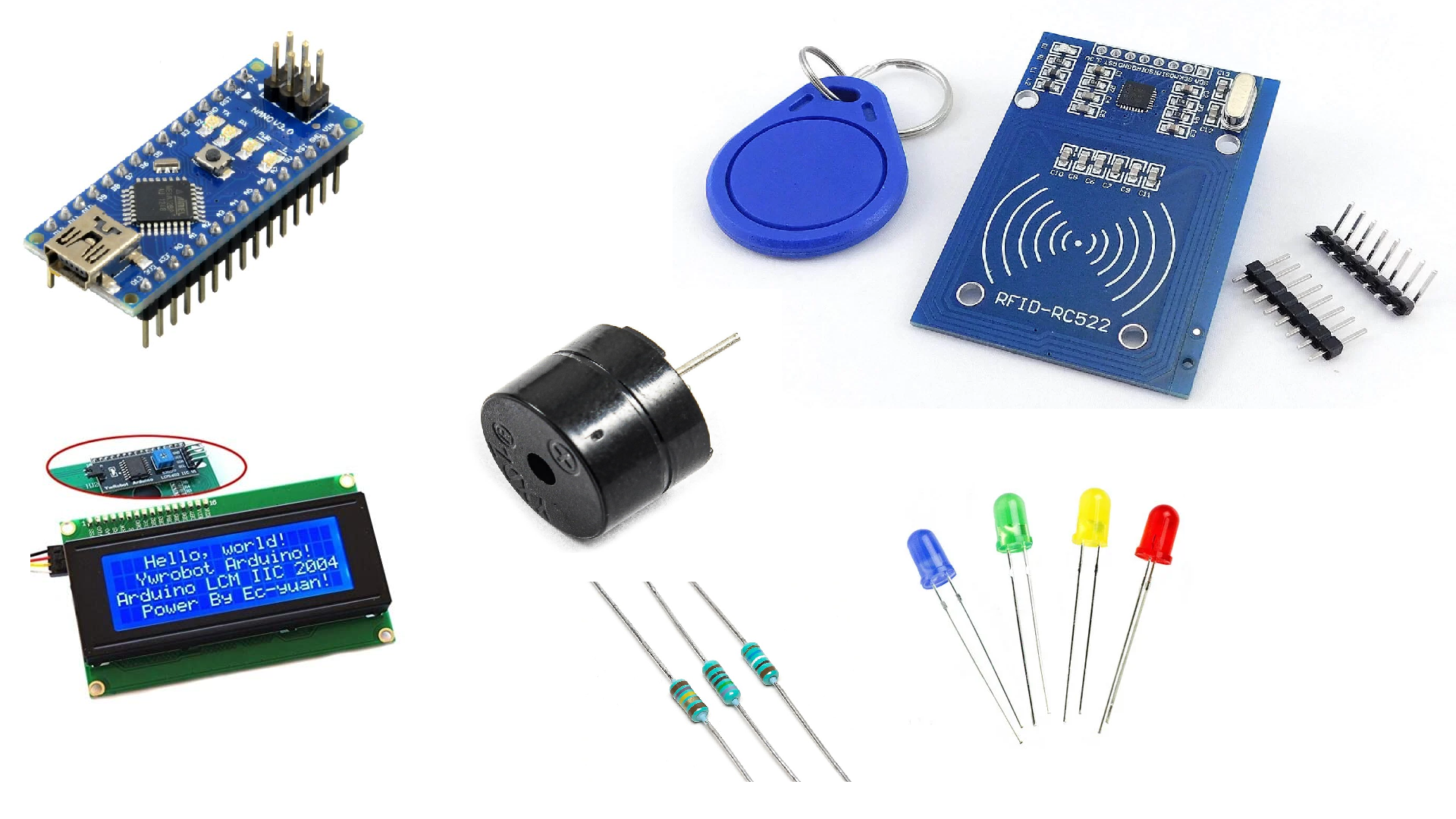

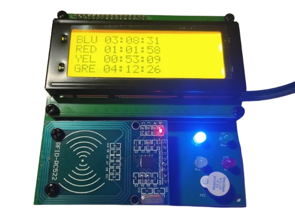

    Full hardware list - RFID version:
    • Arduino Nano
    • RFID RC522 (13.56 MHz)
    • 4x LED 5mm
    • 4x THT resistors 220 up to 1K
    • 5V buzzer with 7,62 mm pitch
    • LCD 20x4 with I2C converter
    • RFID cards, wristbands, keychains with standard ISO/IEC 14443-A
    Full hardware list - Button version:
    • Arduino Nano
    • 2x push buttons (depends on you what type of wiring you would like to use with / without backlight etc)
    • 4x LED 5mm

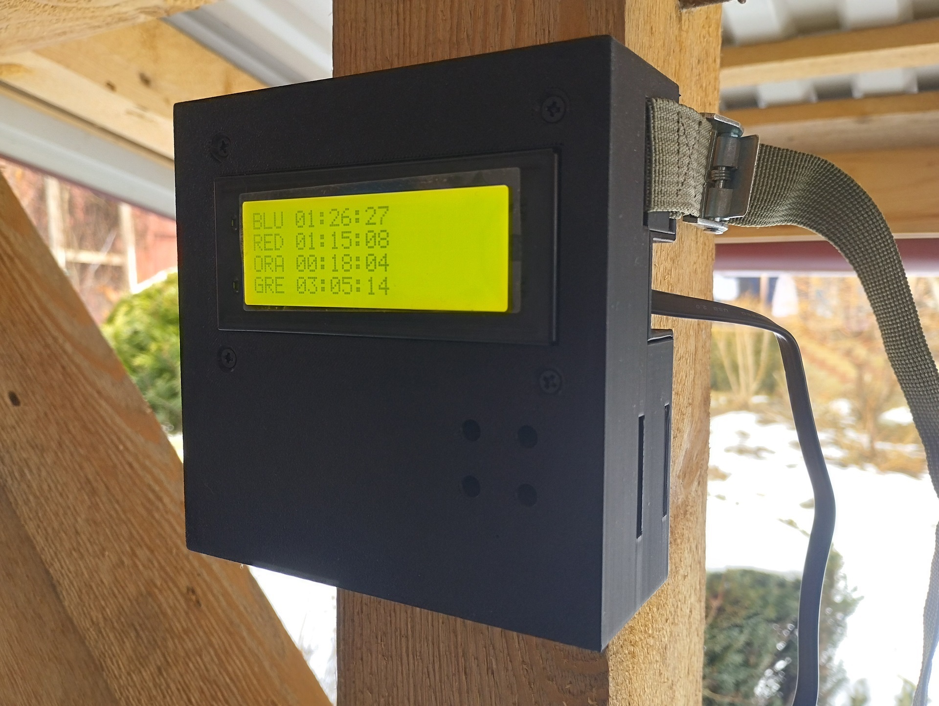

    Device can be mounted on the tree, pipe, joist using trail-camera like belt with locking mechanism. Also, if you will have hardware on hand, it is possible to give you a DEMO version to test before considering buying anything.
    RFID based device:
    Button based device:
