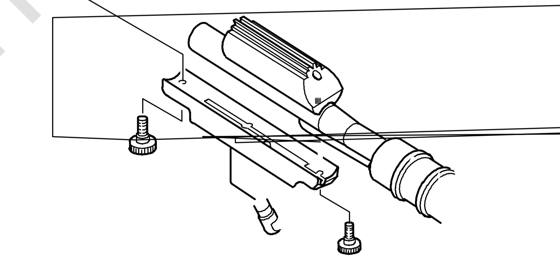

      I've never owned or shot a Phantom, I'm looking at the kit and how does the handle stay on without sliding off forward?
      My Collection
        The upper pump arm keys into the bottom of the bolt. It’s sandwiched between the body and frame held in place by a channel in the frame and the front mounting screw. (Super easy to install two bolts place the pump kit in put the two bolts back go slay electo)

        Chuck...these are the best directions I’ve seen for installing the cocking rod. That last step is critical

        Thanks a bunch, I can't belive I overlooked that cocking rod
          The pump rod theads into the handle and the other end has a 90° bend upward where it rests in the underside of the bolt. The frame has a groove to keep it aligned and from coming undone once it's bolted to the body.

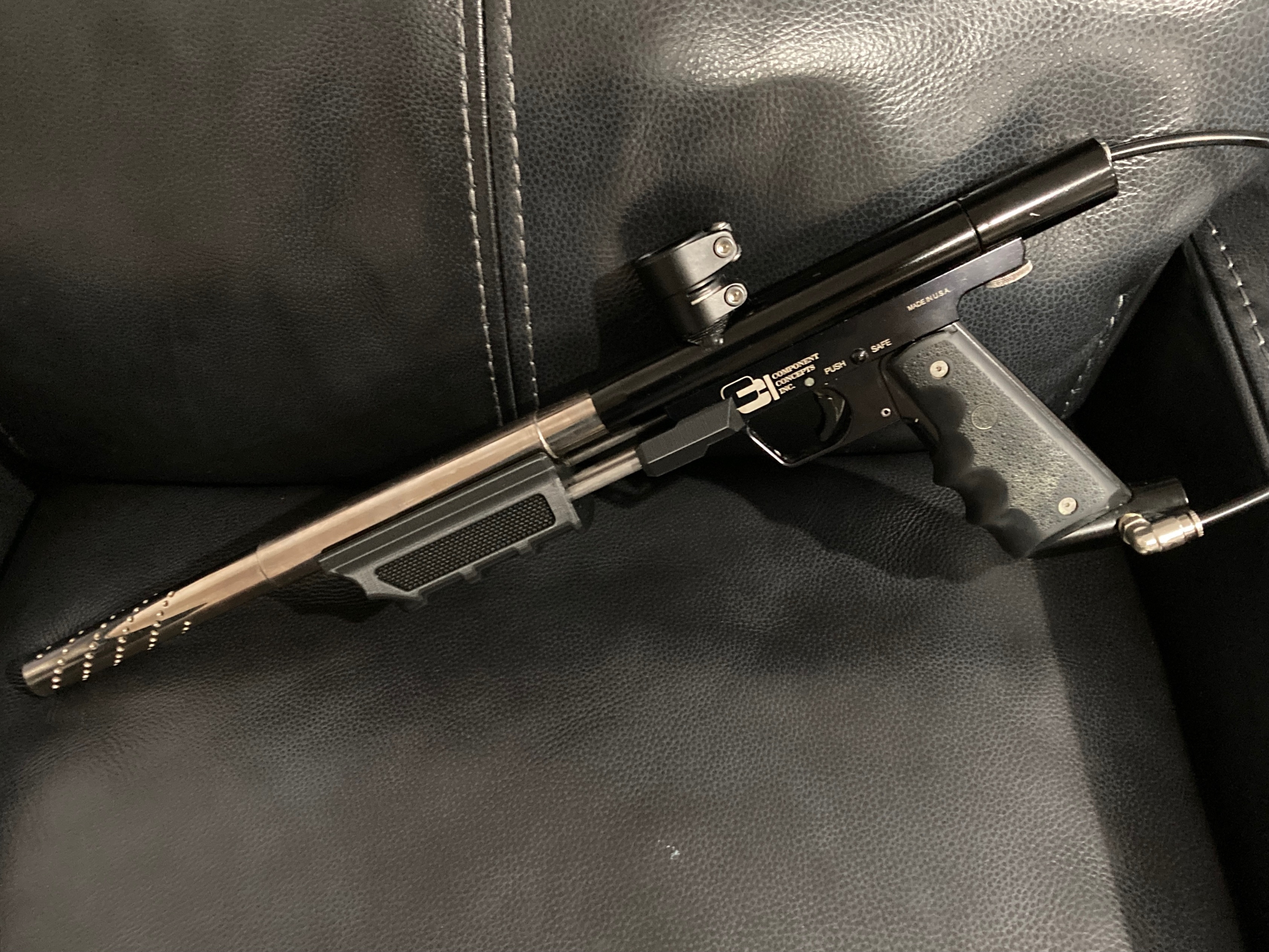

                  #39
                  Well I have tried these out and they are a good product.
                  I haven't shot it too much, but I like it. Not as smooth as the CCI dual rod kit, but for one third the price it is a bargain. I suspect that it will smooth out with further use. I only have a couple hundred shots on it for now.
                  The handle is comfortable, and stable. Rainmaker warned that there might be some noticeable flex. You can flex it by pulling down on the handle, but that is not apparent to me in normal pumping. It feels quite solid.
                  Raimman's included instructions were well thought out and clear. It is a nice touch and I think will be useful to a good portion of the purchasers.

                    Rainmaker commented
                    Thanks for the feedback, good sir! My hope is that the quality exceeds the pricepoint somewhat. Sounds like it's serving well so far. Also, based on your input as well as a couple others, I'm going to try a few things to smooth out the stroke a bit. Looks dang good on that marker though, love the barrel too.
