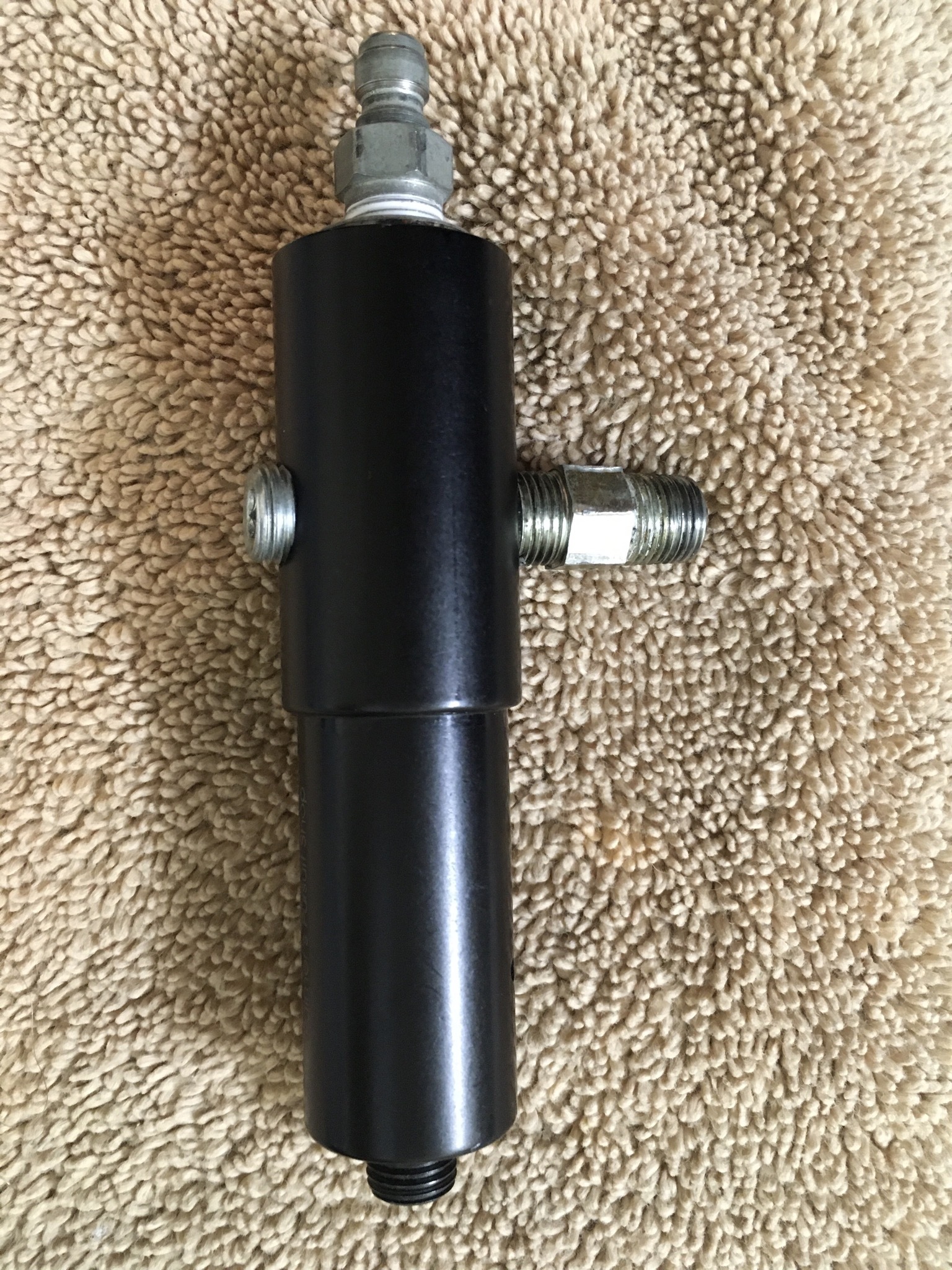

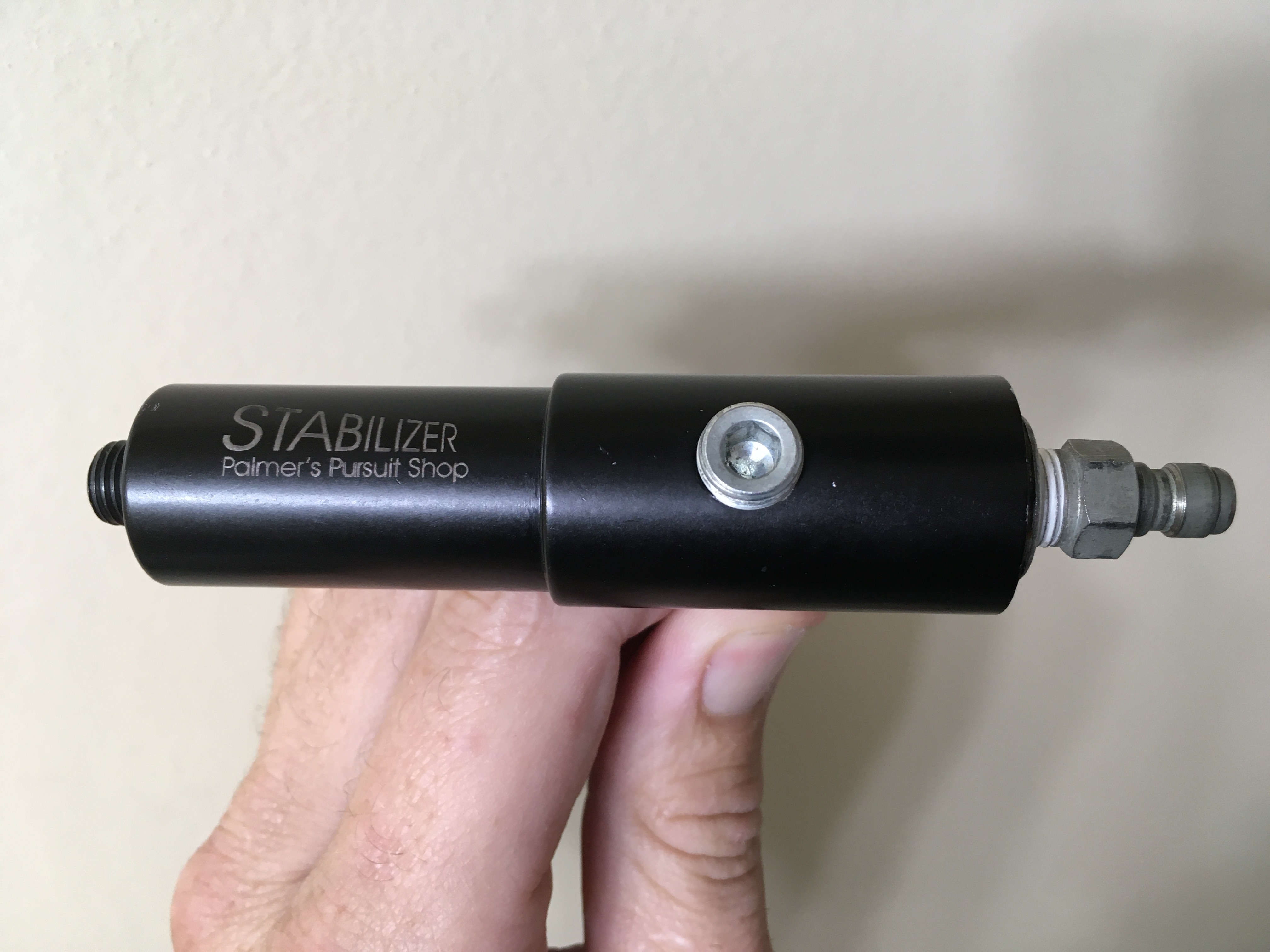

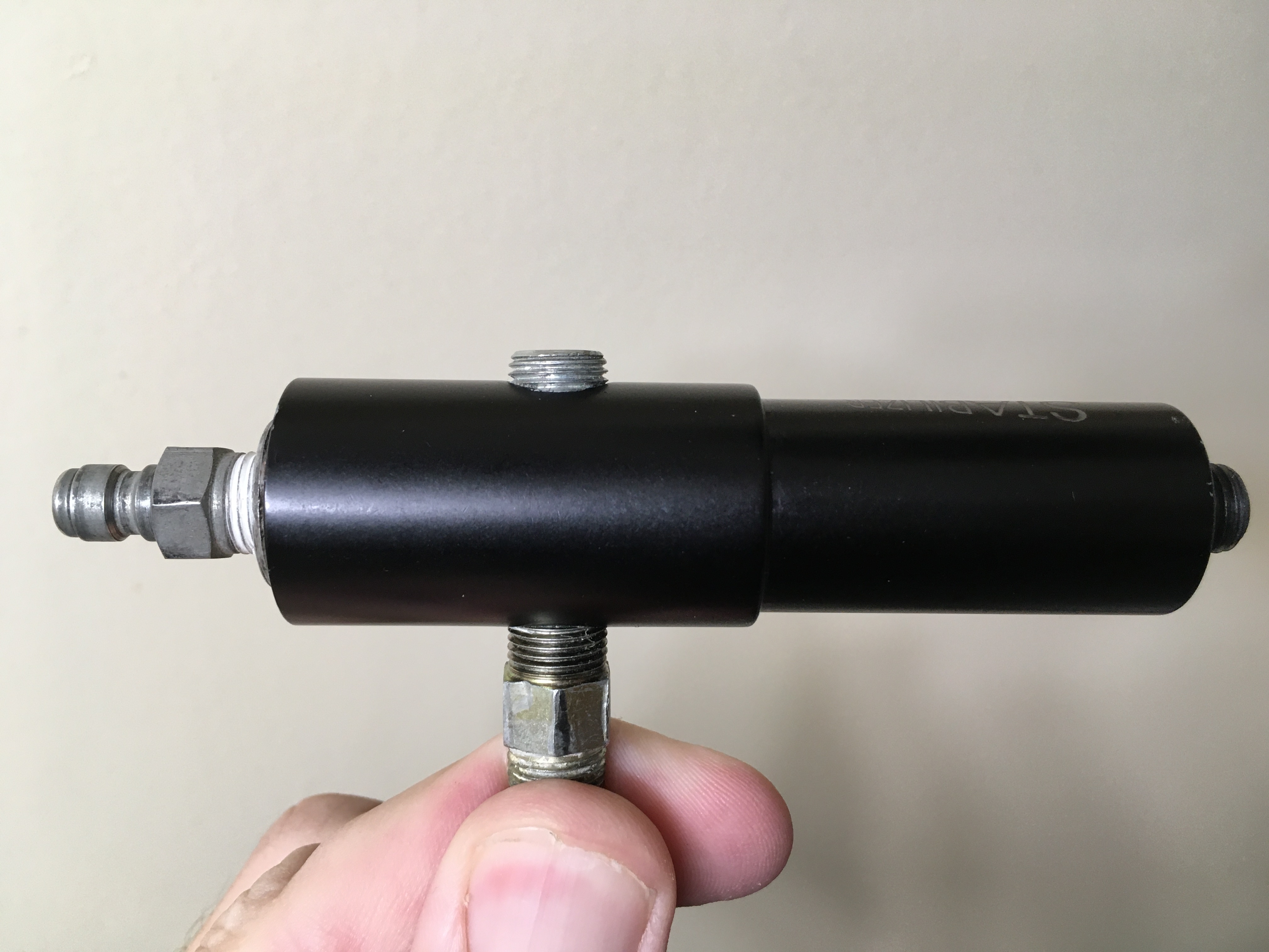

    I am unsure if this one works. I know nothing about it.
    $35 shipped to you.
