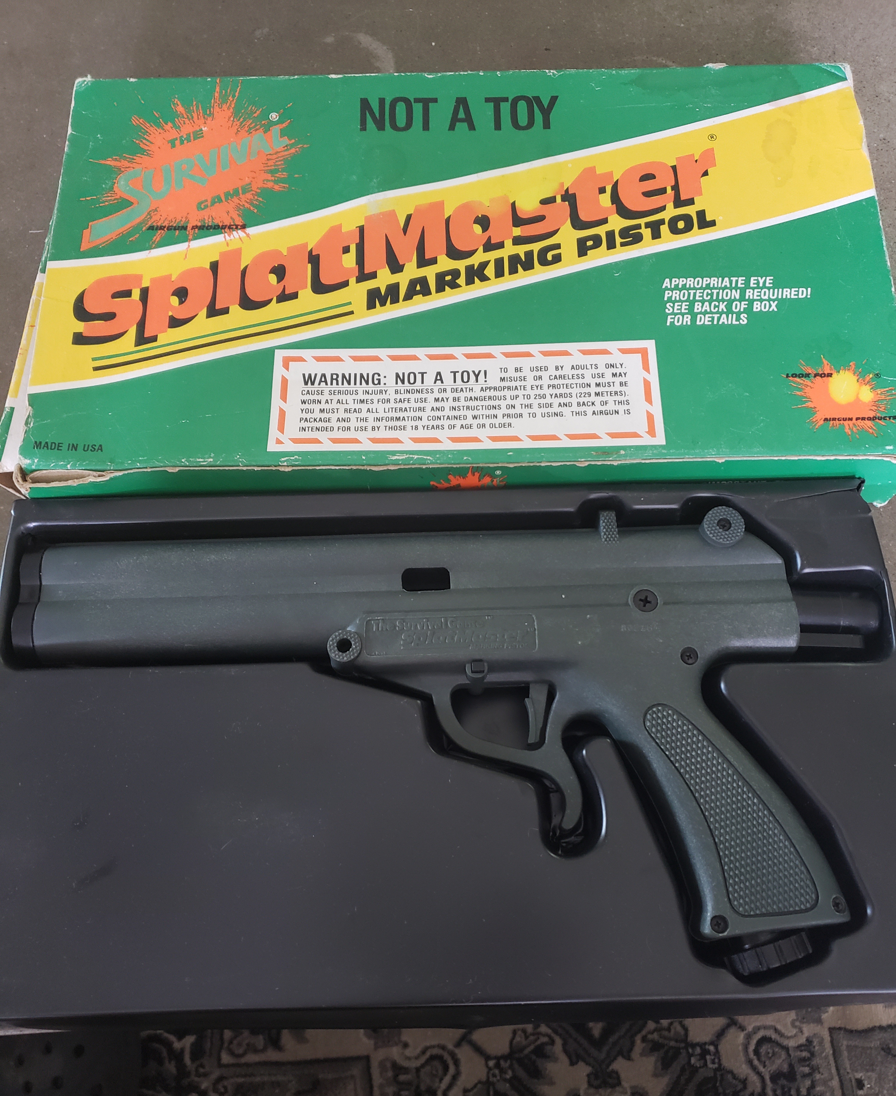

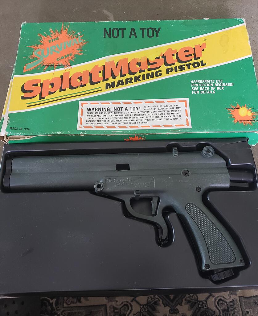

      Just picked up this little baby, NIB.
      Cant wait to try out this kit.

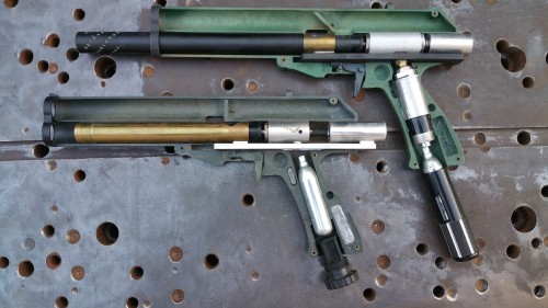

                Random question. Would a threaded piercing valve work in these? It would be awesome to keep the 12g inside the grip.
                • Kit
                  Kit commented
                  I have tried threading a cci piercer on the valve body. I could not get a consistent seal because the body flexes and splits at the seam when you crank down on the knob.
                  You could bore out the handle so the bucket changer can go inside the grip.
                • Brokeass_baller
                  Brokeass_baller commented
                  The body flexes? That's strange. I've never noticed anything like that with my bone stock splatty. Any idea what causes it?
                • Kit
                  Kit commented
                  https://www.paintballcity.org/images..._161714.md.jpg
                  The valve body I make are longer than stock to house the cci power tube and has a larger valve chamber.. Putting a screw through the stock location for the valve body will pierce the valve chamber. CCI piercer are thicker than the ones in the stock valve body, the CCI piercer seal also require a lot of force to create a seal. You can see the one on the bottom has a CCI piercer and a bolt through the valve body. I'm not sure who made the bottom kit, the top one is my regulated version.

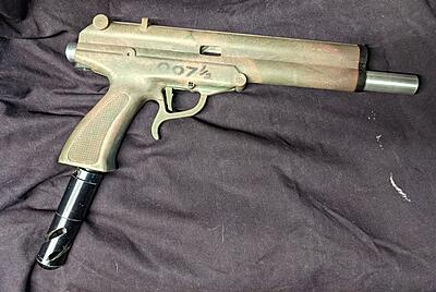

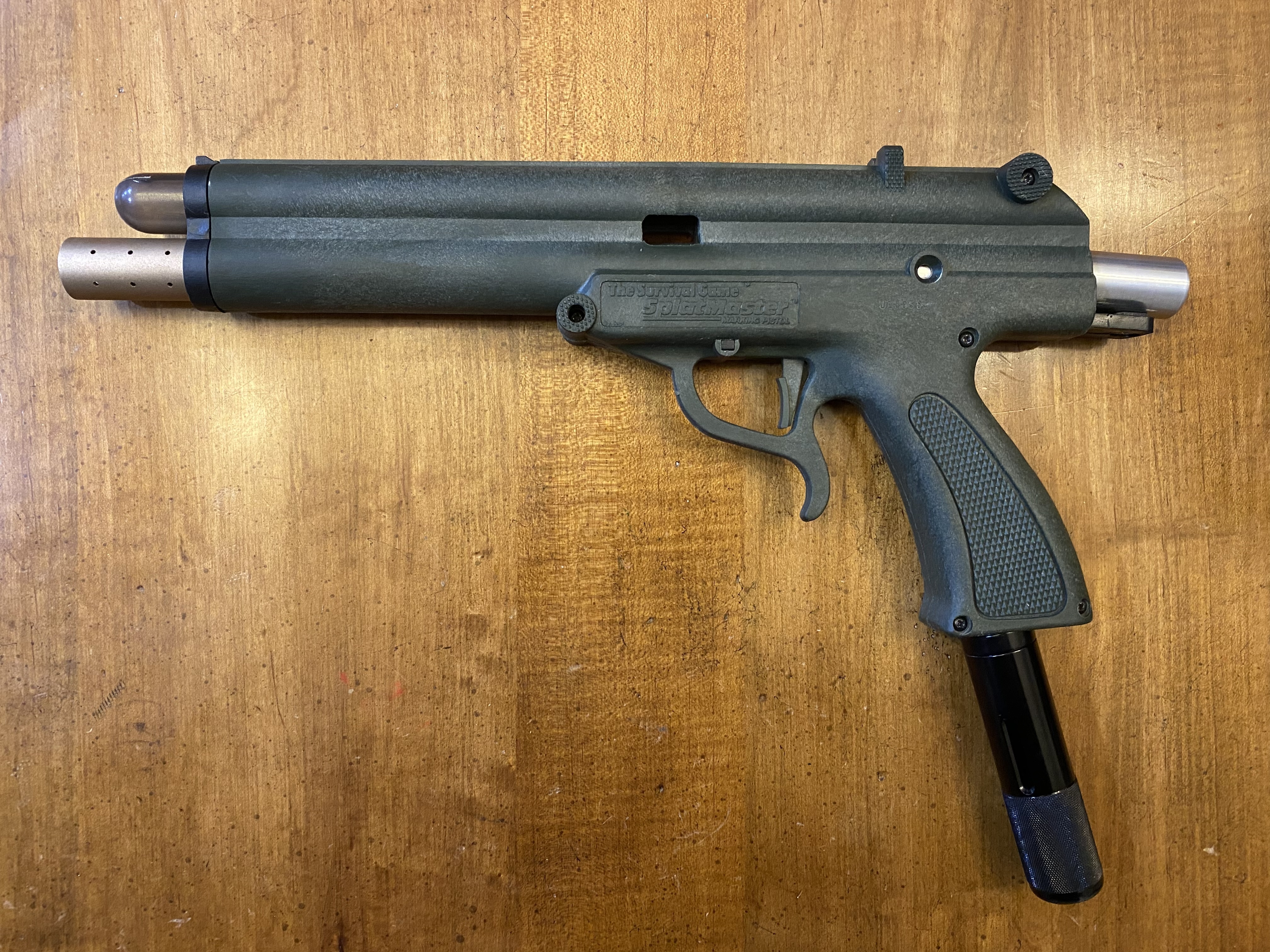

                Eeeeeee!!
                Okay I love this stupid thing. Pretty sure that's a camo body. I had nothing to do with the writing on it but I love it.
                And yes that's a Carter bucket changer.

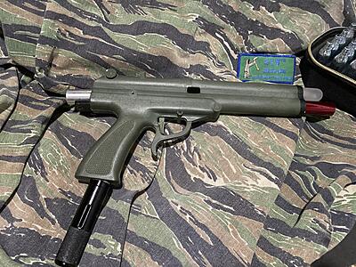

                    One more Kit kit completed. I got to test fire it as well. Itโ€™s pretty consistent over my chrono too.
