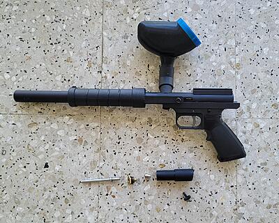

    Hey guys got this pump awhile ago and it has a broken powertube if anybody has an extra powertube that i could buy i would be very thankfull, from the little i can find online this powertube seams to be propetary and its longer than most nelson based pumps but idk maybe some other marker has a compatible powertube or some of you may have one of this for parts

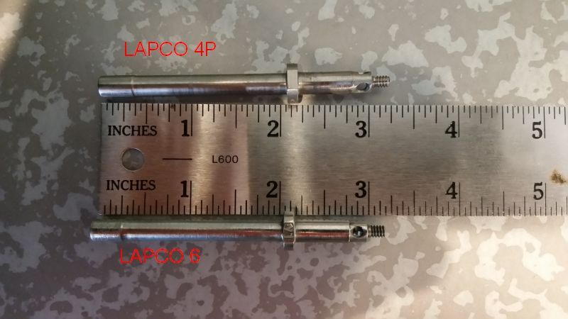

            Its been a while since I maintained a rental fleet that included CMI markers but I do not remember there being anything special. I have some LAPCO power tubes I'll find them and get some measurements.

          Here are two LAPCO power tubes top is a #4P (Phantom) and the bottom one is a standard #6

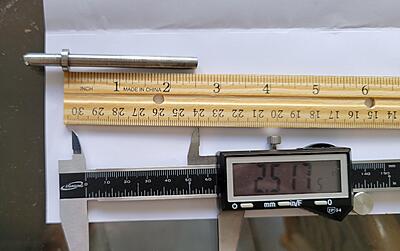

            As i feared they were right, the powertube of the diablo is longer , its 2.5 inches long and the standard ones yoy show me are 2 inches

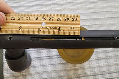

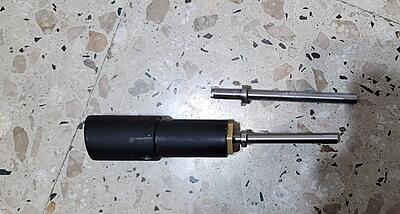

              Though I was thinking around today and took a look, so the marker has a spring adjustment on the bolt , consequently that adjustment moves the brass tube tha fits the powertube inside and even with the adjustment all the way fowars the powertube only need about 1.75 inches to fit and work, i think so im no expert on paintball stuff and this my first pump if anybody can lead me in i would be very thankfull, so yeah im thinking about of getting a cheapo used i think a #6 nelson powertube to see if it work , if so that way i didn't waste 20 bucks on a new one

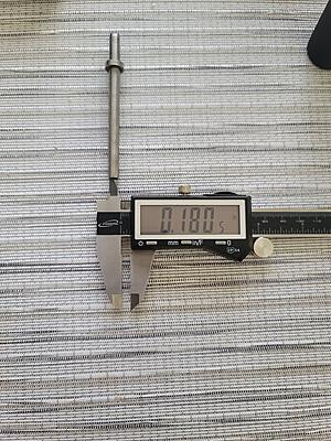

                So a #6 powertube has a .18 inches on diameter ? Or how i should differentiate a #6 from a #4 mine mesures 0.18 inches inside and 0.250 outside diameter

                  Got a lapco powertube and it seams to be working fine on my diablo , need to get more air to keep testing but yeah im so happy i finally got fix this marker it seams that even though the powertube is 1/4 inch shorter it dosent affect its functionality at least that what it seams on my marker
