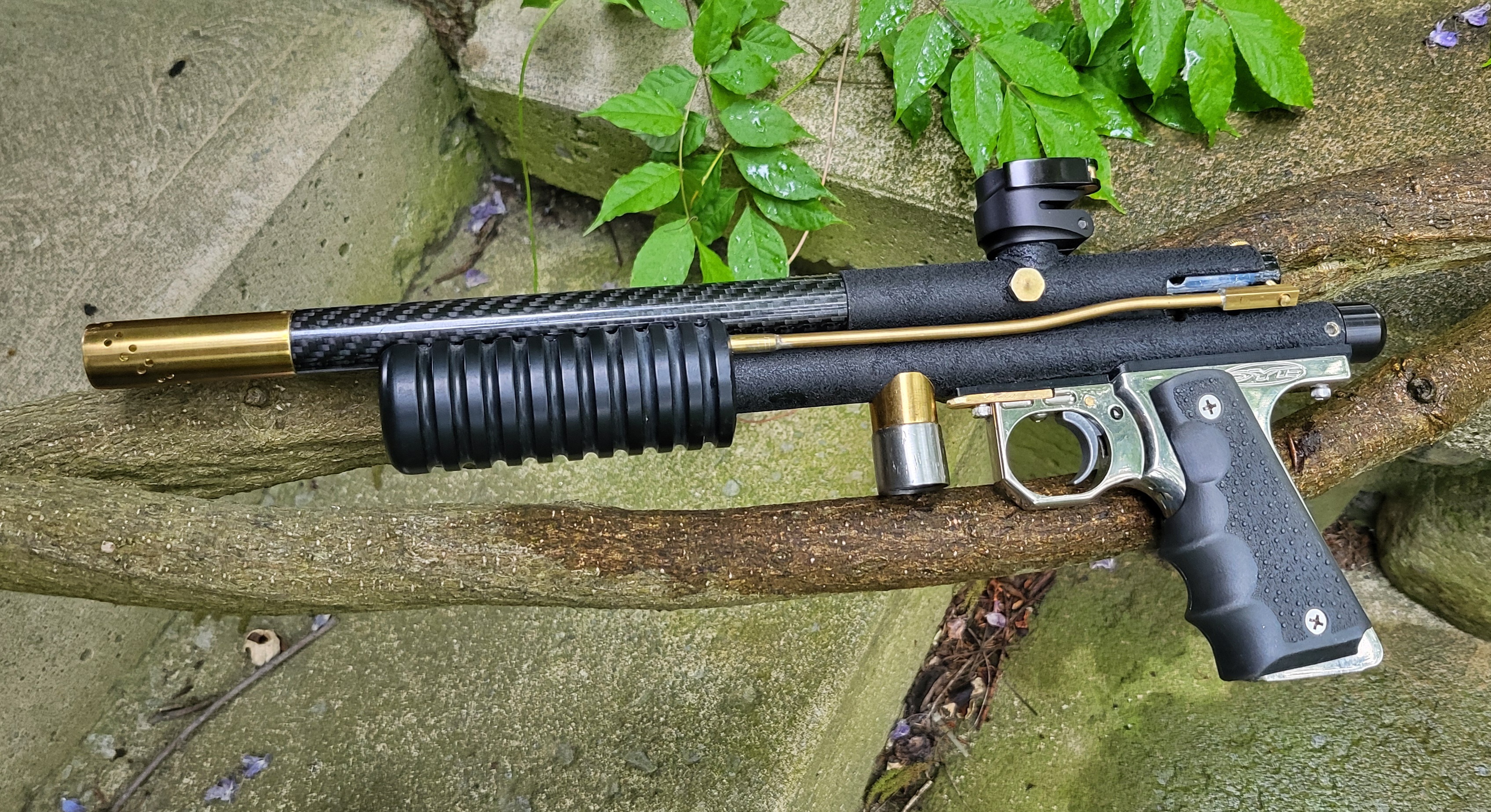

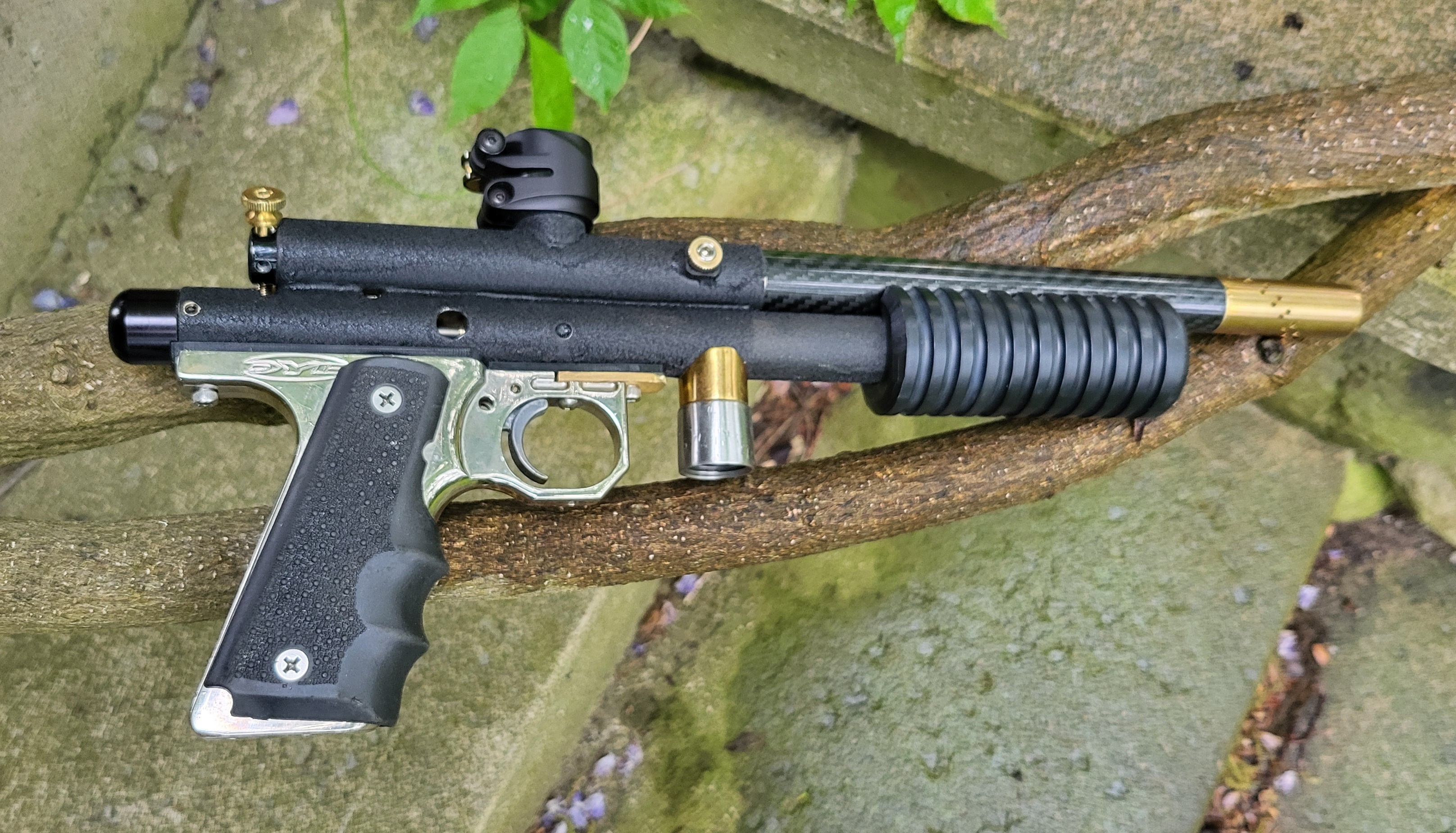

    Custom brass build
    This is built off of a PMI Pursuit body I got from Baccipaintball.com.
    It started life as a P-series pump - I've converted it to K-series specs, so the valve has been moved forward nearly an inch much like a Palmer's pump. The lower tube is also drilled to accept a KP mounting lug so it can be mounted into a stock easily - a KP trigger group would also be required. I have both of those components if the buyer is interested. The gun already uses a KP hammer so that would not need to be sourced.
    The VASA setup involves a Minicocker VASA screwed into a dummy 12gram in the lower tube - this can easily be converted back to 12gram by removing the setup and installing a shoot-to-pierce cupseal.
    The upper tube is scratch built, uses Cocker detents, and takes slip fit barrels, retained by a setscrew with thumbwheel on the right side of the tube. The feedneck stub currently has an Empire clamping feedneck installed. The barrel is made of CF tube and is Freak XL compatible with a dual spiral vented tip - total length roughly 11.5".
    The bolt is a modified P-series bolt.
    The pump is a Delrin handle from Bacci's site.
    The frame is a DYE Automag frame with Mag trigger and modified Cocker sear, and has been modified to fit with an extension plate to move the front grip screw location. The adapter is a 3d printed piece.
    The current setup will require a regulator to both adjust velocity and shoot at field-legal velocities - generally it seems to be happy around the 450psi mark. Results may vary.
    Like most hand built pumps of this nature there are some imperfections. If there any questions feel free to ask.
    Asking $300 usd shipped. No trades. Open to reasonable offers.

            So the way this guy adjusts velocity is based on tank pressure?
              I. Am. Canadian. 🇨🇦
              • 3508
              No... Input pressure. You'll need a HPR like a Stab or something else on this.
              I guess an adjustable tank reg would work.

                Oh gotcha, don't know why i thought tank reg when you said reg. Thanks for clarifying, if this is still around when the bonus hits next week i'll give you a message
                  Jordan commented
                  No worries, happy to clear things up. Things that make sense in my head don't always translate to written word properly. 🙂
                • ironklad
                  ironklad commented
                  Appreciate it man. So is the final form of this a bottom asa into a regulator?
                  Jordan commented
                  Exactly.
