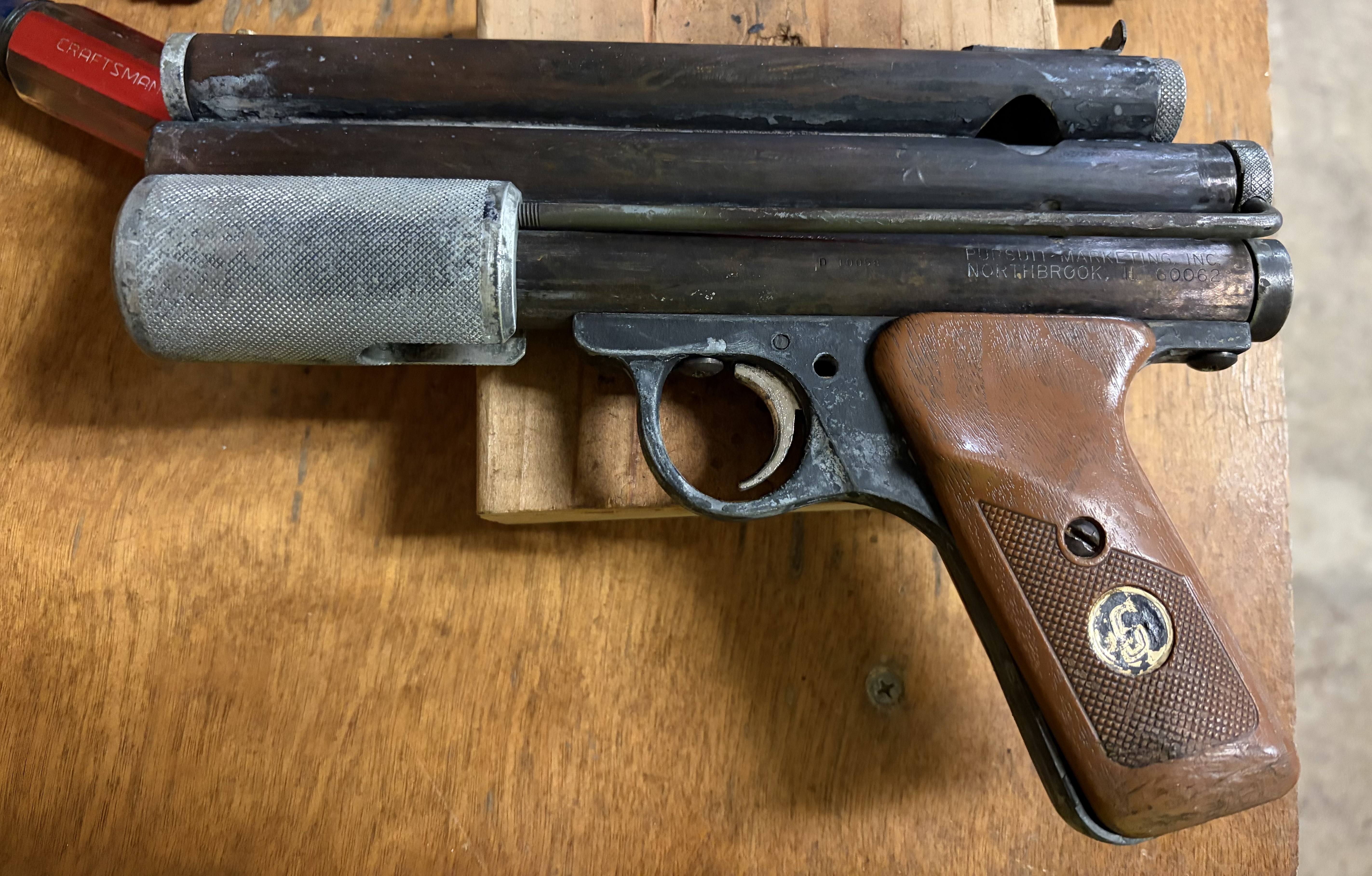

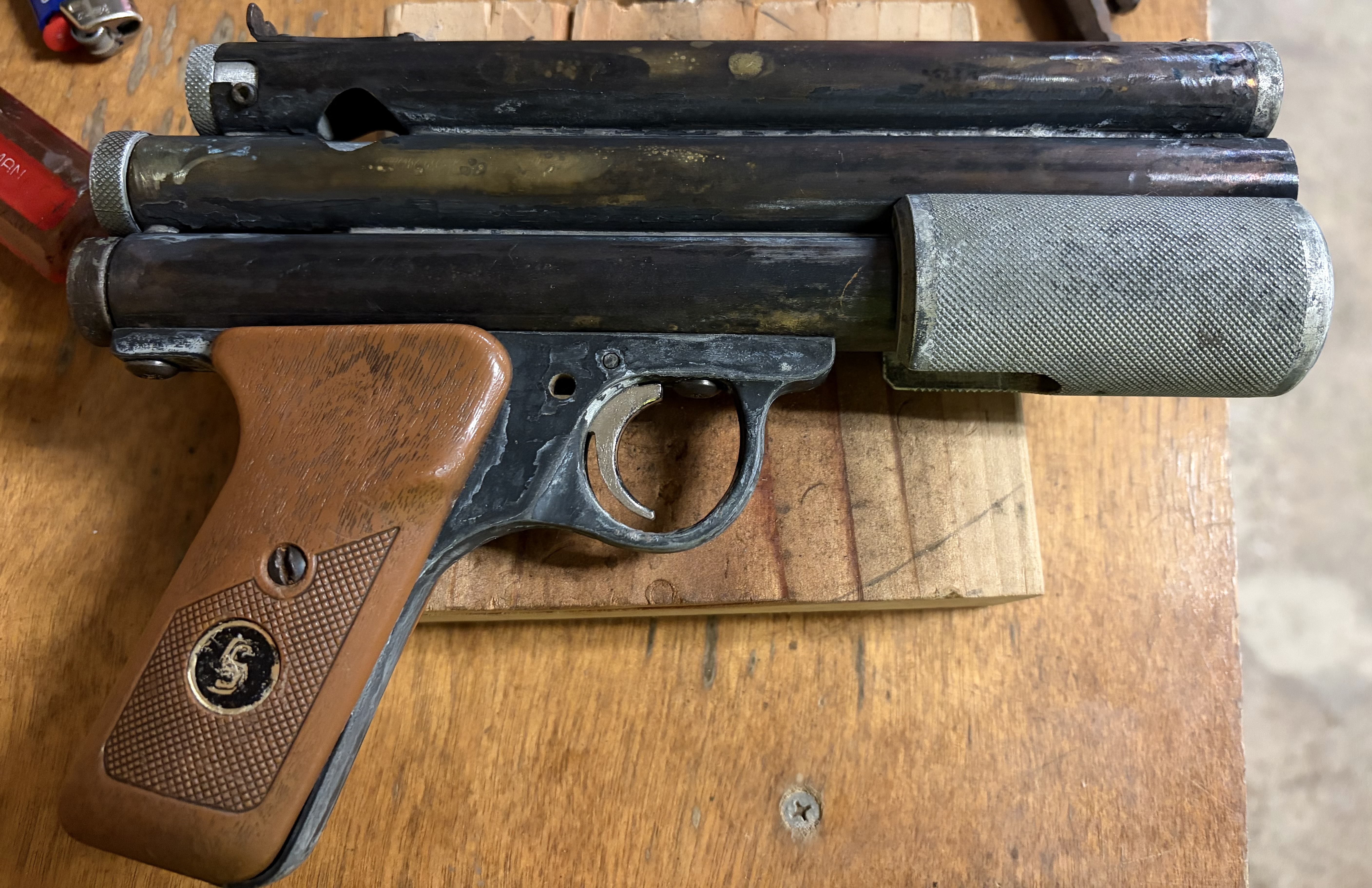

    Long story short. Believe it or not this was found by my brother at the dumps. It was heavily painted over an “X” amount of times, frame, body, everything. I tore it down completely over the weekend and stripped the paint and this was the ending result. I could’ve gone further but I didn’t want to spend more time on this.
    The body is straight but looks like sheet with some grinding marks. All seals are new in the lower tube including the cup seal/pierce pin. The lower tube was the only thing that was untouched. I don’t have any 12 grams to test it but I’m confident it’ll hold. The bolt is in rough shape with no o ring. It’ll be good for a project or for parts, well at least for the lower tube.
    **SOLD***shipped or straight trade for a .45 grip Phantom frame in dust red/Matte red. Black, maybe but I want red. It needs a good home regardless on sale or trade. I’m just happy it was found vs being in a landfill.

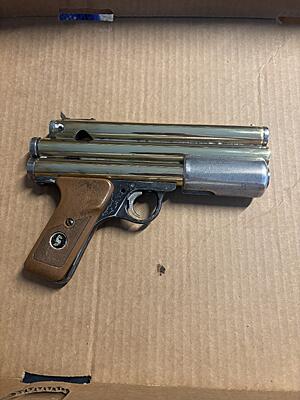

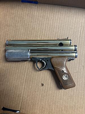

      I restored it best as i could (Except for trigger frame) just cleaned it up a bit .
      seals and shoots great. Was a fun little project .

        Hot damn! What process did you use for polishing?
      • Kherbo94
        Kherbo94 commented
        I use vinegar, baking soda and #0000 steel wool to scrub the parts internals and inside barrels, Sanded it from 800grit - 10,000 grit outside . Then hit it with some Mothers mag polish. The pump on it is really smooth now too even without the barring in the handle.
      • 6250
      If that's the aluminum frame you can strip and polish that as well. They look really good with a polished body
