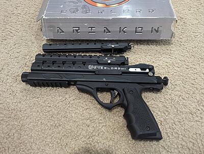

    Ariakon Overlord
    Has both magazines. Seals and shoots with the right 12g CO2 carts. The way the pistol seals the 12g is around it's neck which is why it can have problems depending on the CO2 carts you use. From my short experience with it, umarex CO2 carts have too small of a neck to seal and crosman carts seal but are difficult to remove when empty. It was designed to use brass eagle carts, but they aren't made anymore.
    80 shipped

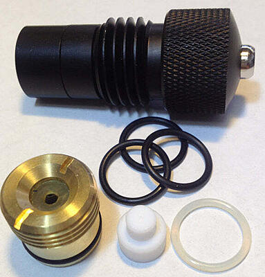

      Replace the piercing block with the one from this kit,it will then seal at the face of the cartridge and will solve many leak issues these markers suffer from
      This kit includes: 1 x #18 Puncture Valve (complete unit)1 x #21 Cup Seal (poppet )3 x #32. O-ring1 x #12. O-ring (Hammer O-ring)1 x Laser Sight for T68 Pistol
        I didn't see this comment, but glad I did now. I'll look into it. I ended up pinching a seat from buna and replacing the spring and 010 oring with good results.
