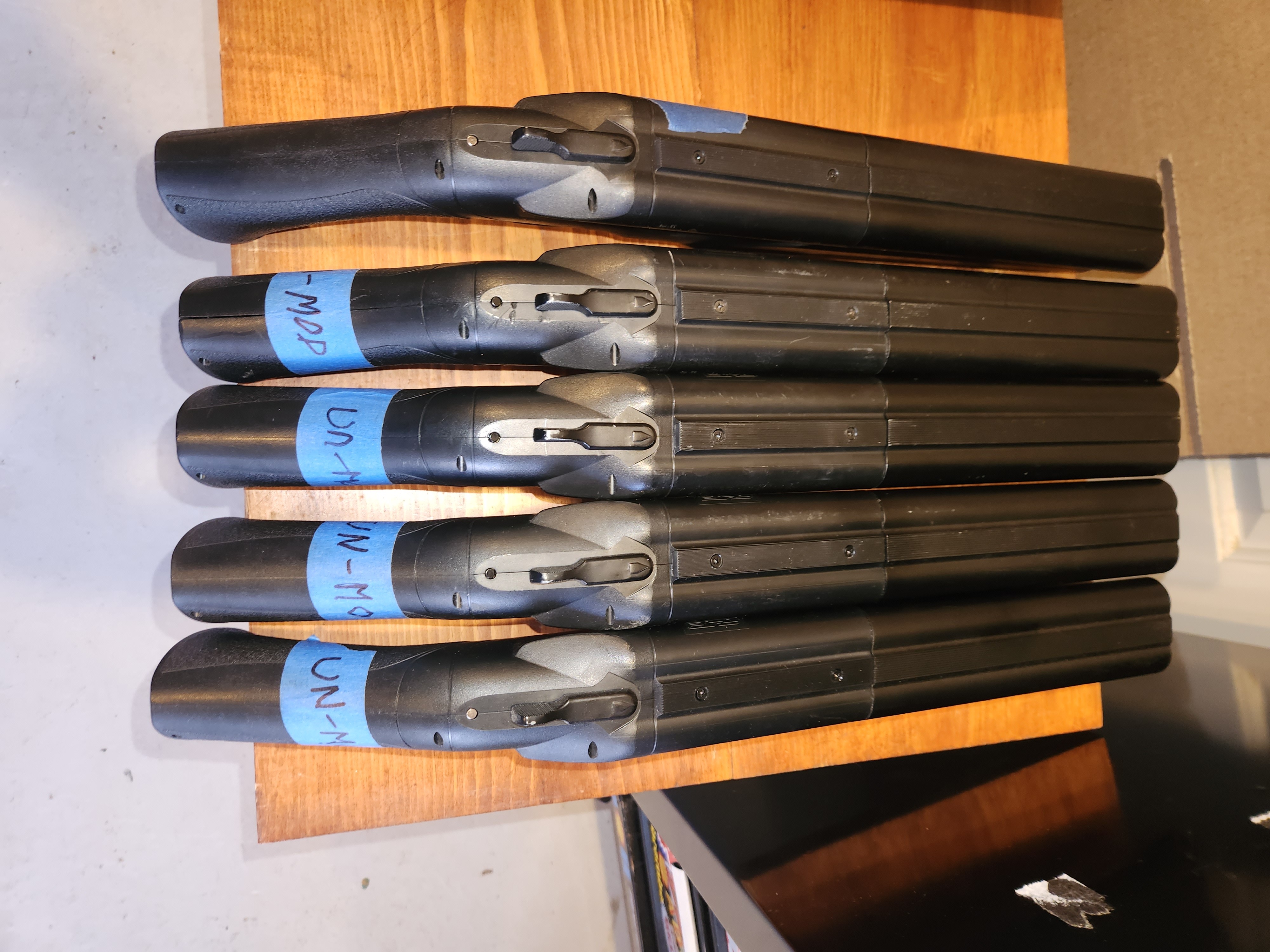

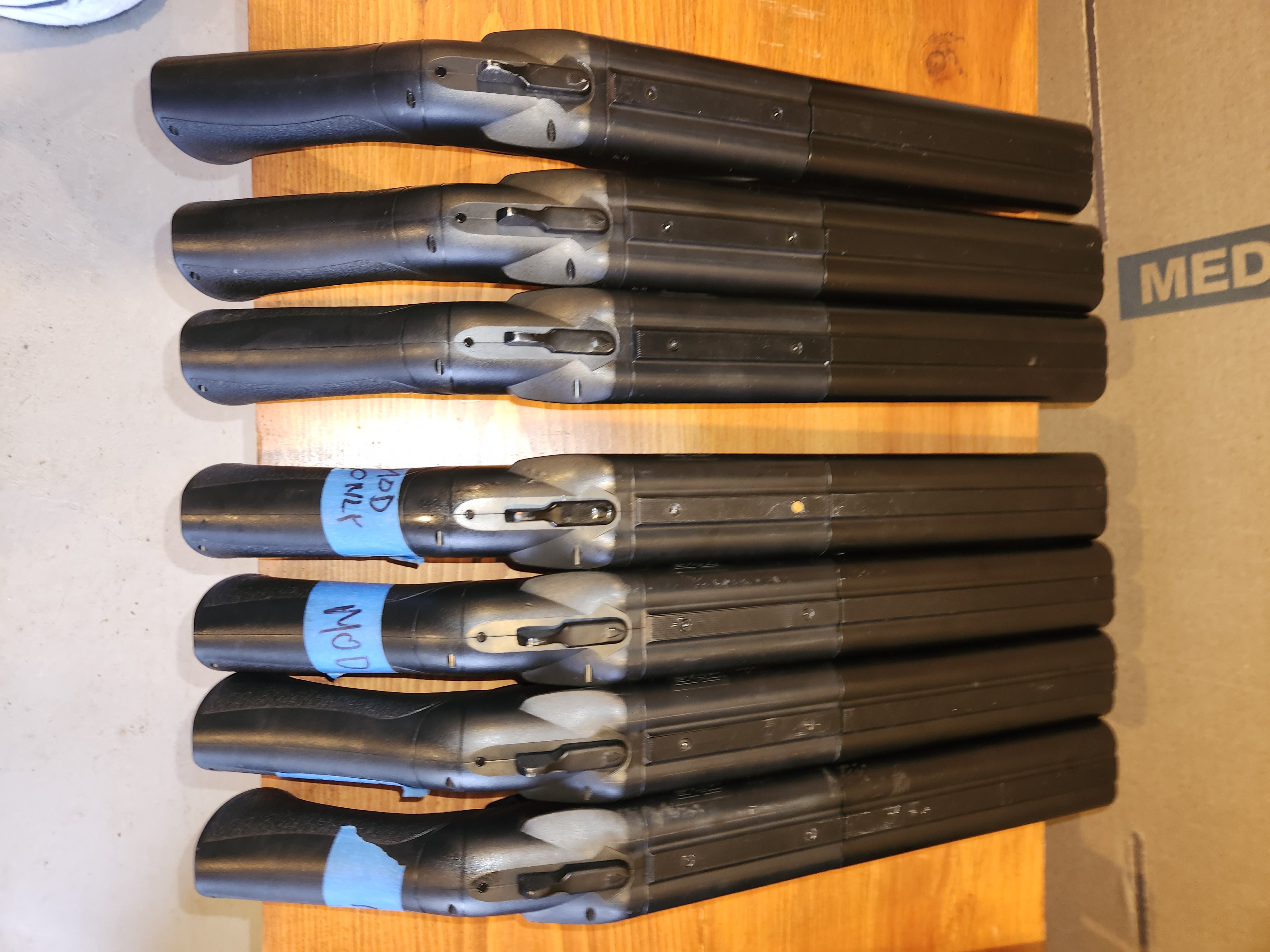

    I have 13 Umarex HDS68 shotguns for sale. 5 have had the valve block modified to increase the velocity of the marker. 7 have not been modified. All will come with the quick pierce cap required for operation, but not shown in the pics.
    $85 each shipped CONUS Group deals will be considered.

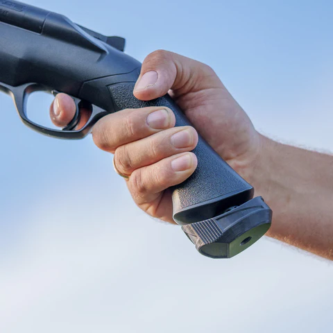

      https://z-ram.net/products/punch-but...l-black-cal-68
      Click image for larger version  Name:	image.png Views:	1 Size:	170.2 KB ID:	628017
      BTW: The same site has 6mm,.43 cal, and, .50 cal shells for these so you may convert them​
      • cheapguitarscheapthrills
        cheapguitarscheapthrills commented
        Interesting, does this replace or fit over?
      • COB
        COB commented
        Fits over bottom pierce cap

      Update on the HDS68s. I have checked and tested the entire fleet. There are 9 remaining. 2 have no valve blocks and will shoot single barrel 300 to 320s first couple of shots. The other 7 have been modified and shoot in the 260s. They can be tuned up a little higher but may shoot hot in warmer weather. I will test every marker before I ship.
