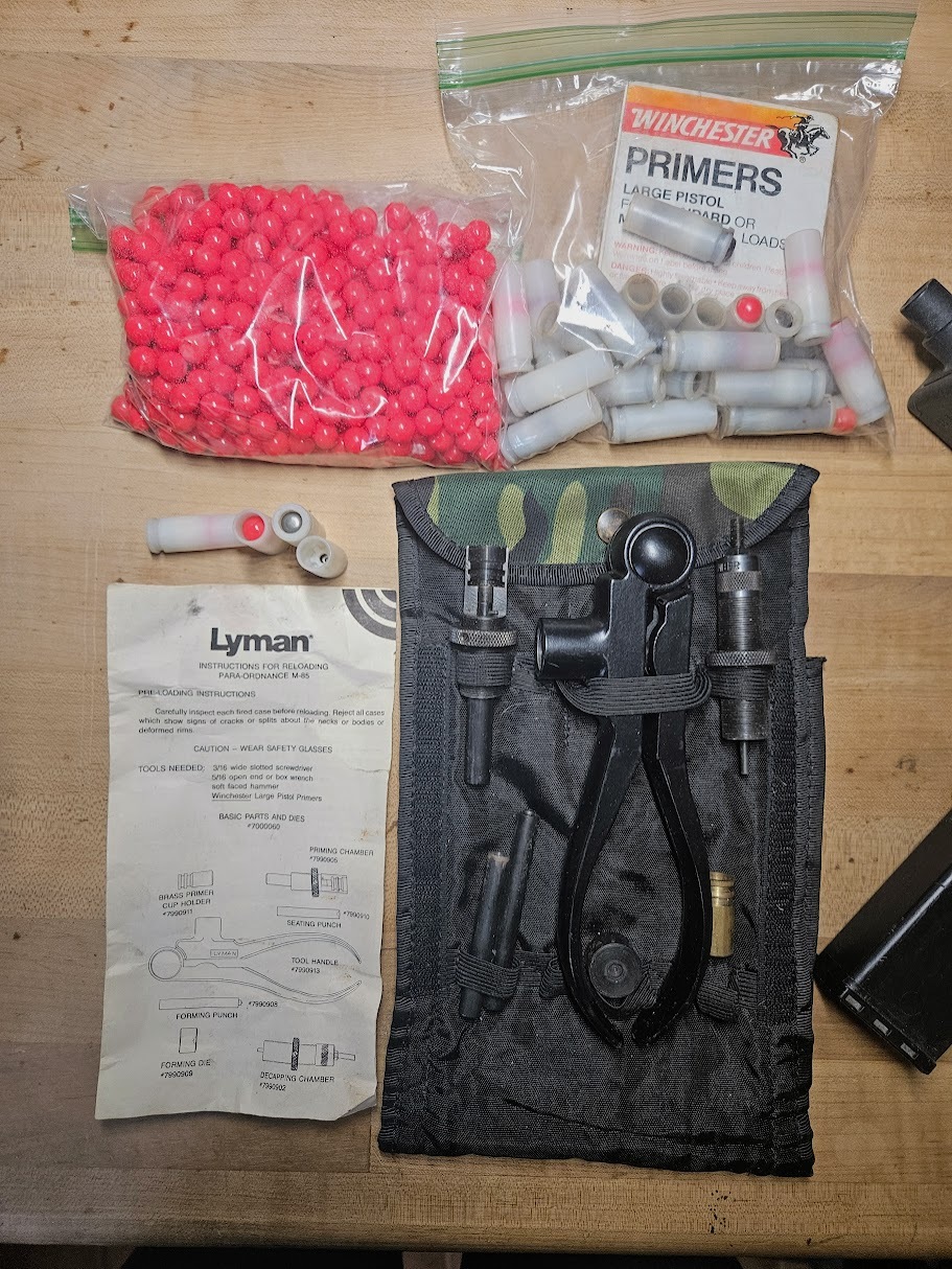

          I have a Mod 85 and reload kit with a bunch of new and used cases, primers, even a bag of fairly dry pellets. Bought the stuff in the early 90s at a shop in Anchorage AK when these were available. Will find the reload kit with all the goodies - can spare a bunch of unfired cases for the cause of 3D printing! I have some boxes to look through but will be back....
          I agree with all the comments - it's a dwindling supply of cartridges due to the design, but dang - firing off a magazine in the blink of an eye is worth it! At night, the lack of a spark arrestor is amazing!

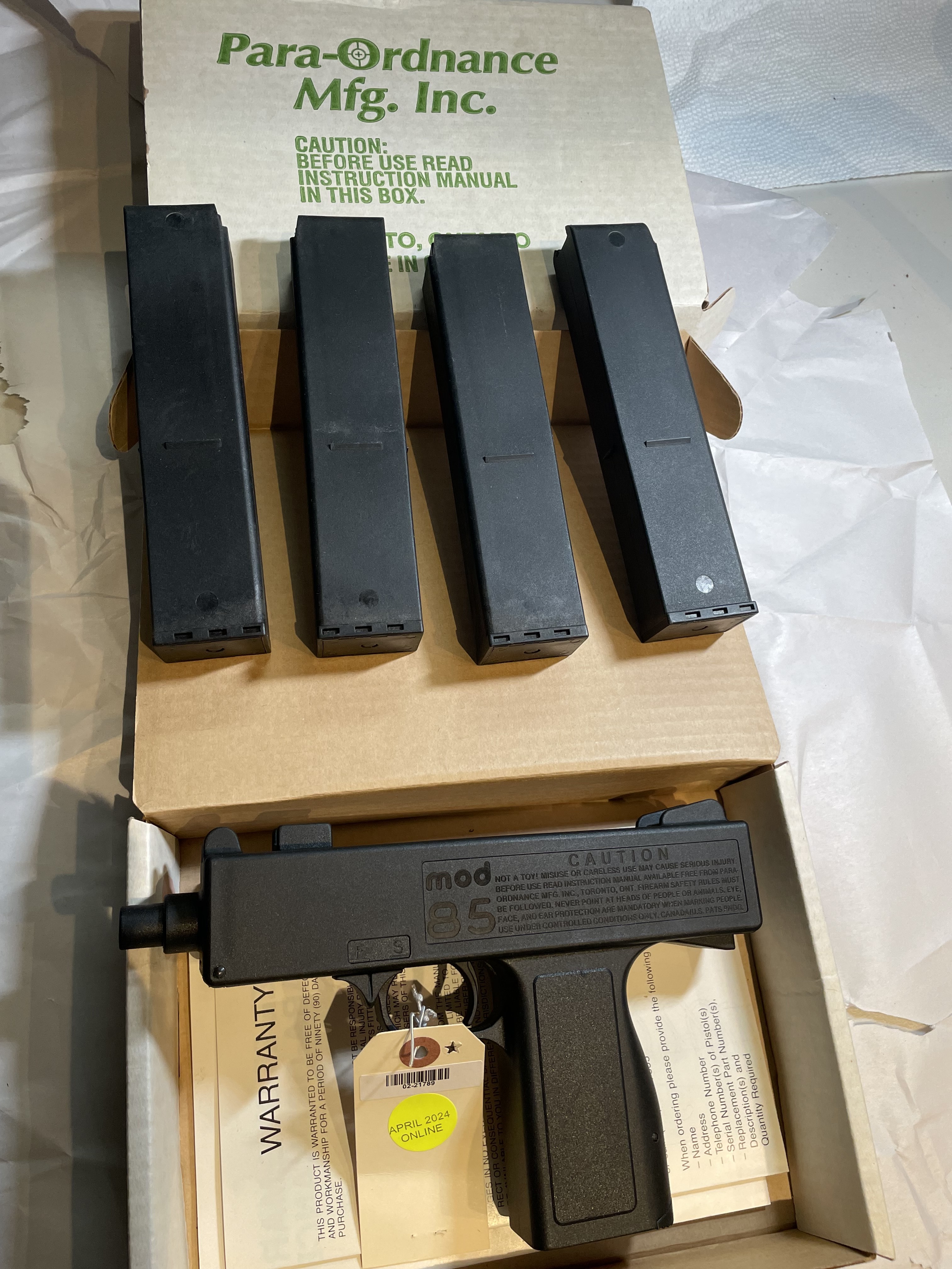

                  Jackpot! Found my stash, including some new cartridges with original primers. I'd be willing to donate a couple for research and destructive sampling:
                  20250430_132730.jpg​
