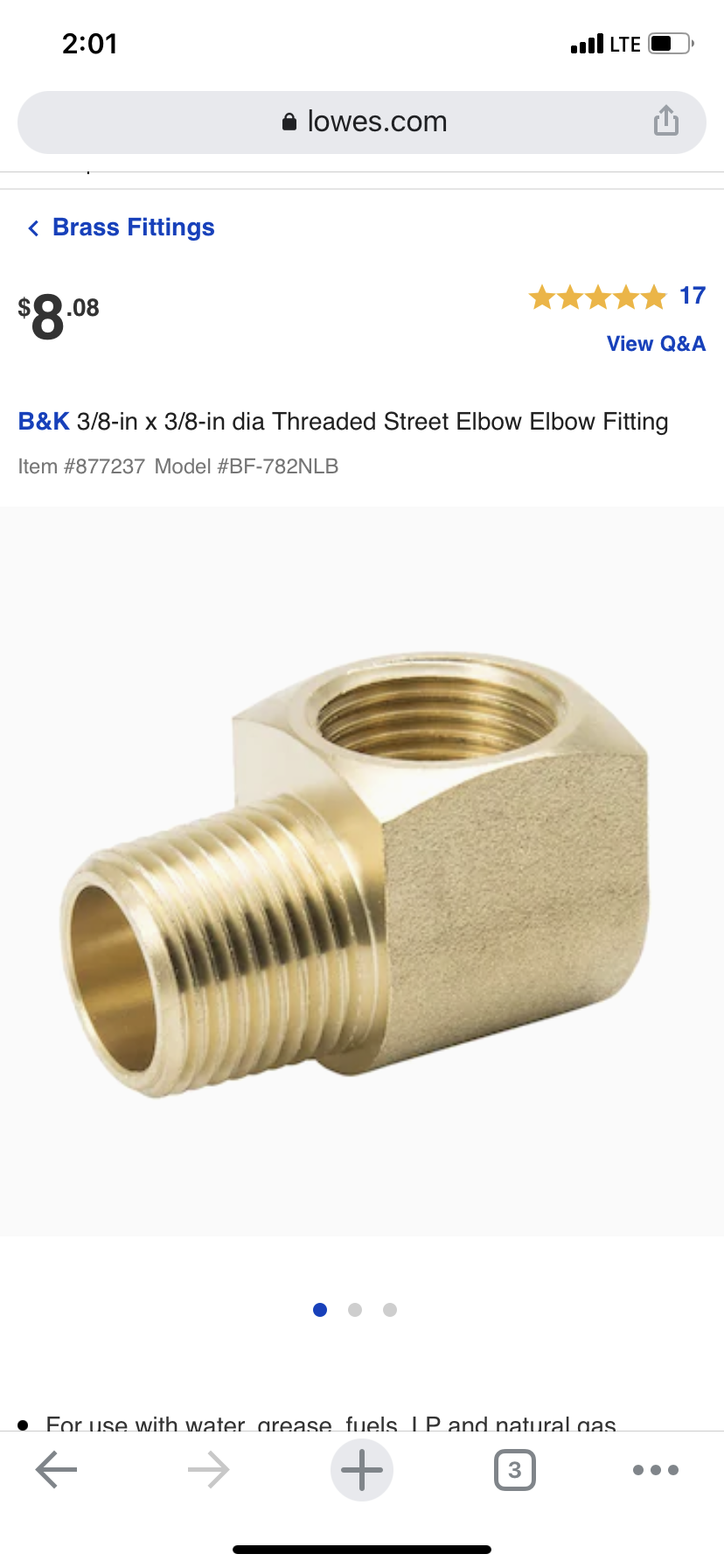

    I was sure I had one of these but can’t find it. Looking for a 90 degree fitting with an open end that I can screw a 90 degree macro fitting into so that I can bottom line my back bottle phantom with macro line like an Automag. If that makes any sense.
    it would look like this, but in macroline threads

    Are you referring to a 1/8" plumbing street elbow?
    Most hardware stores have these in stock.

      I might be, Im not sure what the pressure limitations of something like that would be.
    • autococker04
      autococker04 commented
      I think the one you pictured would work better than the one I posted because of the extra extended bit. I need the clearance to get past the guns body

    1/8 brass will be around 3-5kips working and 8-10kips burst ...

    Lowes is pretty overpriced on those, over $6 each, homedepot only around $4 each. Shop around.
    If you can wait palmers has a 5 pack for $12.95

    I bought a bunch of brass Elbows online with 1200 psi WP which seems fine to me, but occasionally I see them for sale with like 150psi wp which doesn't make any sense to me, but just be sure what you are buying.
