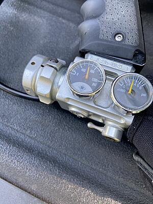

    Not sure you’re willing to rock an adjustable tank reg rather than an HPR, but if so the MaxFlo In-line is great. I bench tested it against a Powerhouse and the recharge rate is right there. I can’t remember what the max output is but for sure covers your 700 psi.
      Hmm that is a thought. I was hoping to use screw-in tanks, but that's not a bad option. Do you have the pictured one for sale?
