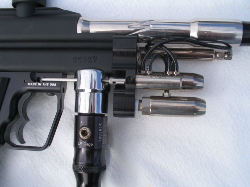

    • Brokeass_baller
      Brokeass_baller commented
      If he's trying to make a Gemini kit work, I think the pneumatic switch threads are different. The 6-way, or whatever it was.

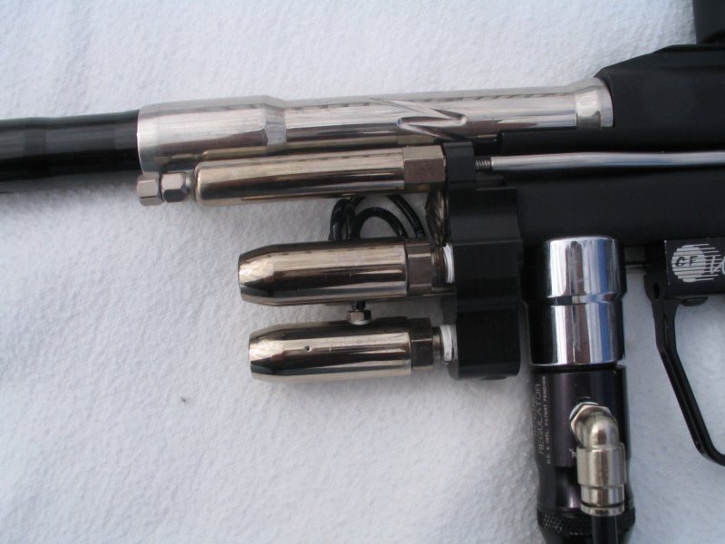

      • Brokeass_baller
        No. It's a one piece design. They're funky little kits. I had one for a while. I'll see if I have any pictures saved.

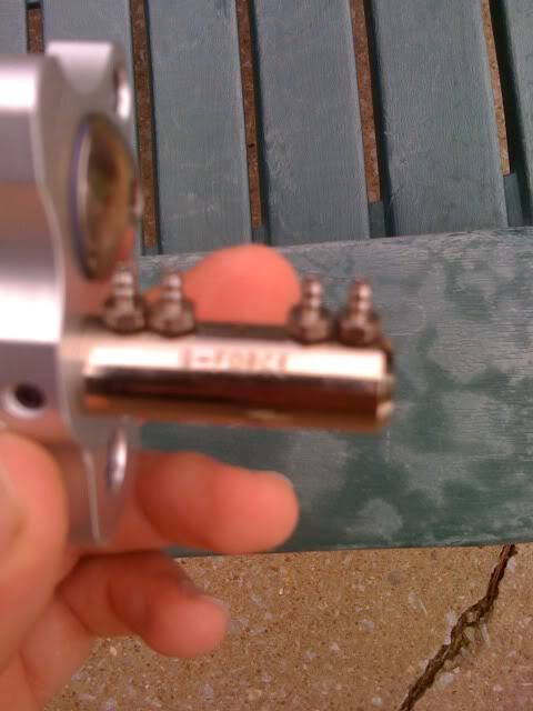

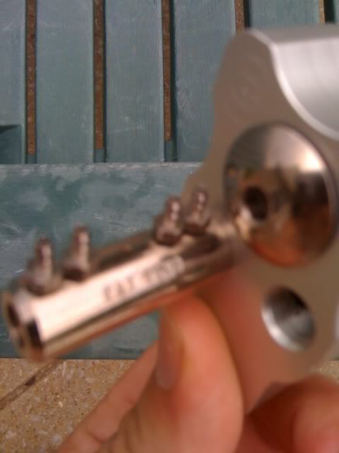

      Originally posted by XEMON
      i thought they had 2 switch stacked up on top of each other?
      Found them. Sorry these are garbage. I'm pretty sure I took them with the original iphone. Either that or my last Nokia. Lol. I sold my kit forever ago.
      • Brokeass_baller
        Now that I'm thinking about it, the switch may not have even been threaded. It might have been slip and held in by that set screw. I can't remember.

                Originally posted by Brokeass_baller
                you'll have a hard time resetting the trigger forward.
                I didn't see any binding issues with the extra oings in the 6way. Max pressure is still the same as a standard 3/4way.
                automeister you do not need a custom front block. The 6 way is a slip fit - drill and tap a set screw (as pictured) on the side of a standard front block, then add the extra LPR from the bottom gauge port.
