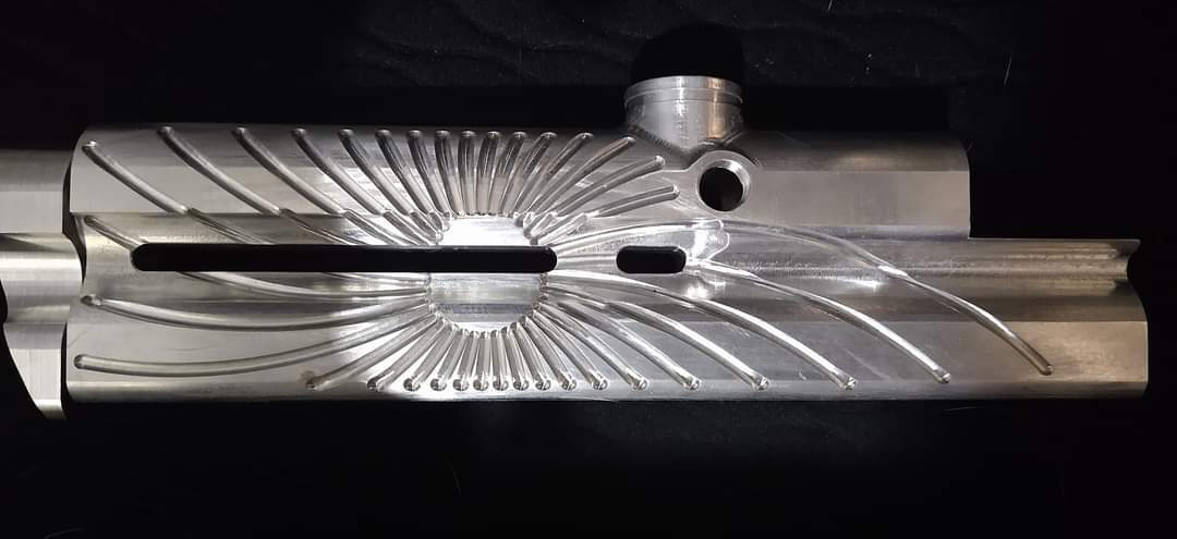

    Karnivore snatch tail
    Looking for one to mock up my latest project

      Just got one from a buddy here. Thank you guys. Yeah dcl is a favorite seller of mine and in my saved list. Jake, not really much "simple" going on with this build.

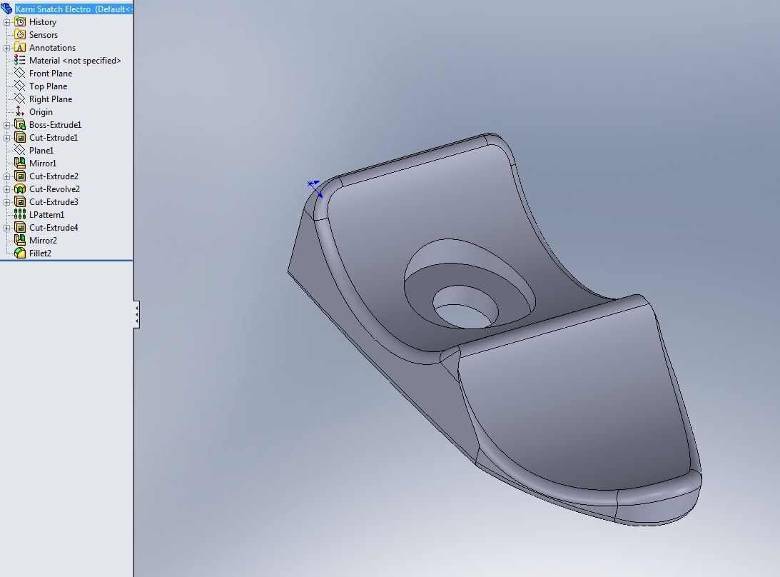

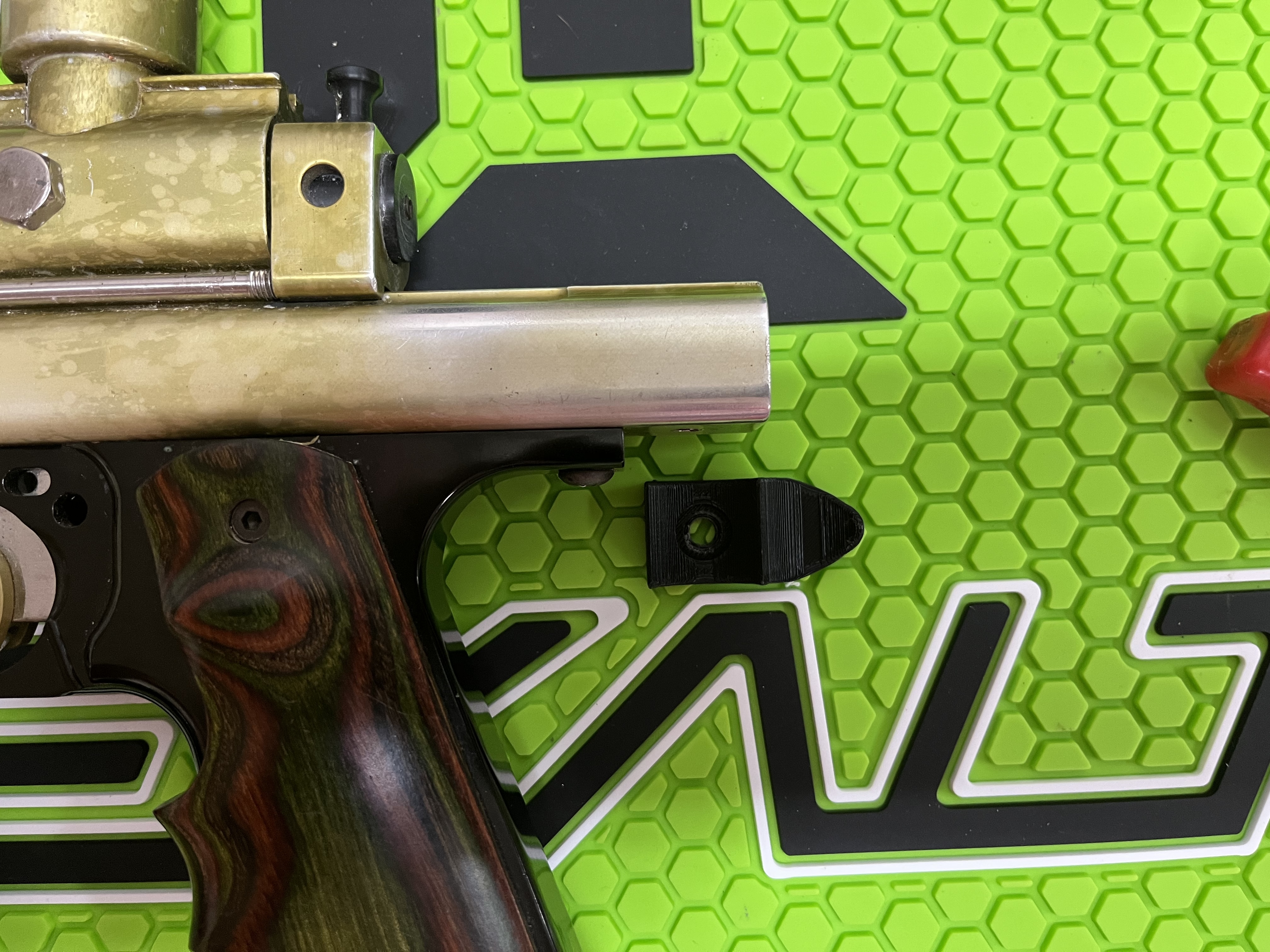

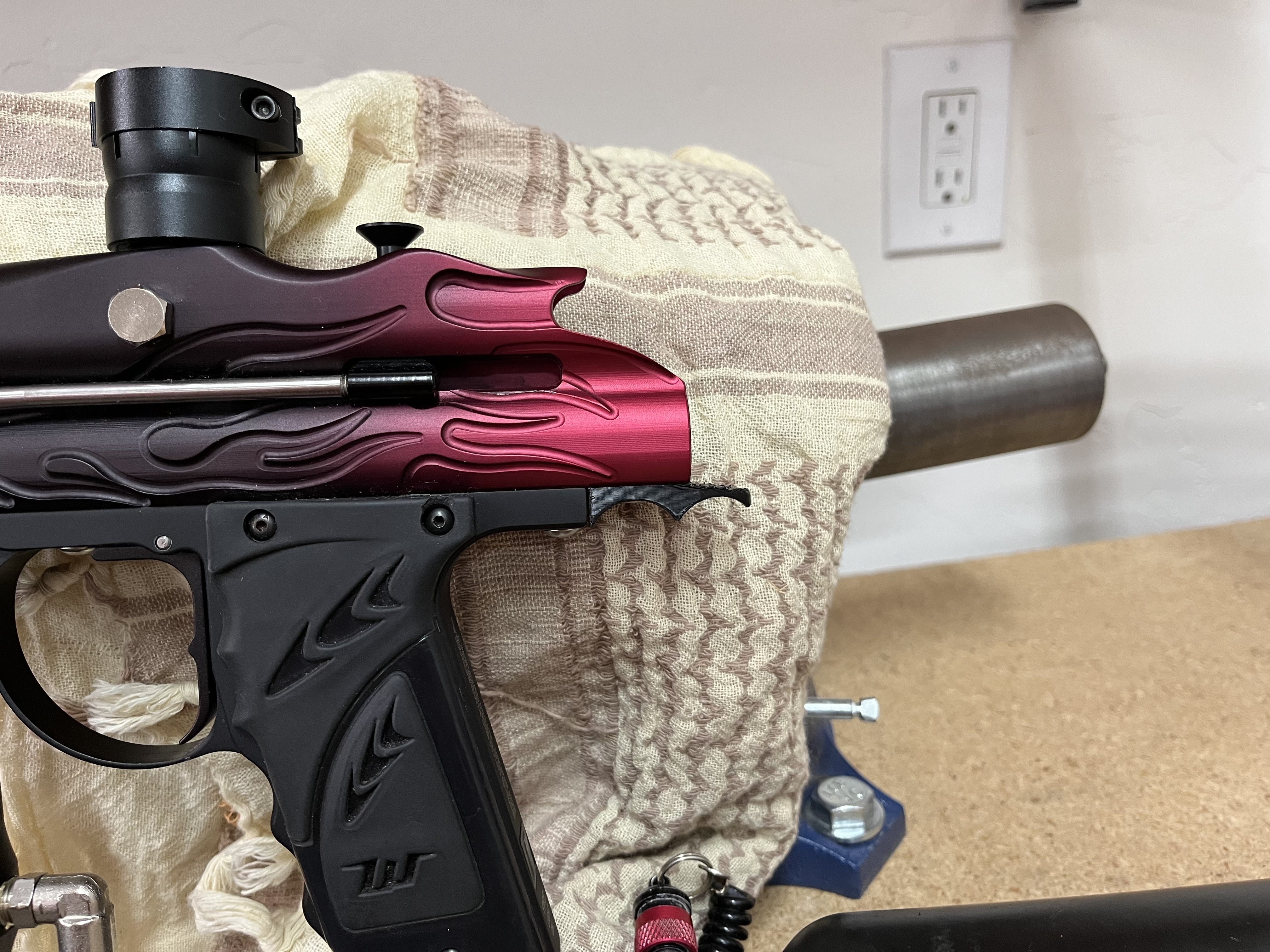

        I have never talked myself into the $50+ these go for. I wanted one for my 06 Black Magic and one for my pump would be pretty nice too. That's $100 just to hold onto something I've never dropped. Nah... So I made one, well two. Didn't copy it exactly, but it feels nice enough on either marker. The file says electro because the Worr Frame is .350 thick where the back screw holds it on and the mech frame on my pump is .250. I was thinking of making a thinner one for the mech frame, but it feels nice enough. I added some rounds to the outside of the ridges because they were a little sharper than the first iteration, which is in the pics I'm going to need a double post for since some pics are on my computer and some are on my phone.
        https://www.thingiverse.com/thing:6002475

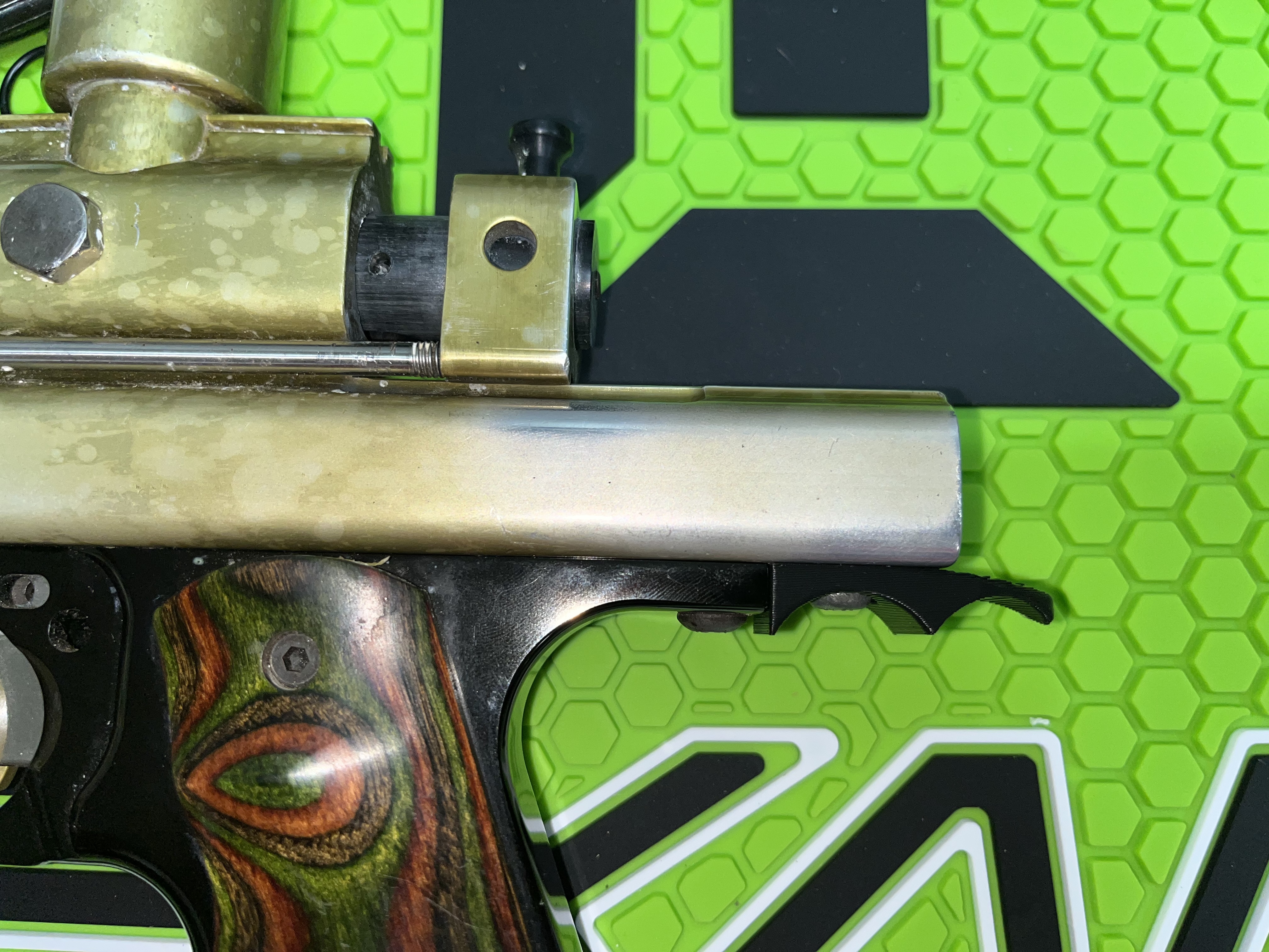

          Here they are in real life. Printed at 100% infill, took 32 minutes per part on my Ender 3.
