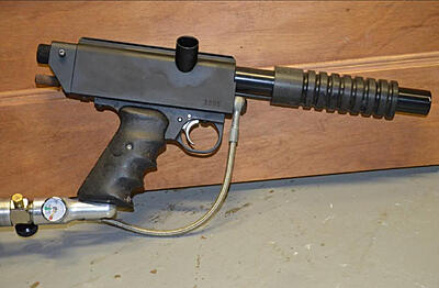

    Looking to put my sniper III back together but I’m missing the air hose. Anyone have one or know where one can be found?
    Photo for example.

        The fitting is fixed to the hose on end and the other is a standard 1/8. The fitting reminds me of an automotive hydraulic brake line hose.

          That is your answer just take your marker with picture to a local hydraulic shop and they'll figure it out and make you up a fitted line. I am pretty sure that is a basic hydraulic banjo bolt fitting. Bud used off the shelf parts back then nothing proprietary. I have a Parker Hydraulic store near me that has been more then willing to help me out in the past with these types of things.

          Yeah, it's fixed in the stock form, but I figure it doesn't need to be crimped to it. 1/8 to 1/8 and then to this "fitting" is probably going to be your best bet in finding. I'm still poking around. I literally cant find a manual for this gun anywhere in my hoarde
