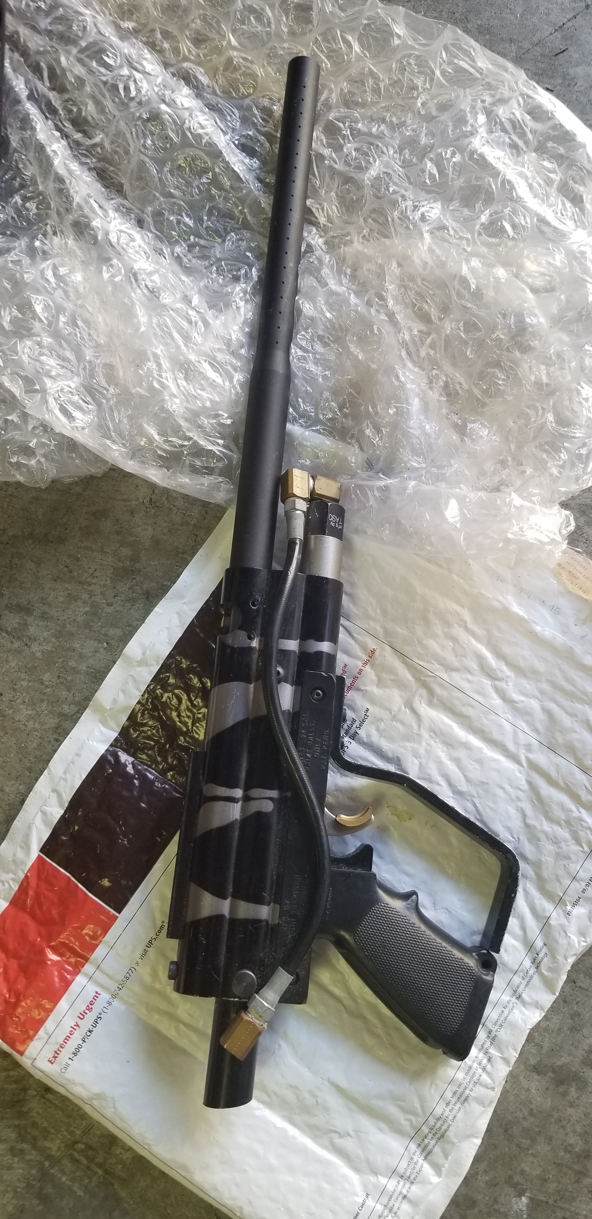

    Finally getting around to tinkering with my VM68. By chance does anyone have any parts/upgrades for it? Looking for ASAs, Pro-team vertical feed necks, stocks, etc.

    Make sure you get some detents from brettG.
    Freak barrel from Docs is about as good as you can do for barrels these days that can deal with modern smaller paint.
    Proteam doesn't have much, if anything, left in terms of upgrades. If you want a vertical feedneck you can use the stock one and slide it up to the position you want and drill and tap two new holes.
    I've been messing around with the automag spring conversion with great results. Less recoil and so far much less likely to jack hammer at low psi, or at least can run a bit longer on lower air before it does. It's also not as severe when it happens.

      I appreciate it! I was just reading the Warpig VM68 FAQ and saw the automag spring listed on there.
    • Kit352
      Kit352 commented
      Yup. I 3d printed the parts needed to do it nicely so your not just cramming the spring back there. It replaced the hammer bumper with a perch the spring rests over and I made a few shims to adjust velocity a bit better. What I have found is that automag springs aren't exactly all the same spring rate so the shims are a crude way of dialing it in. I'm going to be making a preload adjuster at some point.
