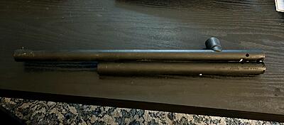

    Hello,
    I have an old PMI LB I’d like to build.
    Needs trigger frame, valve assembly, striker and spring, bolt (Speed Demon or CooperT), etc.
    Anybody still carrying these kinds of parts?

    If I could find an AGD Turbo Valve, that’d be great.

            Brain fart.
            After taking a closer look, this was originally a front 12 gram marker. Essentially a long barrel PMI 1 direct feed.
            i suppose I could convert it to back bottle with side air transfer block, but I’m not set up to machine flats on the receiver.
            So….im going to build it back to original, and try to add an L stock and walnut grips.
            That being said, I think I need-
            front knurled cap/12 gram retention assembly,
            striker, striker spring,
            back retaining cap (with velocity adjuster grub screw)
            valve body, valve spring, valve core/seal
            valve assembly retaining nut
            trigger frame assembly (with sear, etc)
            Delrin/acetal pump, and pump arm
            Speed Demon or CooperT bolt
            I’ll also reach out to other sources you folks have helped me with. THANKS!!

                You could message doc for the extended rod for PMI I length 12 gram plunger
