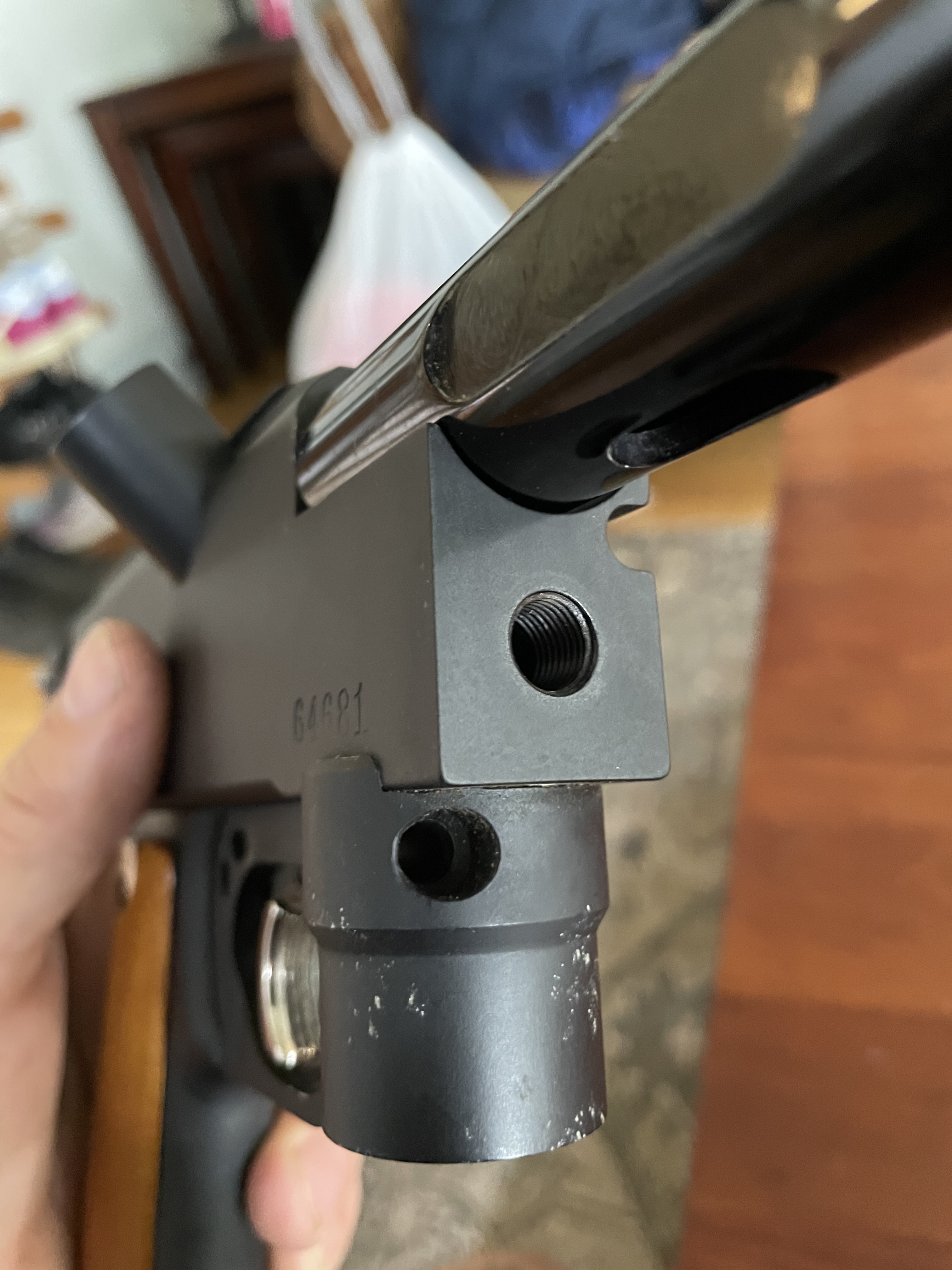

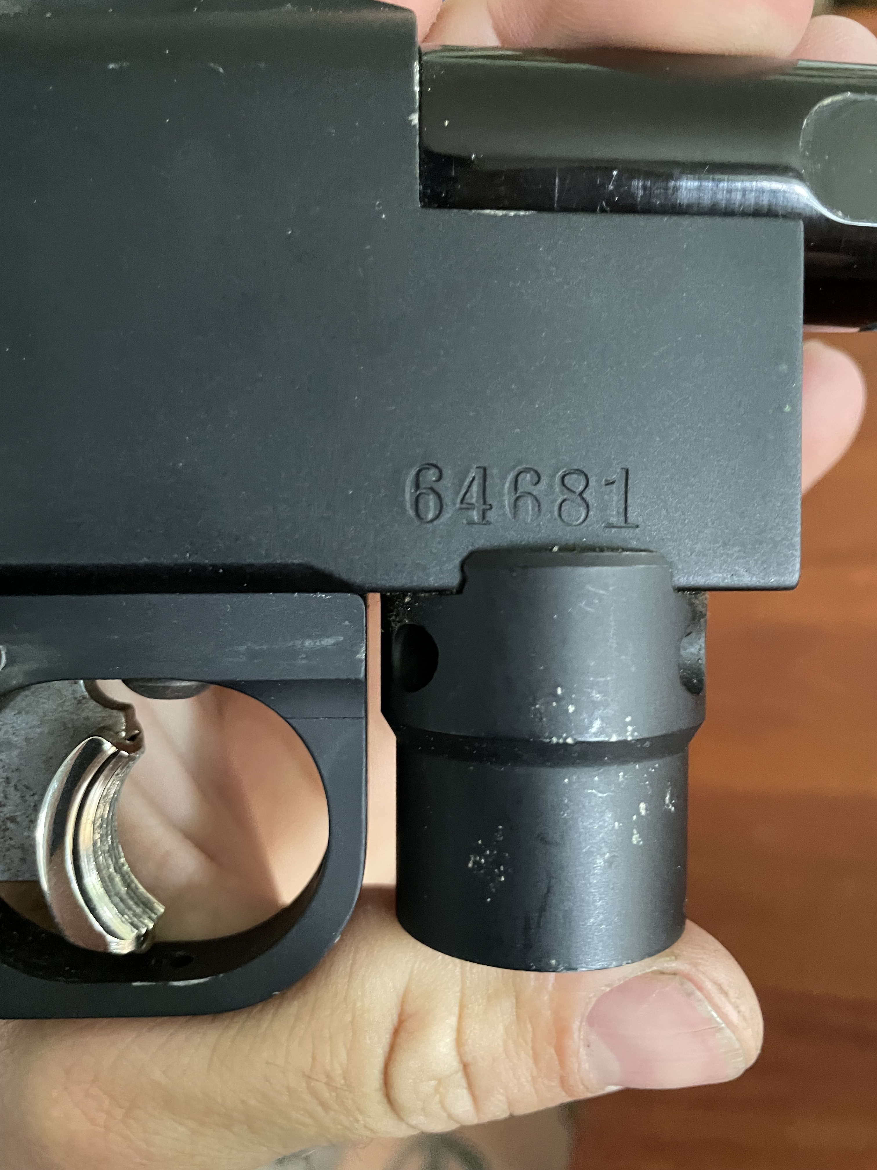

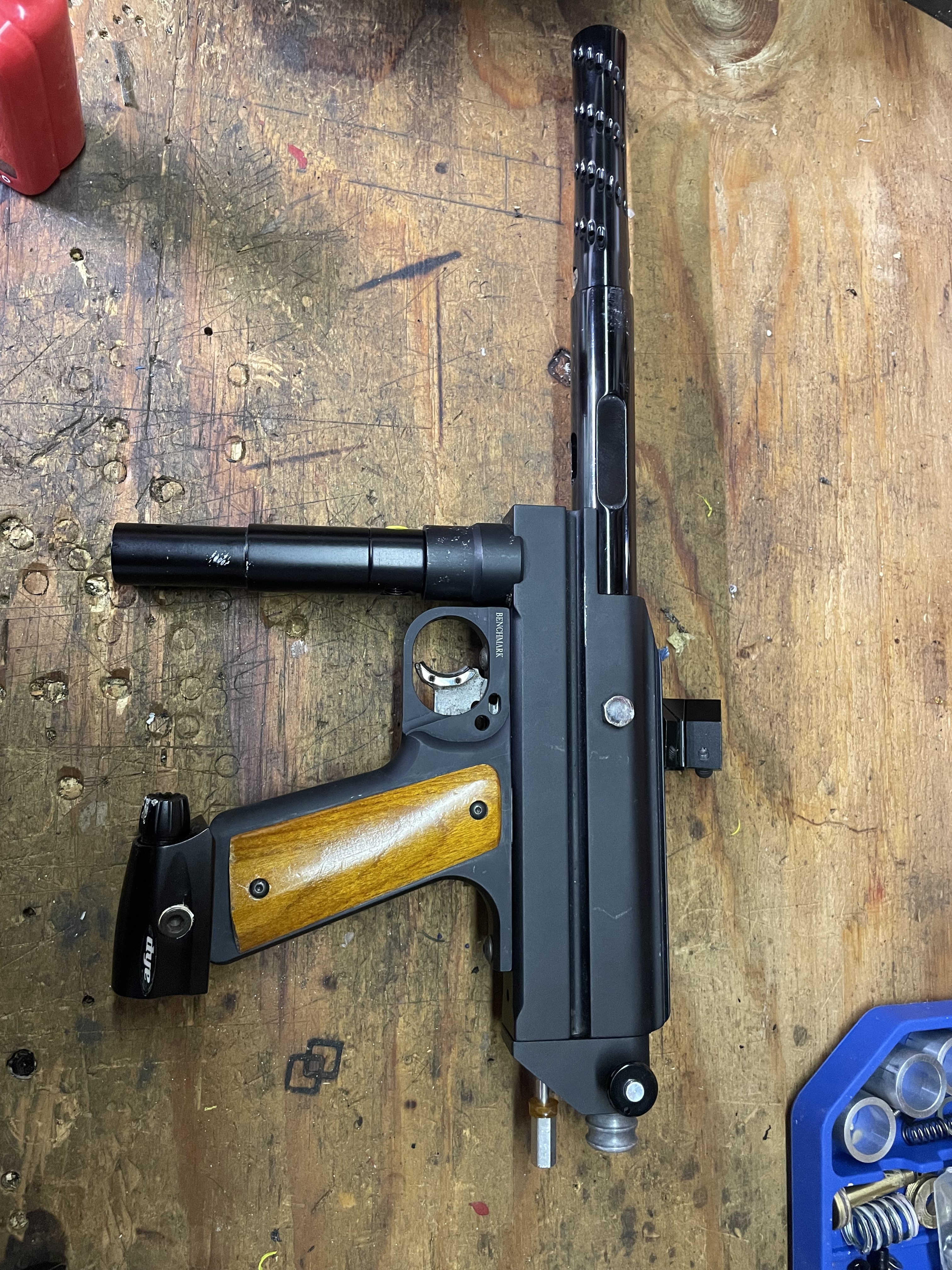

    Looking for a pump kit for my open class sniper build. Suggestions ideas welcome 🤌🤌 IMG_1166.jpg

    You're limited to pre2k. Older WGP simple kits are out there with pre2k guide rod. Inception makes a pre2k main guide for their kits. Autococker Parts v3 Slice kit comes in a pre2k option.

        I vote ccm kit. But any pre2k kit should work

          I have a Inception Genesis kit with their 2k guide rod on my pre-2k, I like it as a somewhat cheaper option. Smooth and easy pump.
          But I may also suggest a ccm kit if you can get that pre-2k guide rod. As I also am a sucker for the ccm smoothness.

              Drill and tap it to 2k spec and throw a $50 Genesis kit on it.
              or for another 40 bucks, you could just buy a pre 2k guide rod.
