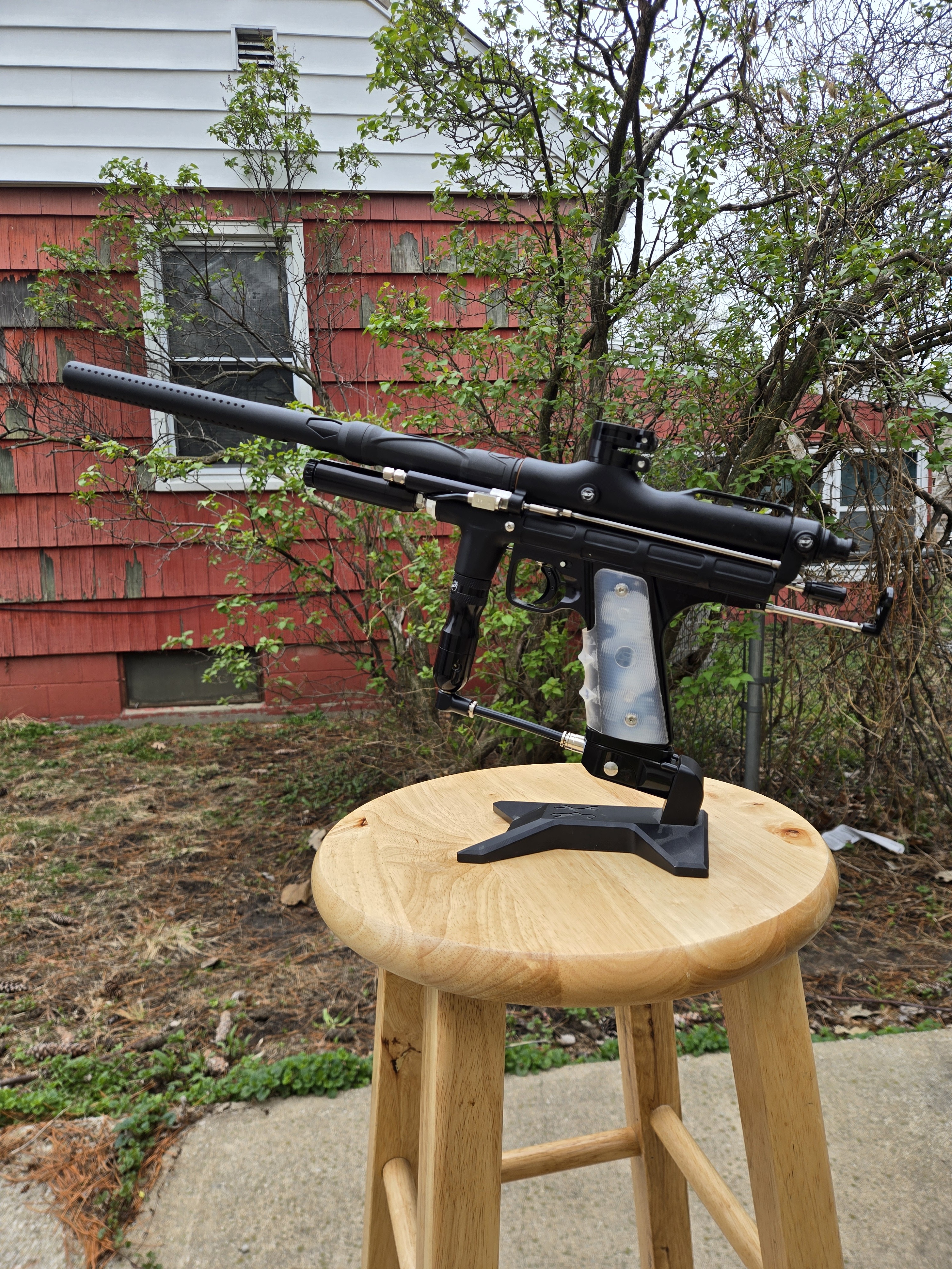

  • Buff_phroggie
    Trilogy King?
    • May 2025
    • 348
    • Central Iowa
    I can help you with this build, as I have done something simmilar. I have a trilogy that has been minied and I dont like it as much as the stock ones I have. 100% get the feedneck modded or if you have a threaded feedneck version they are STO threads. Here is the exact build list of the one pictured.
    Feedneck mod (i dont remember if this is the ID or the MS feedneck on this one)
    Big pp Mod (with big pp lazerus valve body)
    JC hammer
    cockring/ big pp bolt
    lpr adapter nut
    TechT light back block
    TechT adjustable 3way rod.
    ST hpr, lpr, and ram
    GF frame
    Attktx ZFR trigger plate
    Attktx lpr kit (for the ST lpr)
    all the Attktx titanium parts (the pump arm was a bitch to cut and rethread myself)
    CCM 90⁰ fitting
    Last but not least the ID asa.
    I do need a new trigger shoe as it fell off, but will still melt faces with ½ a trigger
